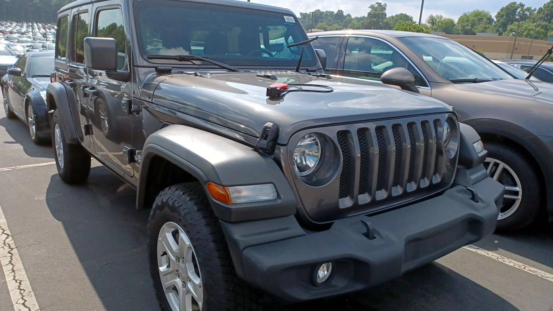

i have a catch can i installed when i first got my used 12k mile jl ,i change the oil every 3000 miles is it safe to use seafoam ? i used to use it in my 88 cherokee but seem like a read seafoam could damage seals in the jl 2021
