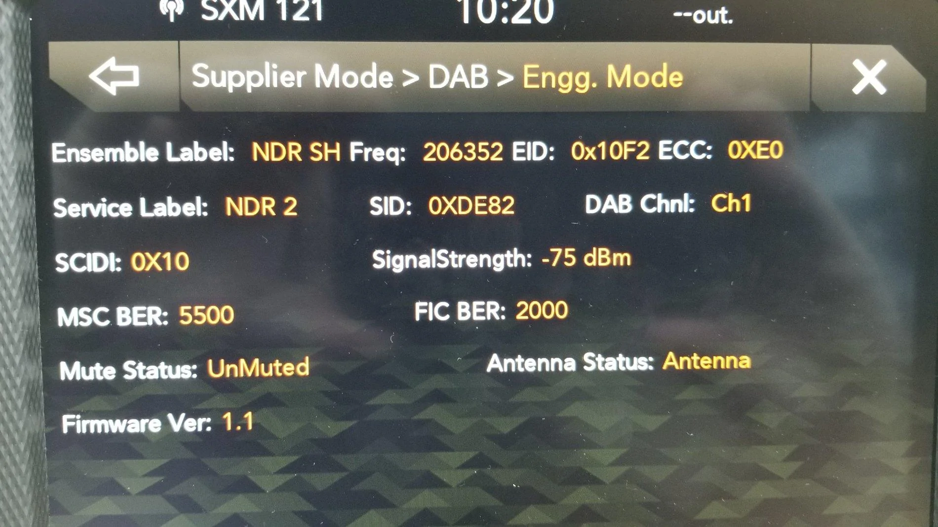

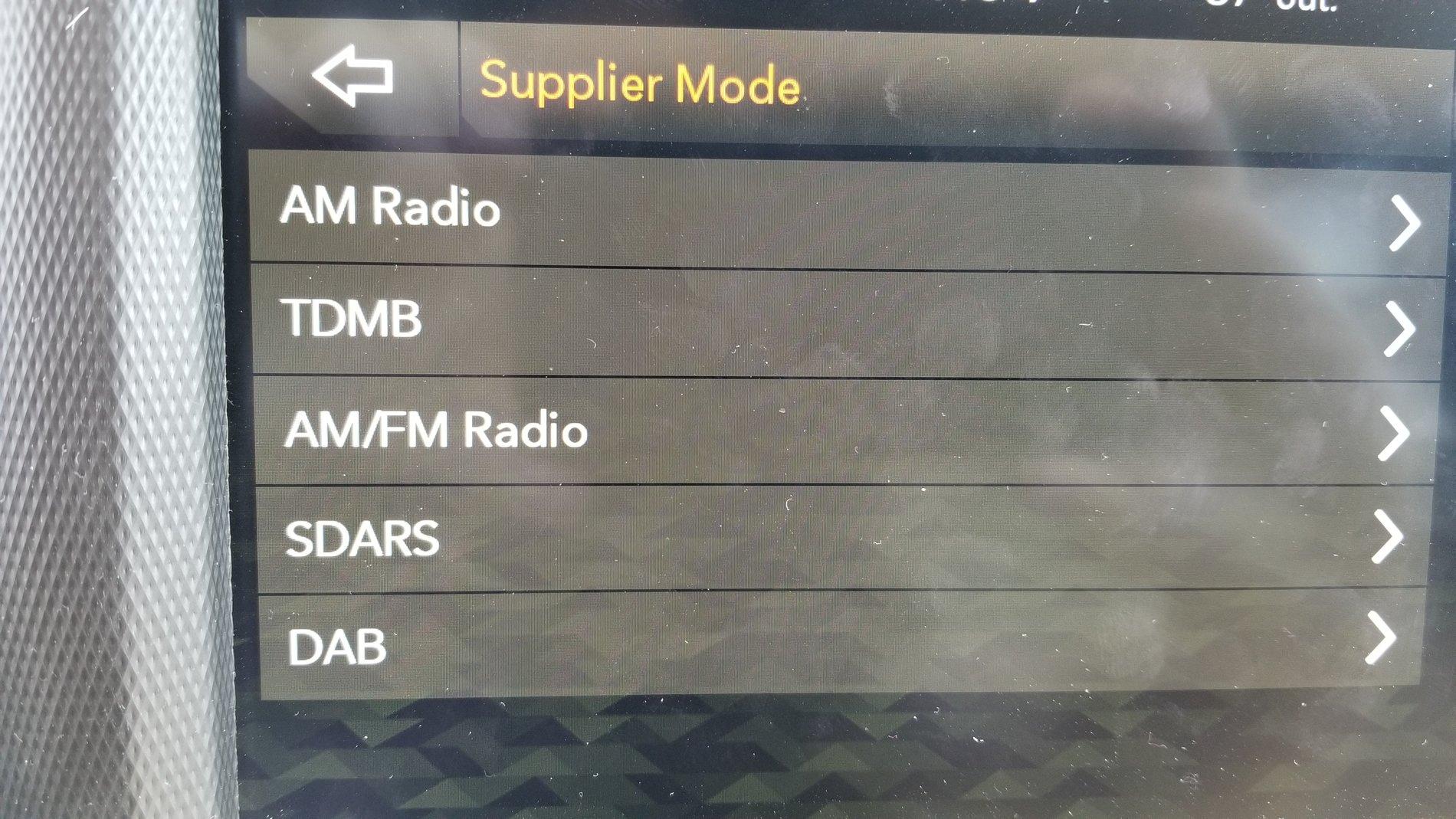

There are several hidden menu's you can look at. I found a display that was in the engineering mode that shows how much signal I was getting
from each xm station. Most are viewed by pressing and holding the driver side hot and cold button and the front defrost button.
You don't want to made any setting changes, its very complex!
But an example I had -75DBM sitting still in a parking lot, on an xm station ,very overcast and rain at about 900 feet above sea level. You can compare your settings to another JL same as yours.
There is a factory reset that can be done also.

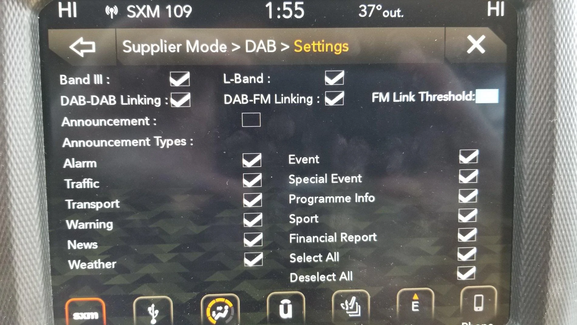

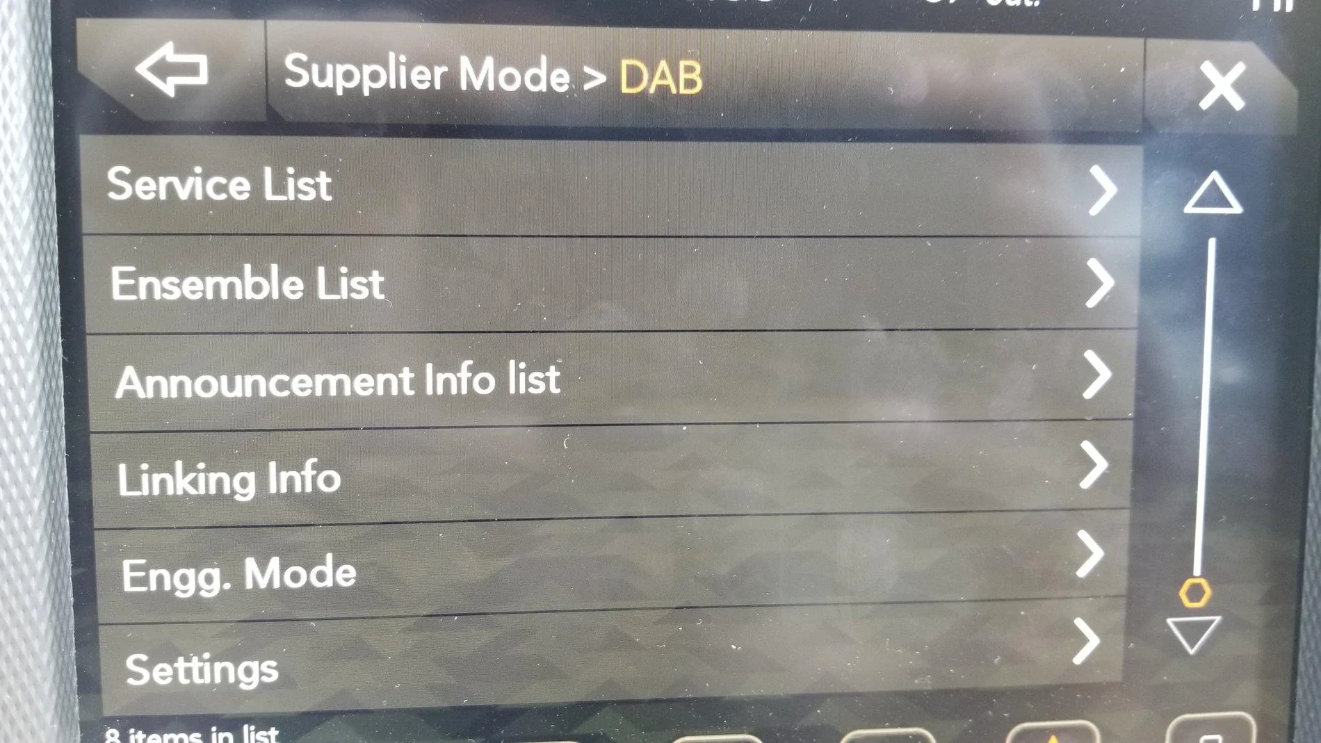

Ask the dealer about exploring some of these options, I have even seen a radio diagnostic screen on one of these deep sub menu's Under Signal strength says -75dbm
There are many screens I was able to get into for radio parameters, but it had alot of information that
in the wrong hands could mess with my radio. lol
Also found some good screens for the radio brightness with headlights on or off. Mine seem rather dim.
Will play with those setting!

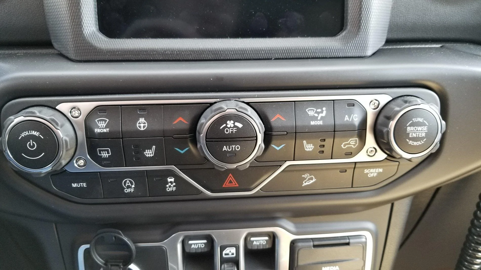

tried the defrost trick and only had dealer menu. No supplier mode.

You need hot and cold and enter button all held in. Enter is round knob on right

That worked. Getting -75 dBm in the garage with the door closed. Will have to check it out on a drive and see what it is.

There was alot of stuff to look at like type of antenna detected. Muting levels.
Good stuff . Have fun exploring!
