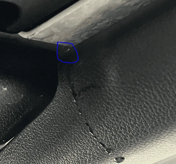

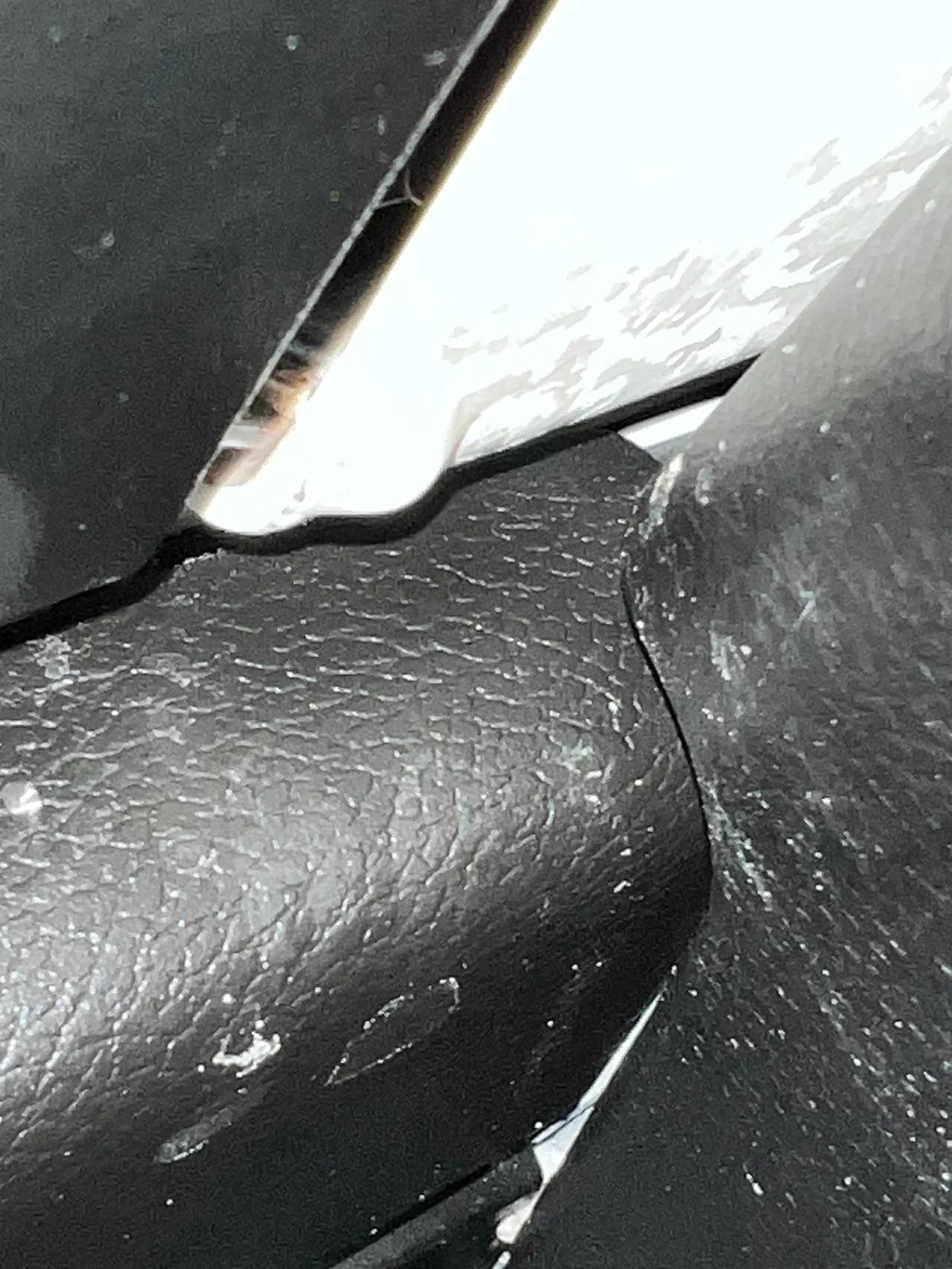

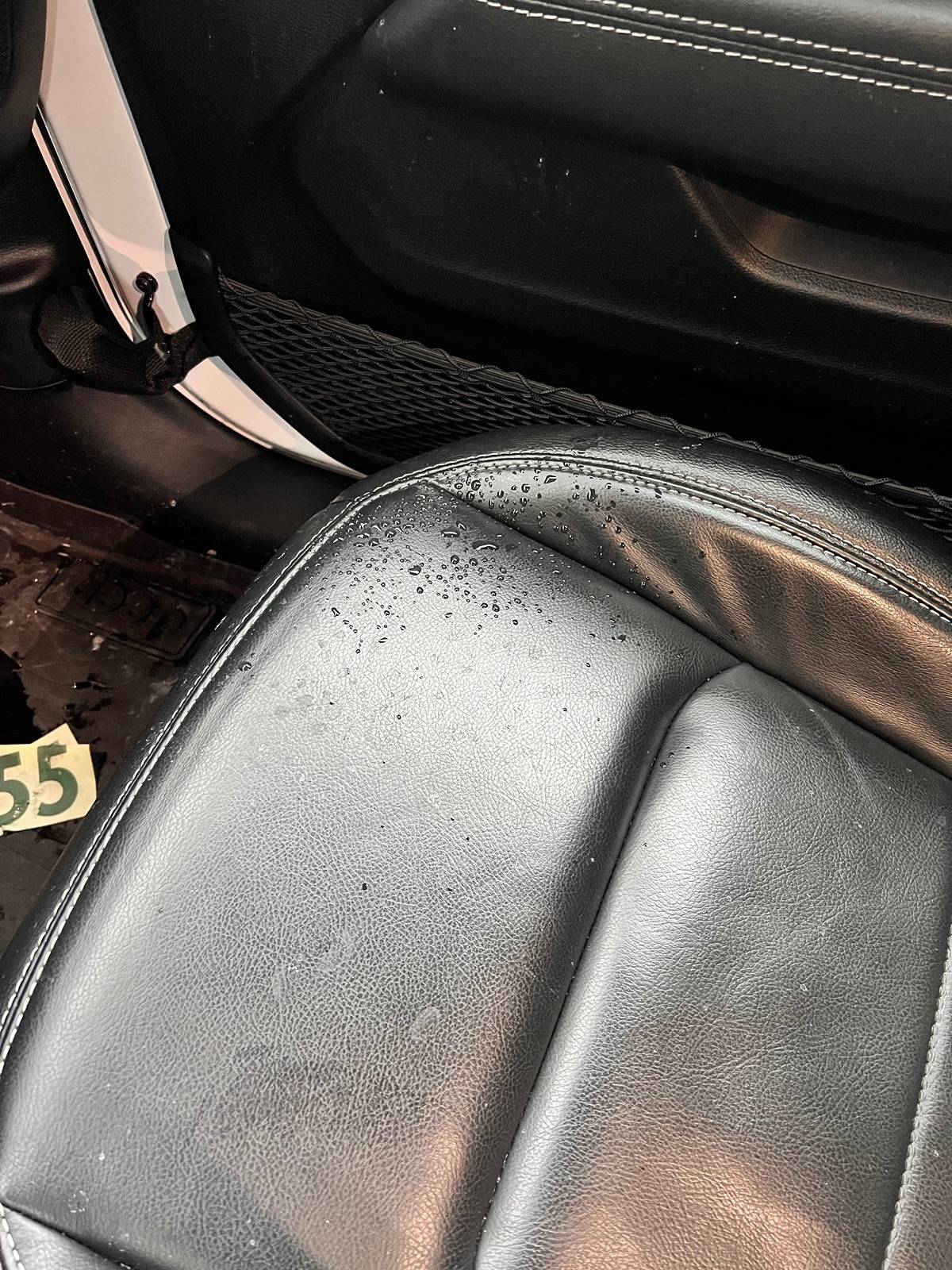

New Sahara been to dealer 9 times and they can’t figure out how to fix leak. They’ve stretched, sealed every possible area. Don’t know what to do except get a lawyer. Have case # already. Suggestions? Pics attached

Suggestions?
Have the dealer swap the freedom panel from another vehicle and see what happens.
Could also be a bad, improperly installed door seal. I had a similar leak and that was the issue. Dealer's leak specialist replaced the seal.

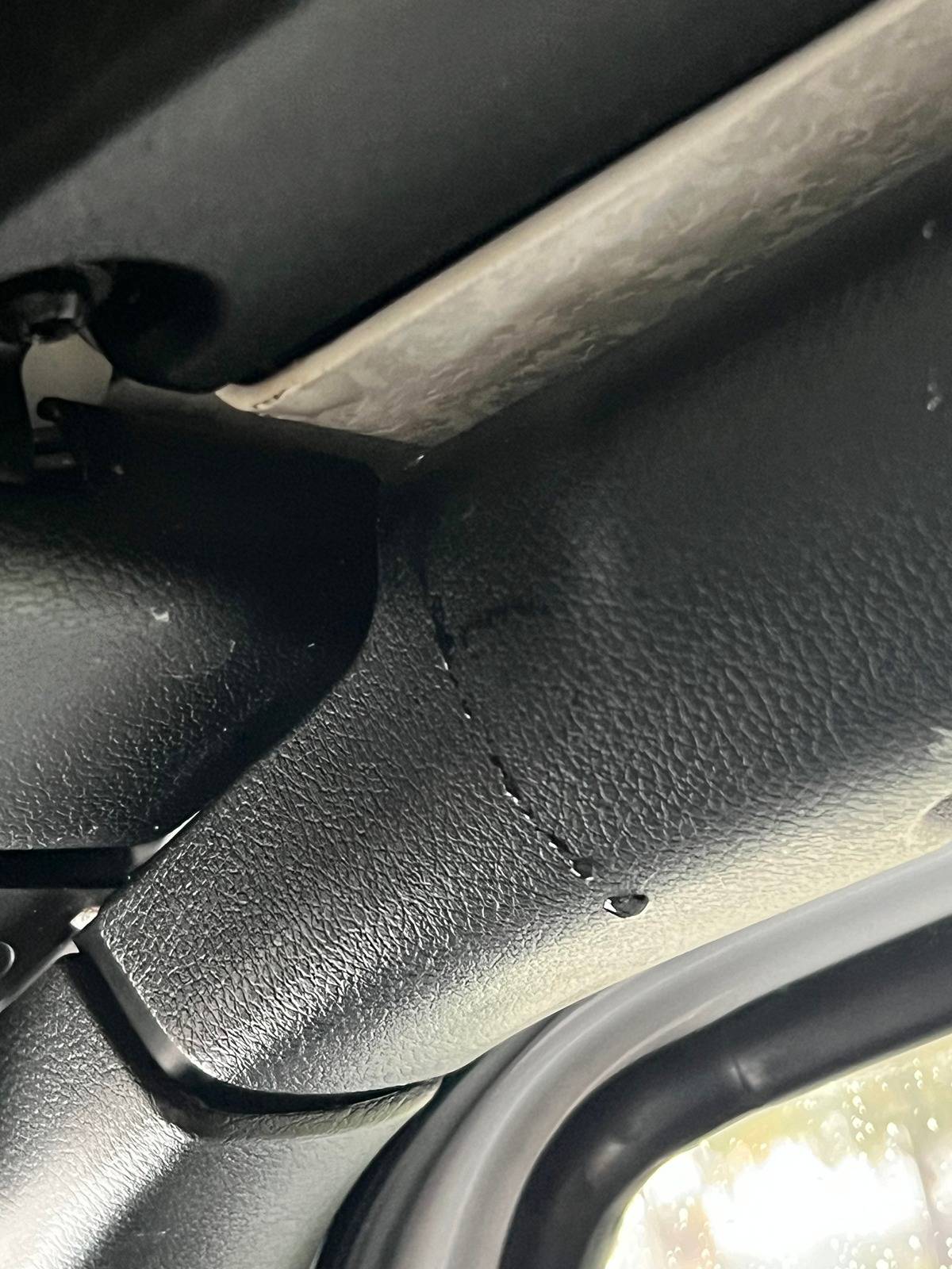

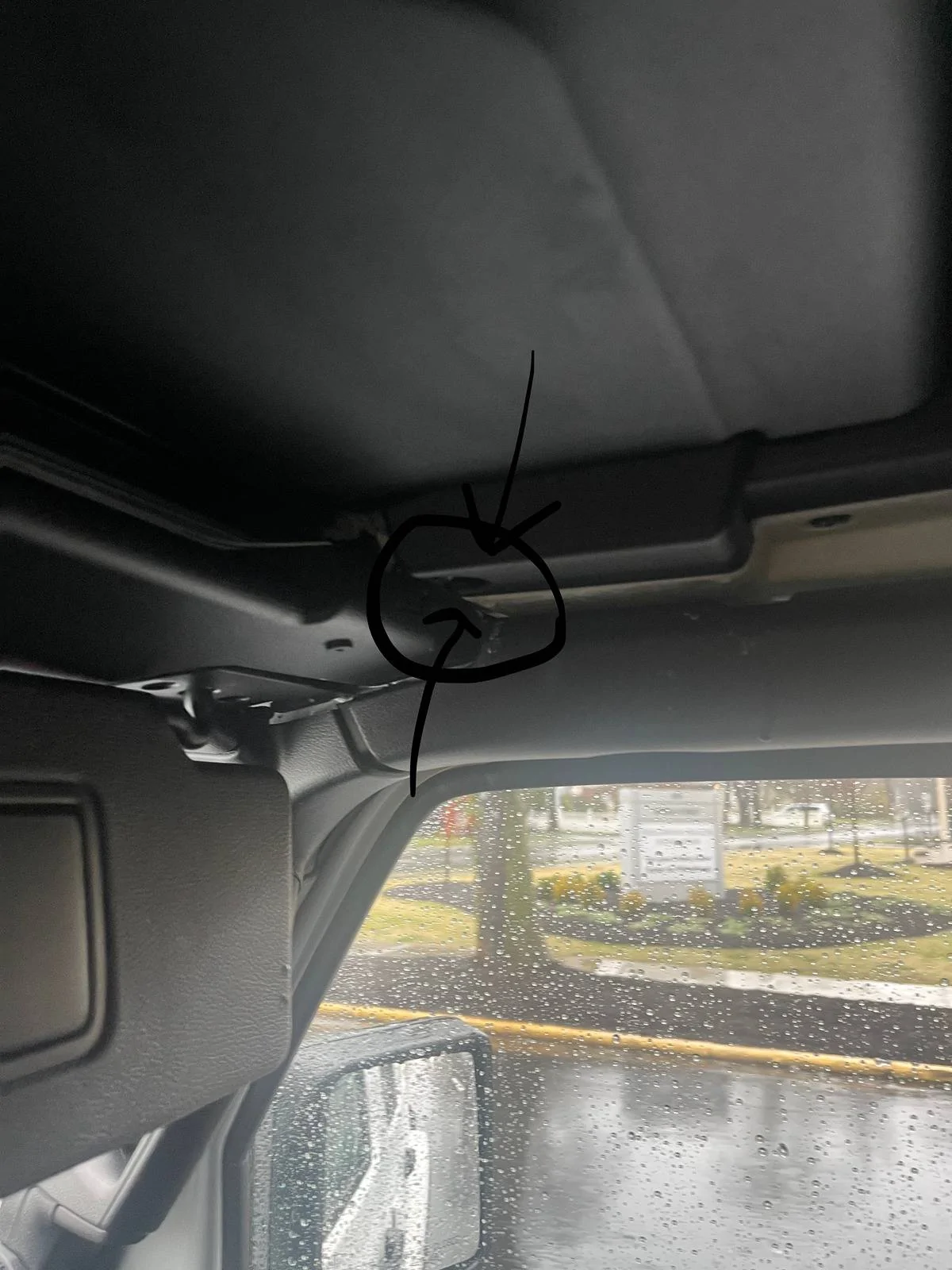

Appreciate everyones input, but according to their "specialist" they've siliconed every part of that area, stretched the SOT roof, siliconed area when roof is opened, door & roof strip. They are stumped so they say.
Jeep Wrangler JL Sahara leaking too right passenger side IMG_1283
Jeep Wrangler JL Sahara leaking too right passenger side IMG_5172 2
Jeep Wrangler JL Sahara leaking too right passenger side IMG_1284
Ah, you never actually mentioned until now that you had an SOT roof. I failed to realize that when you said they stretched the roof.
At this point have them order you a new roof. They can be changed rather easily. It is a handful of bolts on each side.
