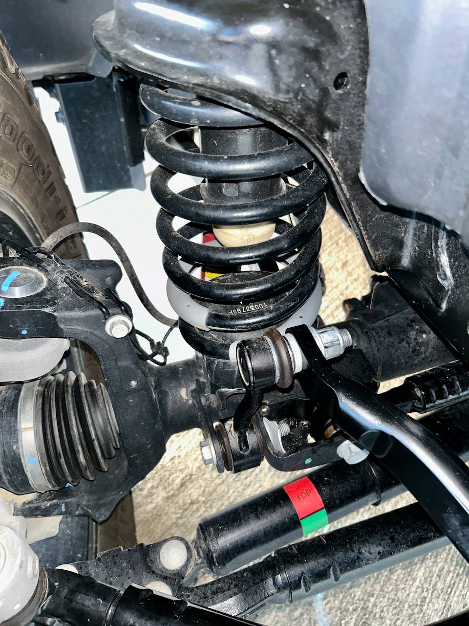

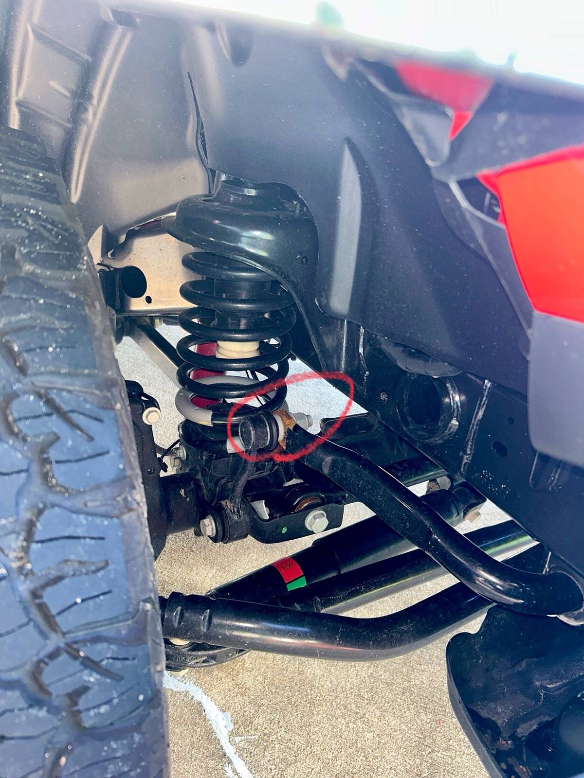

I have a 24 Rubi with 3200 miles on it. Picked it up Jan 18th. I’m noticing (what appears to me to be) significant rust on the passenger side sway bar linkage. I’ve only been wheeling a few times where the sway bar was disconnected. I obviously only used the Rubi’s built in disconnect; I did not manually disconnect the bar. Driver side shows much less (but some) rust. See pix.
Seems to me I need to disassemble this and wire brush/paint that joint. True? What are the proper disassembly steps to get at that piece? (I don’t believe it is under load just sitting in my driveway - true?)
Been considering a fluid film treatment (or similar) and this seems to make that more necessary even though I’m in NC and not the rust belt.

If you bought this off the lot, that should be warranty thing… if you want to address it yourself, all you need to do is take the bolt out and fold the end link down…..

It’s not under load on a flat surface. There’s 100’s of videos on the you tube on how to remove end links from sway bars. Just undo the nut, clean it up with a wire brush, clean the rust dust off with isopropyl alcohol and spray paint it with Rust-Oleum satin black. Easy.

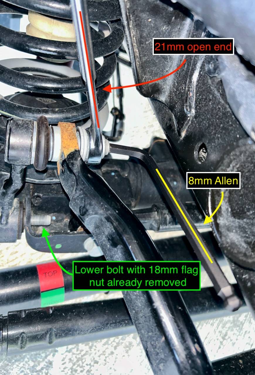

I repaired it myself today. Easy once I collected the right tools.
The lower bolt with flag nut is simple with an 18mm socket on the bolt head.
The top bolt is now larger in MY 24. The only way to remove it is by using a 21mm open end wrench with a 8mm Allen wrench to keep the bolt from spinning. See pix. BTW the passenger side is easier than the driver's side...my 8mm Allen wrench would not fit into the bolt on the driver's side...may have to cut the L piece of the Allen wrench shorter.

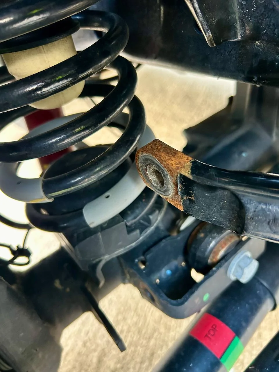

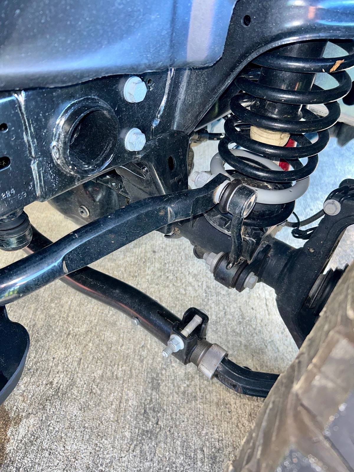

I removed the sway bar linkage and then scrubbed off the rust from the end of the sway bar before hitting it with Rustoleum. Not counting paint drying times, this was ~30 min disassembly/repair and ~15 minutes reassembly. The hardest part was figuring out the Allen wrench size since it clearly wasn't 6mm as in previous years. 21mm open ends are long wrenches so you can only get about a quarter turn before repositioning the wrench.
Jeep Wrangler JL Rust on sway bar linkage Disassembly wrenches
Jeep Wrangler JL Rust on sway bar linkage Rusty sway bar end
Jeep Wrangler JL Rust on sway bar linkage Reassembled
