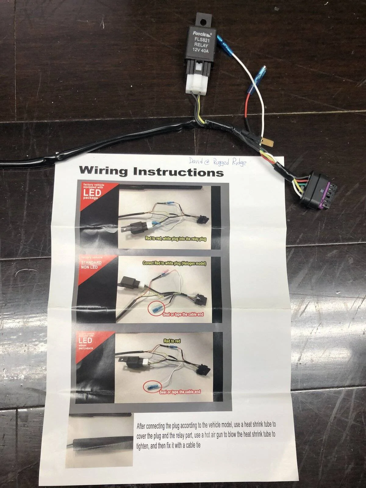

I recently completed the Rugged Ridge Fender Chop with DRLs on a 2020 Rubicon that does not have the LED option from factory. I have seen this mod accomplished on several YouTube channels and it seemed straight forward, plug in the harness and your done. The harness received in my kit has an inline relay for each DRL with instruction to connect a certain way depending on the Vehicles configuration, Factory LED, Standard Non-LED, and LED without Switchback. As previously stated my Vehicle is a Non-LED Rubicon so I connected per the instructions , the DRL's do not illuminate when the vehicle is on unless the Light Control switch is in an ON position. I called Rugged Ridge and after 3 weeks of getting the run around a tech told me today that I need to flash the ECU to activate the LED DRL? That makes no sense since the DRL feature worked fine prior to the mod and they have a specific connection for Non-LED Vehicles.
1) Has anyone installed the Rugged Ridge DRLs with the Rely in the harness and is having this issue?
2) Does anyone know what connection will bypass the relay?
Any input would be greatly appreciated, I have attached a picture of the Harness and the Rugged Ridge termination sheet for reference.

Hello Felipe, sorry for the delay in responding. I actually got the DRL's to work but I had to use the OBD JSCAN app and a blue tooth OBD transmitter to activate the LED DRL Fnction, which is not how the lights are advertised. Anyways, I actually activated the Amber portion LEDs which look good as a DRL and it is different from most. When the lights are on the DRLs light up white as they should. I didn't change any wiring which I thought was strange but somehow it works. Good Luck!

I have a sport non led. I changed the settings in Jscan to LED, set up the wiring using the top wiring diagram, and everything works. I noticed the relay is huge and noisy, so I decided to see if it would work without the relay. Everything functions fine. I wish someone could tell me if it is ok to remove the relay out of the picture, as it is giant and noisy. If I am correct, the relay is just a simple on off switch for controlling the turn signal, which the jeep is managing to do without the provided relay. Any insight would be appreciated.

I removed the relay for the same reason, no issues. I have been running like this for two years now.

Did you end you just disconnecting the relay from the harness? Did you need to do anything with the wires in the relay plug attached to the harness?
I just wired mine up (JLR LEDs) and I can only get amber DRL if I use my tazer to set DRL to turn. Also those relays are super loud, would t mind deleting them myself. I used some thick shrink wrap and spent way too much time installing these so not super excite to tear it all open again.

Whelp I confirmed it does work the same w/o the relay but I still cannot get the white light to work as DRL. I tried disabling LED and tried the other wiring options, not sure if it’s a factory LED thing or what… sad. I’ll try calling them tomorrow as see where I get.
