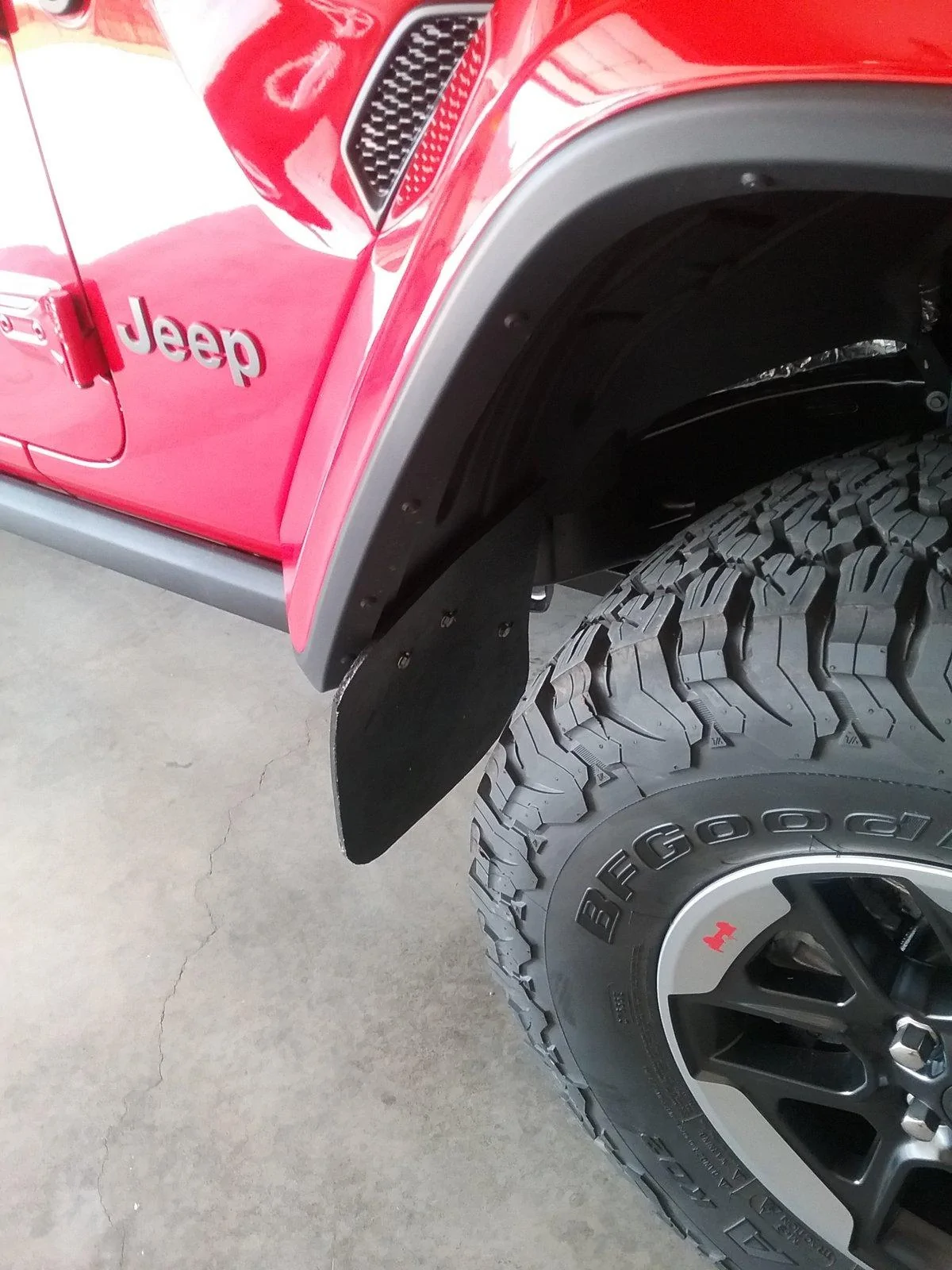

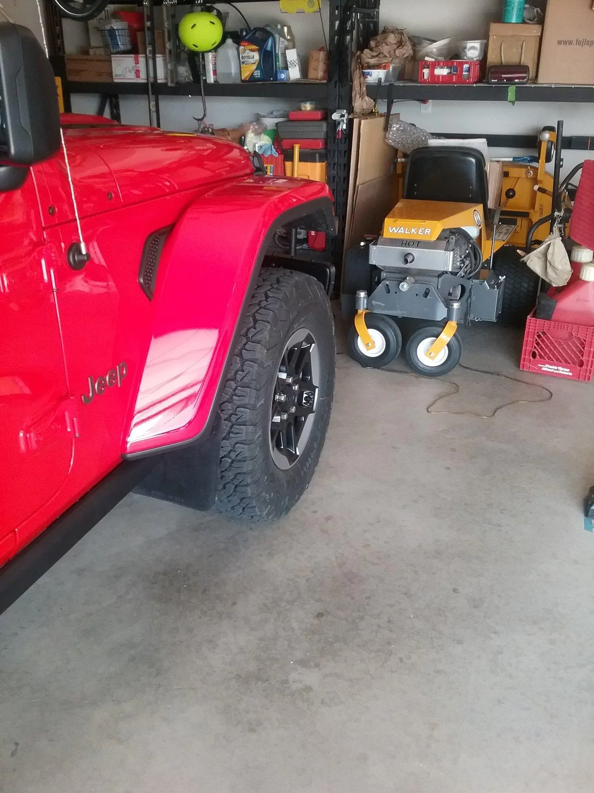

Made my own out of 1/4" thick 12" wide mud flaps from NAPA, they are about 12" from the ground on a stock Rubicon suspension, just barely cover the tire width. No modifications to the Jeep, so I could remove them and return back to stock.

@mazeppa Nice work, I'm thinking of doing similar. I can't quite tell how did you fasten these to the jeep? What kind of hardware is that and did you remove rivets or factory fasteners that were in place? Thanks!

I like that, how did you mount them?
The inner liner has two tabs that I pulled out that had a heavy plastic bracket at the very bottom of the liner. I ran two bolts through it and the rubber mud flap. I also ran two screws at the top of the mud flap and through the liner. It worked out perfect.
