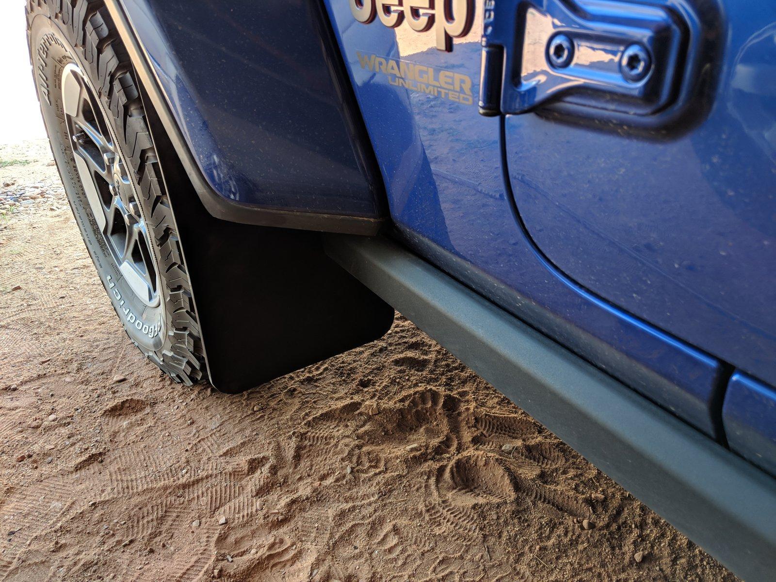

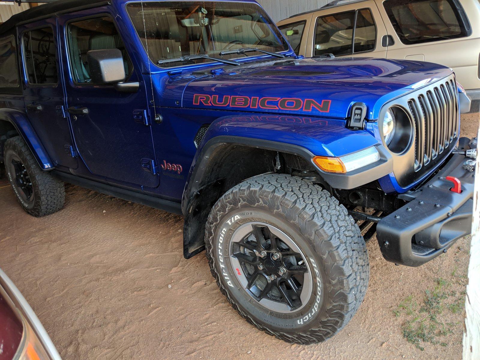

My JLUR Mud(Rock) Flaps
Can you take a couple more shots from different angles, such as the side and behind? Please measure how far down yours hang from the bottom of the rock rail. These things should reduce the rocks blasting the hinges by a pretty good sum.

Two bolts, one each side I went through a plastic support bracket and two, one each side went through the plastic caps for the Rubicon sliders. I didn't trim the splash guards at all.
Bolts, not rivets, right? Thanks for the help!

Indiana
Bolts. I didn't trust rivets. These splash guards are thick and fairly heavy.
They look fantastic and look like they give lots of protection. I don't mind them sticking down a bit, too. They do on my JK, and it hasn't caused any issue off road. I really think these will not only cut down on the KO2's stoning the Jeep, but also salt spray in the winter.

Indiana
My splash guards hang 6 1/4" below the sliders and 10 1/4" below the fender flares (where they meet fenders).

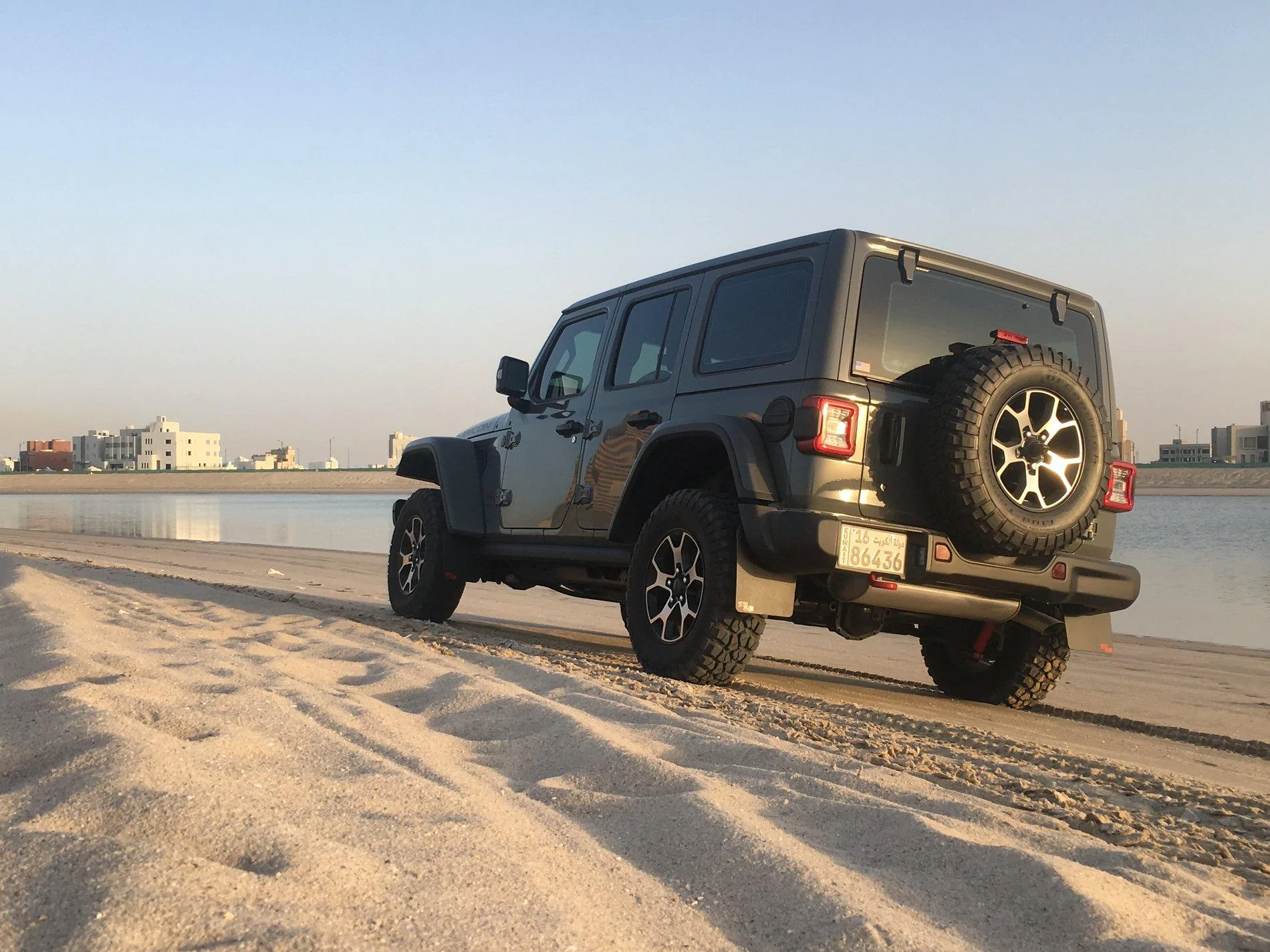

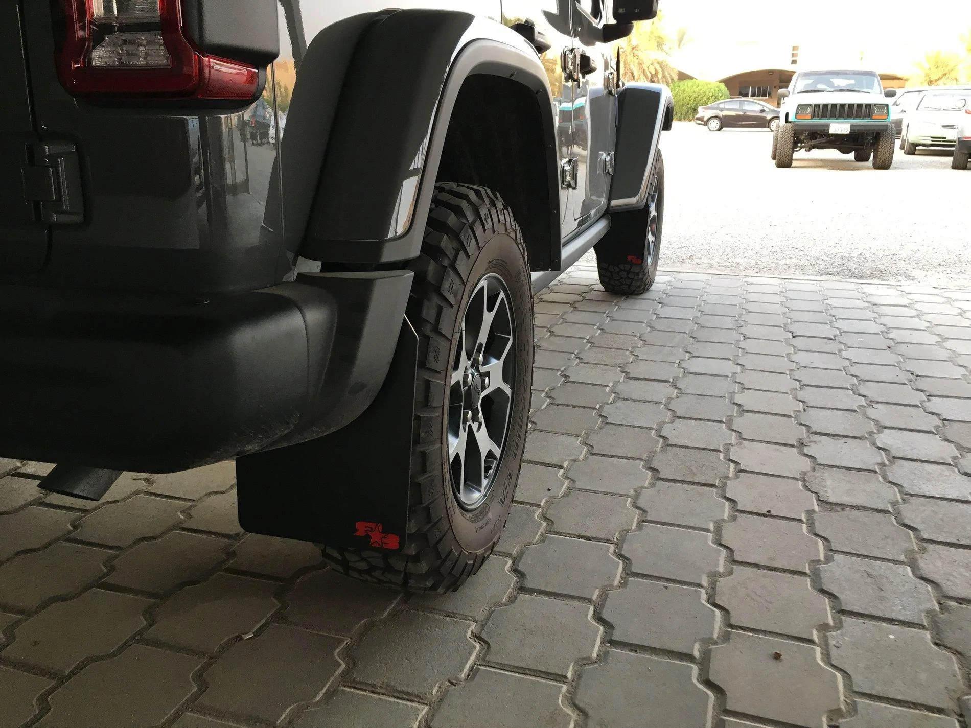

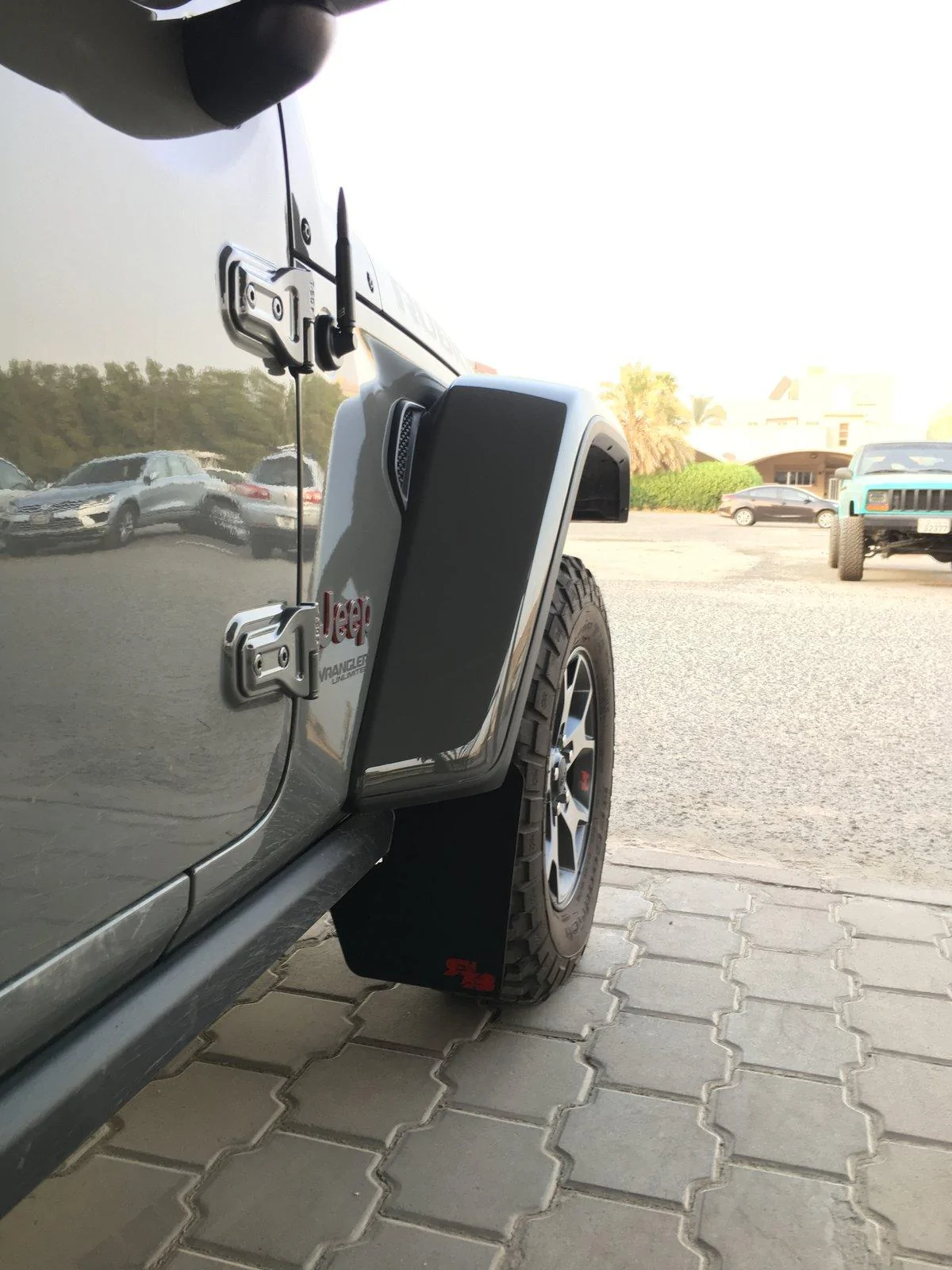

I Have the Rokblokz Quick-Release Mudflaps on my JLUR, easily installed and you can remove them without tools, they're held on in factory locations with thumbscrews.
They offer them in two different sizes: Normal & Large
Mine are the normal size, the larger ones are for those who got a lift and bigger tires.
Note: Don't mind the splashes on the jeep in the close ups, that was right after i installed them :)
Pictures Below!
