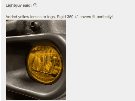

Yep.. Those are the ones for the factory fogs that LIghtguy posted about. I ordered a set but didn't realize that I actually have the Mopar Performance fogs that come with the steel bumper. Trying to figure out if they'll work on those fogs and the steel bumper. (I'm learning more about this Jeep stuff by the day... lol!)

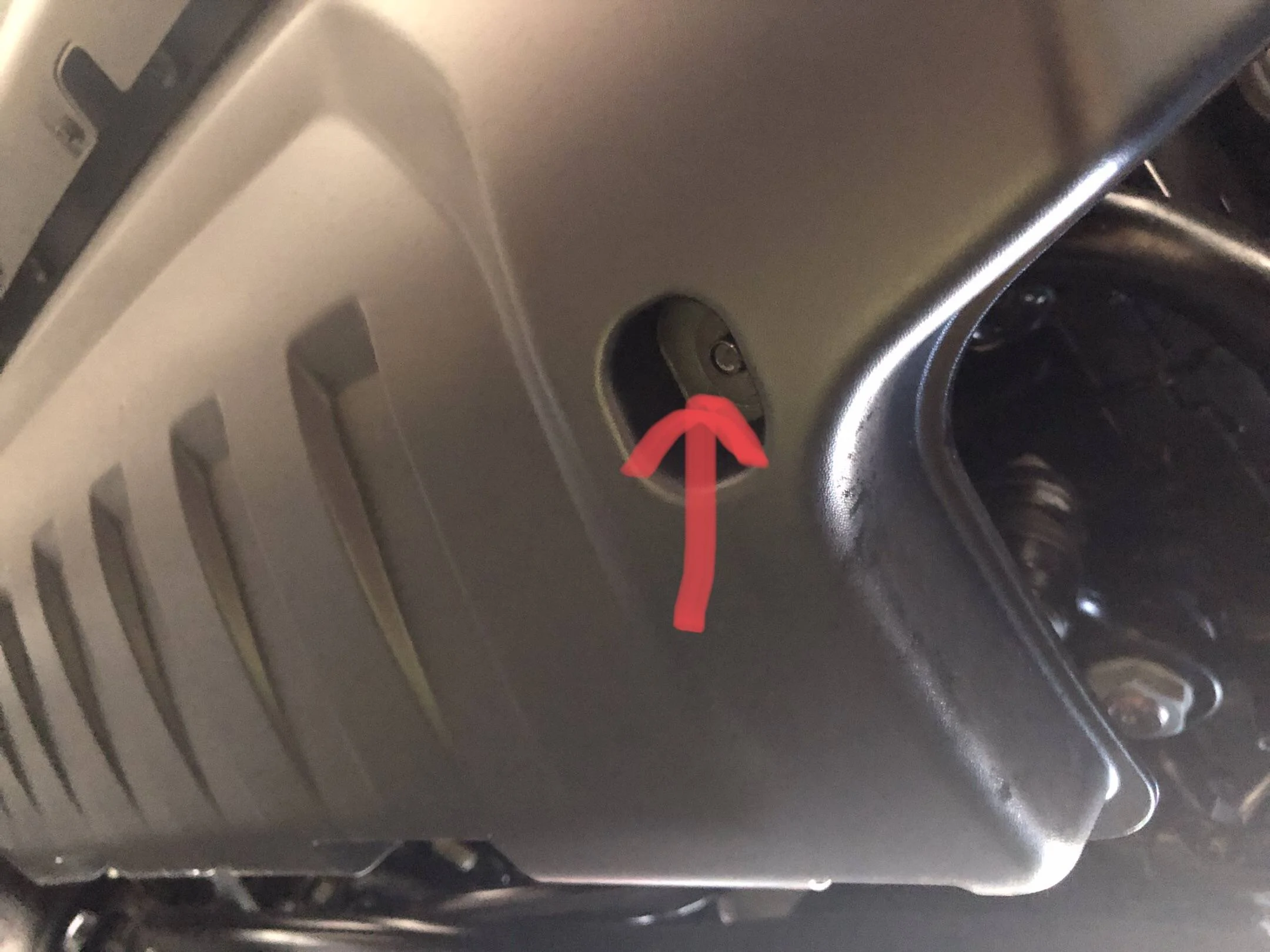

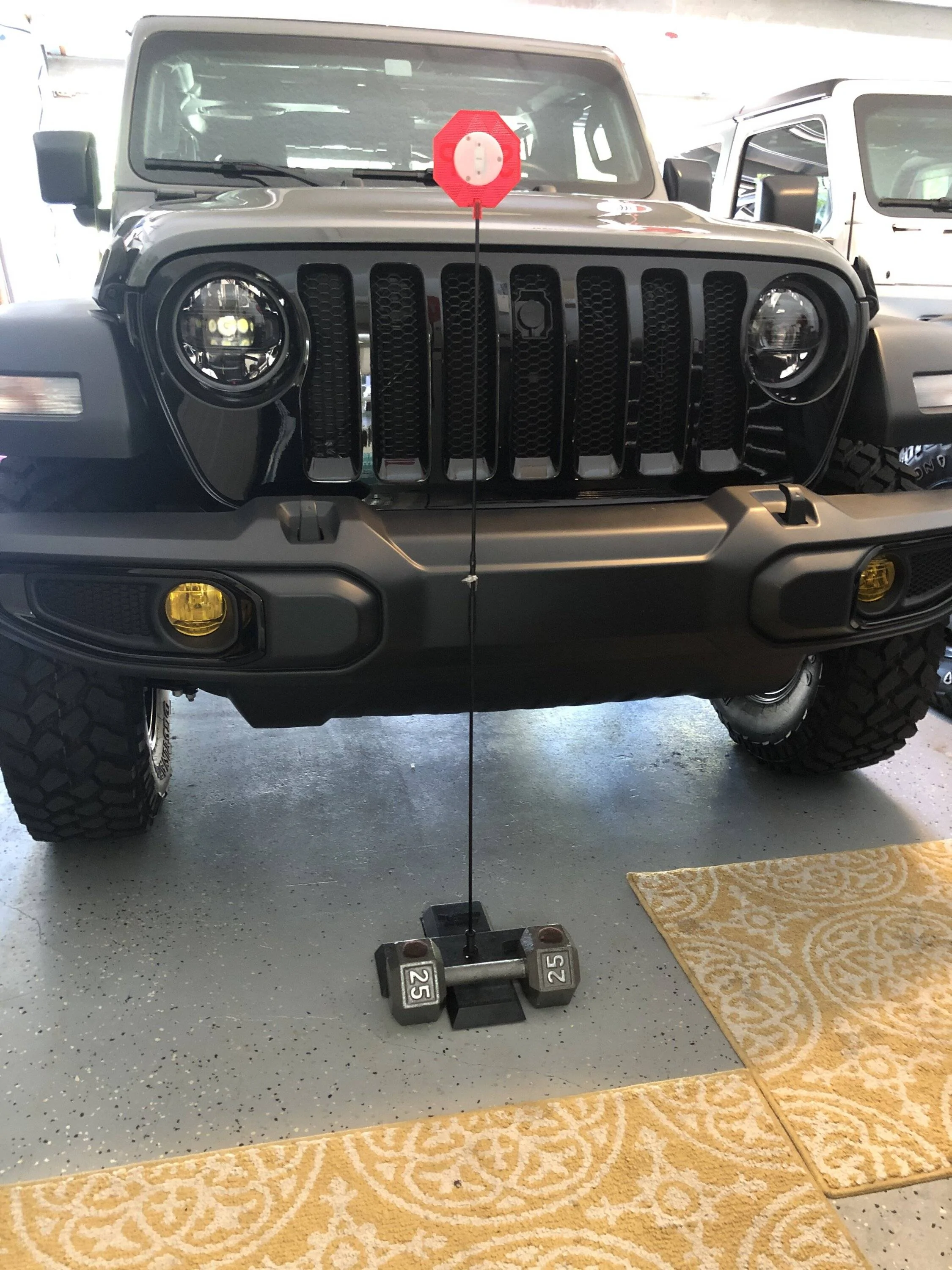

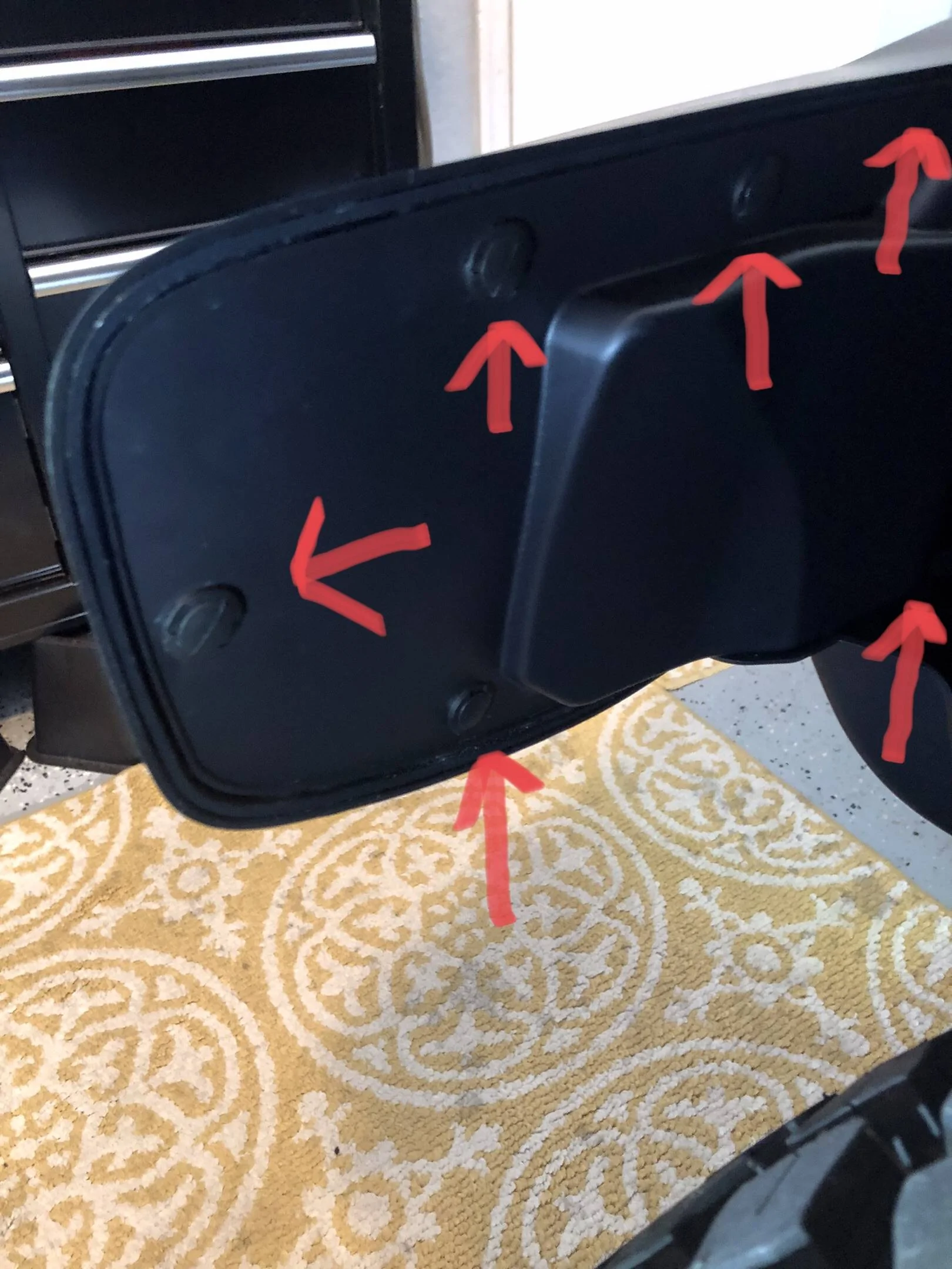

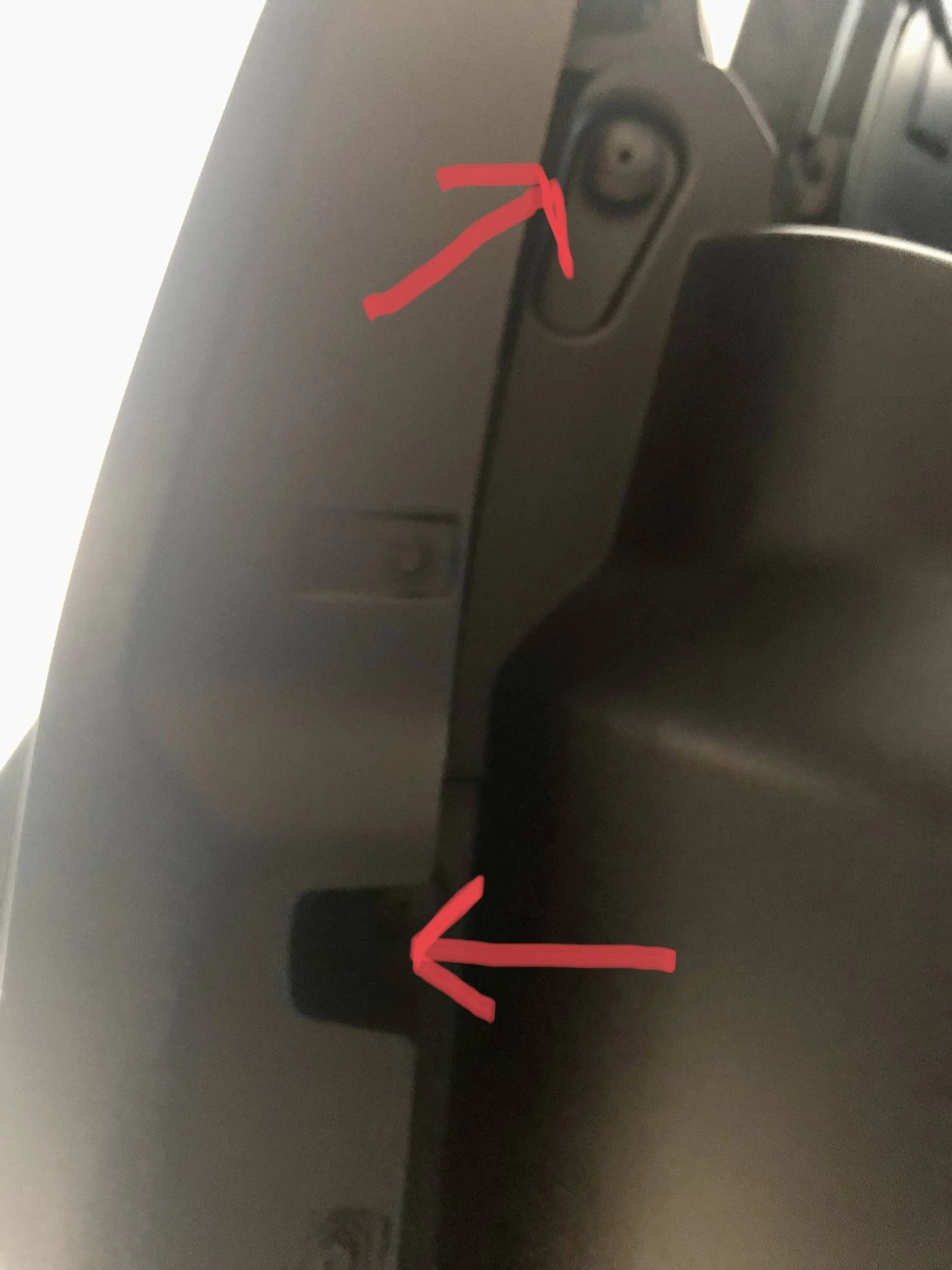

Ok, got these to work on OEM plastic bumper, and yes, once fog light removed, they snap right on. Started on drivers side, took about 20 minutes to figure out what needed removed and what needed just loosening. Some wiggling, a little bending, and a little pushing and pulling, and the plastic cover piece behind the fog light slid right out, exposing the fog light assembly to be unbolted and removed. The passenger side was much easier after I learned my process from drivers side, took less than 10 minutes. I removed 8 plastic push rivets and loosened 1 screw total. The screw needed loosening (or could be removed), in order to push down on that piece of plastic enough, because it has a plastic "finger" on it, that helps keep the piece you want to remove in line. Pushing down helps to disengage the "finger", so the other piece can slide right out. Unplug the light, remove 4 screws holding fog light in, snap cover on, and reassemble everything. Hardest part was wiggling/pushing/pulling the cover to remove, just took time and all of a sudden, it slid right out.

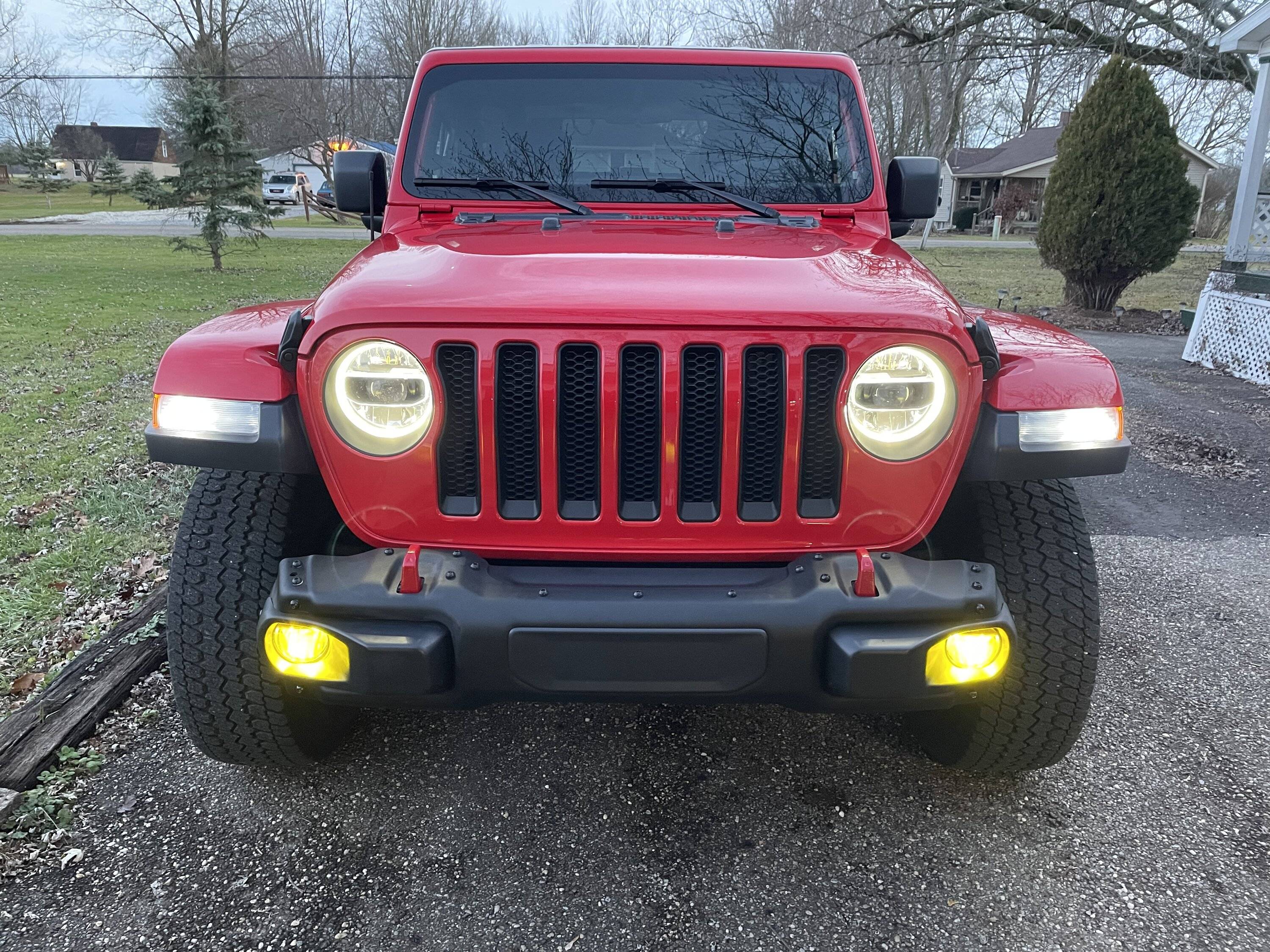

Excellent work on this!! Followed your instructions and worked out great! Thanks again!
