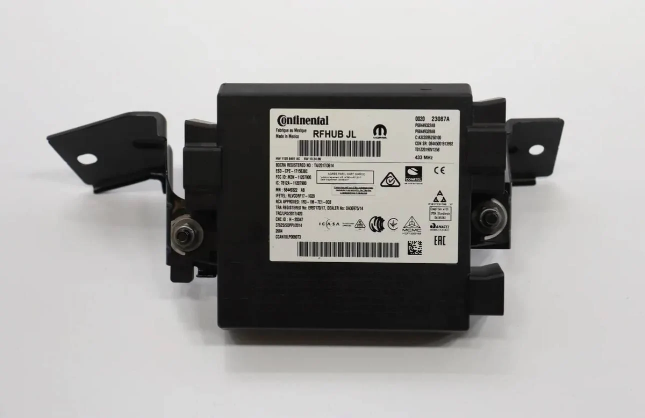

Does anyone happen to know where the RF hub for RKE is located? Dealership said mine is out and is charging $800 to replace this.
I understand the 1 hour for programming but that leaves $600 for the part and to replace.
Found the part from the Mopar factory new for $130 so that leaves $470 in labor which is insane to me.
I’ve heard conflicting locations so any help would be great.
Jeep Wrangler JL RF hub 68449322AB Location IMG_6780

Hello, ive been reading online it’s in the rear cargo inside trim next to the 12v cigarette socket
PoundedYams
Jan 18, 2022
Dallas, TX
2020 Jeep JL Unlimited Sport S 4 door
You are correct. It is on the drivers rear, just ahead of the fuel filler location. Verified by Service library. Hope this helps.
Eric
Thank you very much Eric, I found it at a local dealership for $130 and it’s just 2 10mm bolts so I’m going to save roughly $650 to fix it
