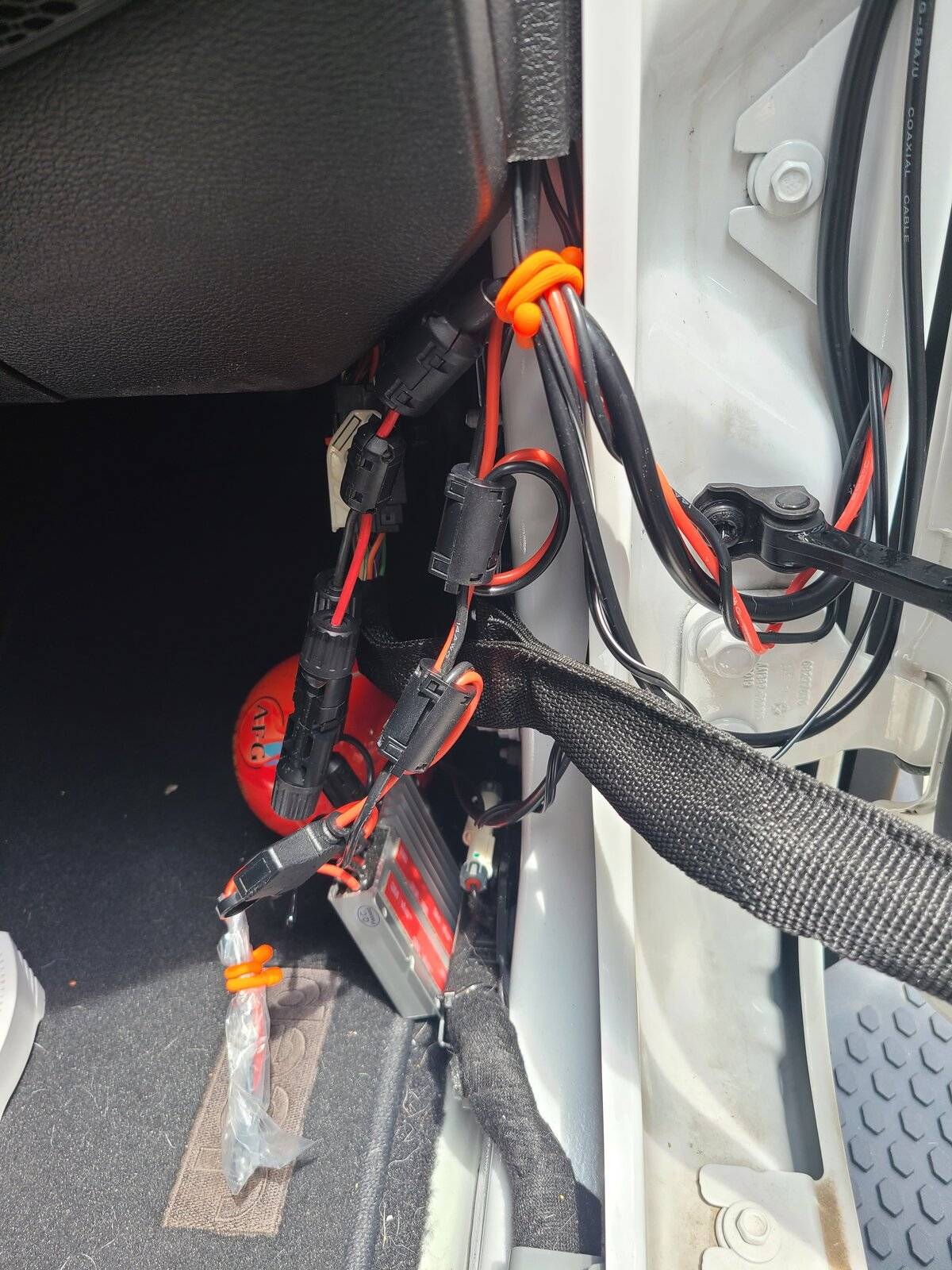

My wires are everywhere right now, as I haven't decided on final locations yet. I'm worried that some of those crazy loops and twists are exacerbating the problem:
Jeep Wrangler JL Cascadia solar controller whine/RF interference?  Snake oil works? 20210521_172148
I stuck all the loose ferrites I could muster onto the wiring going in and out of the solar controller, and it actually reduced the interference maybe 80%.

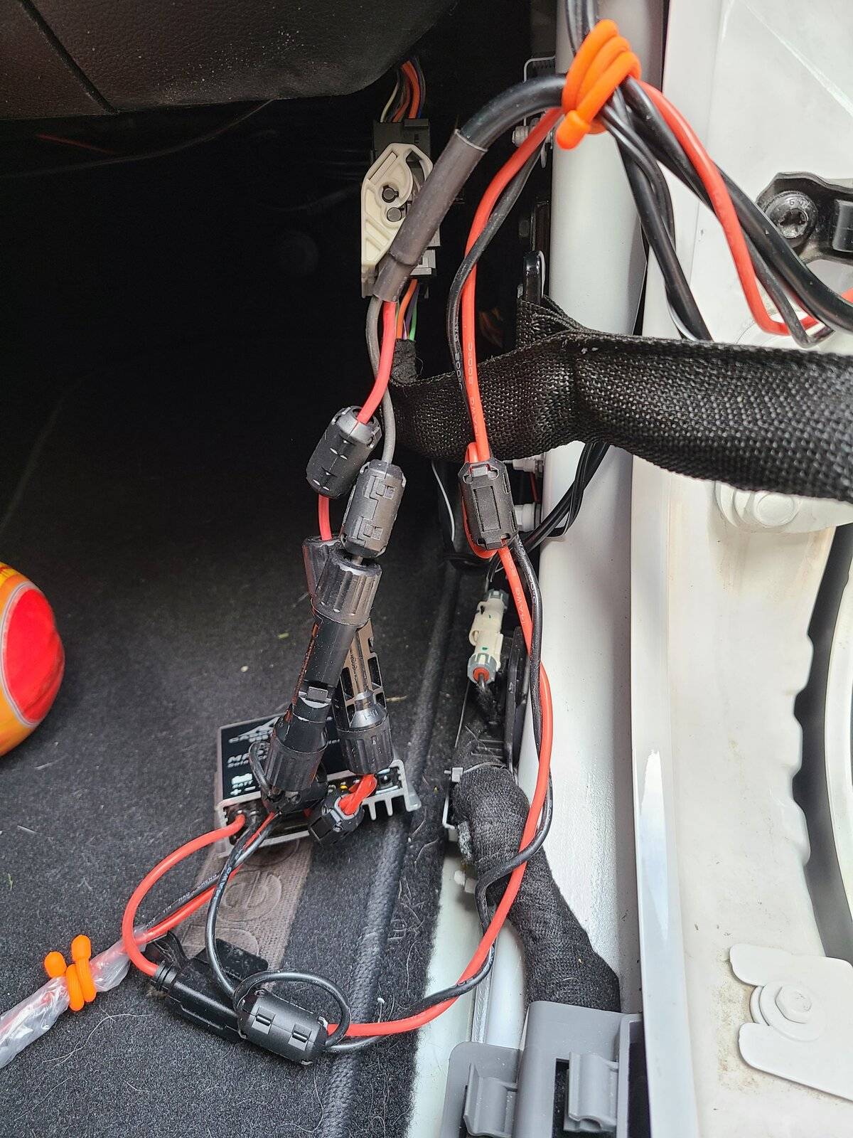

I added a ton of ferrites and moved some of them around, then added a few more twists and re-ran the ends of the controller wires. The noise from the controller itself is 99.8% gone.
Jeep Wrangler JL Cascadia solar controller whine/RF interference?  Snake oil works? 20210604_133214
Still have a lot of ferrite chokes left over, so I've been sticking them on everything. CB doesn't get anything from the controller, and has never been quieter!
Only tradeoffs: I'm getting a lot of weird squeals and warbles on AM radio now, that don't match any other noise. That, and there is so little slack in the wires now, my mounting options are limited.
Before all the ferrites, I did notice that the controller noise was modulated by location, as I could move it around and the tone and intensity would change. Maybe I can make it an off-road theremin.
