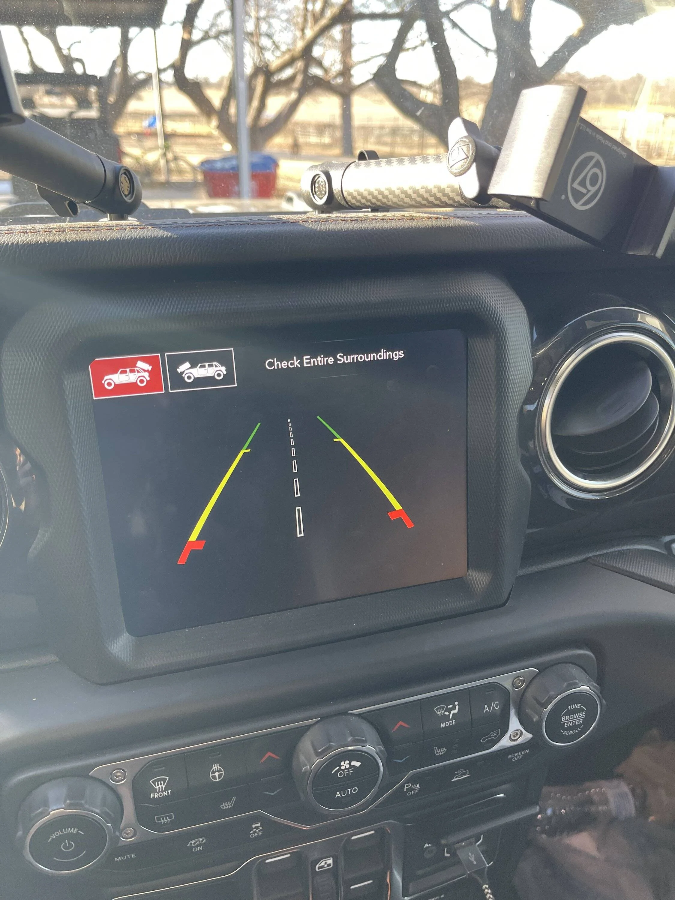

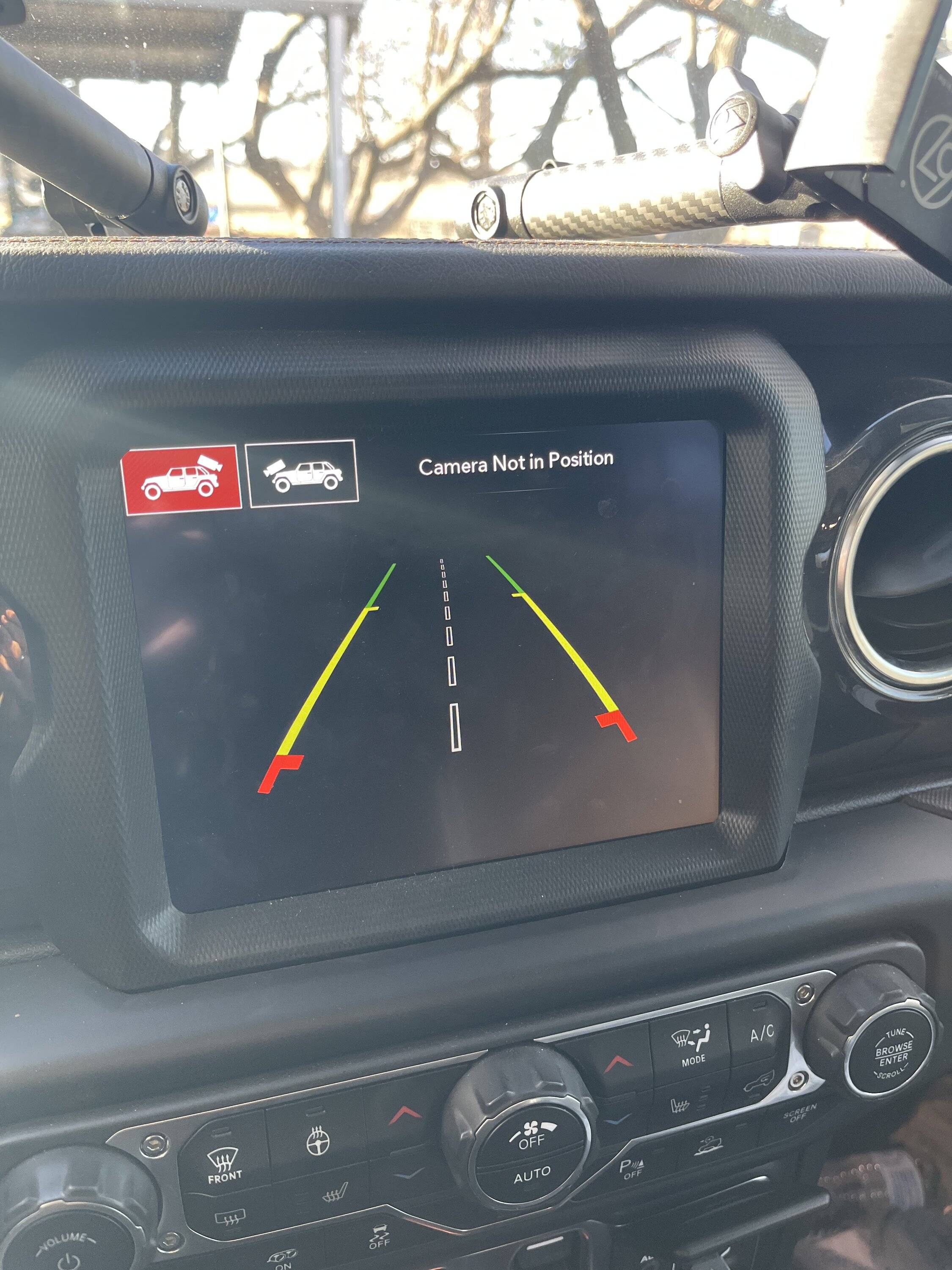

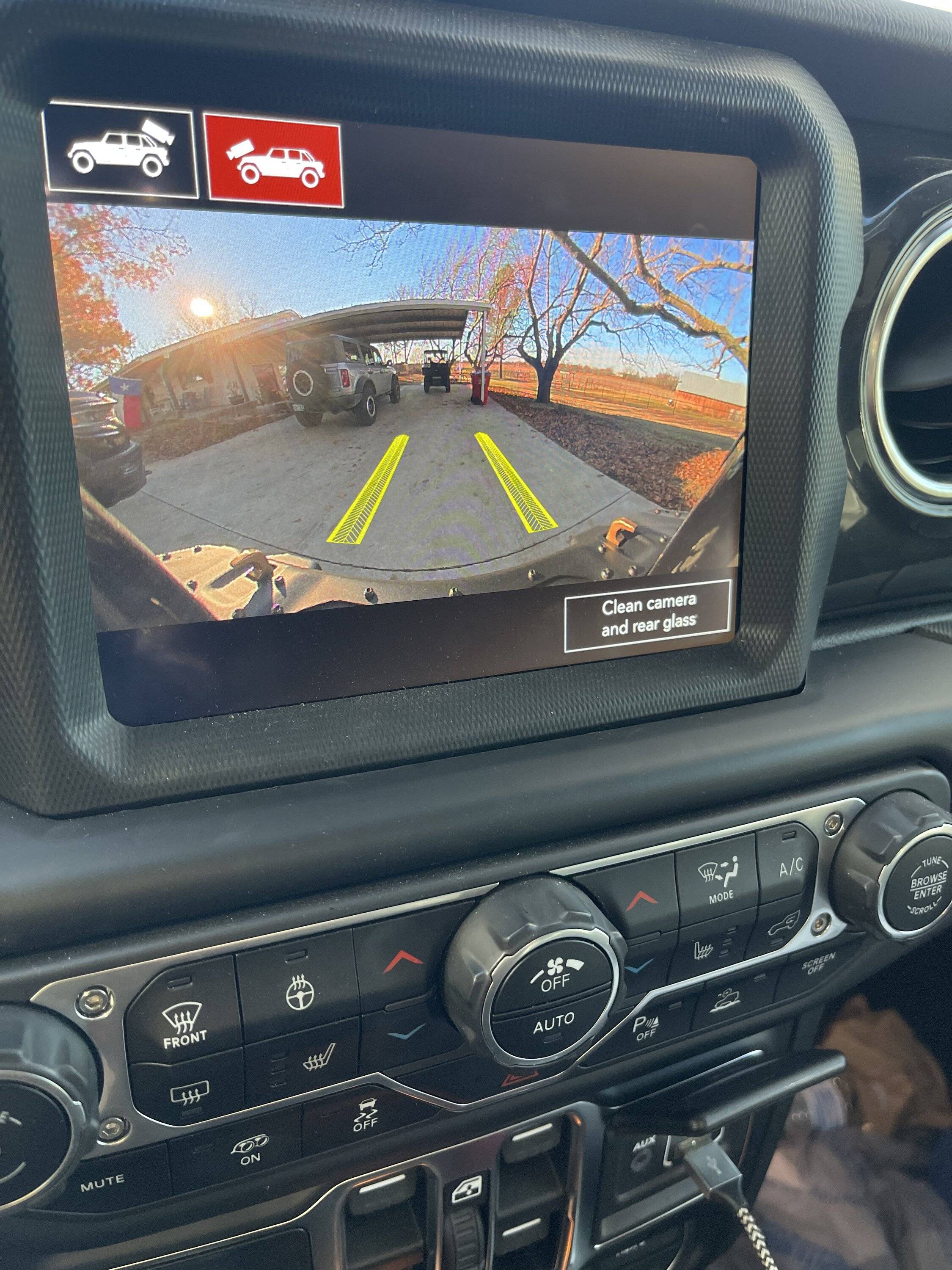

Reverse Camera quit working after I installed spare tire mounting kit.
Bchrist_85!
Oct 13, 2021
Decatur, Texas
2021 392 Rubicon
Jeep Wrangler JL Reverse Camera quit working after I installed spare tire mounting kit. 41A2EFBB-0FEB-4B6F-BD78-0489EFA08F8C
Jeep Wrangler JL Reverse Camera quit working after I installed spare tire mounting kit. 3E74BCC3-0237-4230-8797-CE613ED00C25
Jeep Wrangler JL Reverse Camera quit working after I installed spare tire mounting kit. 6BC85248-D09D-4911-8217-1628AF9679C0
Not sure what happened. As you can see, my front camera is working but now the backup cam won’t. I’ve unconnected battery, restarted system, checked wiring from plug to plug. Worked fine before the install? Anyone had this happen or know what to do?

Hmmm...only drive forward...? ?

Can you grab a picture of your camera and where it’s mounted?
