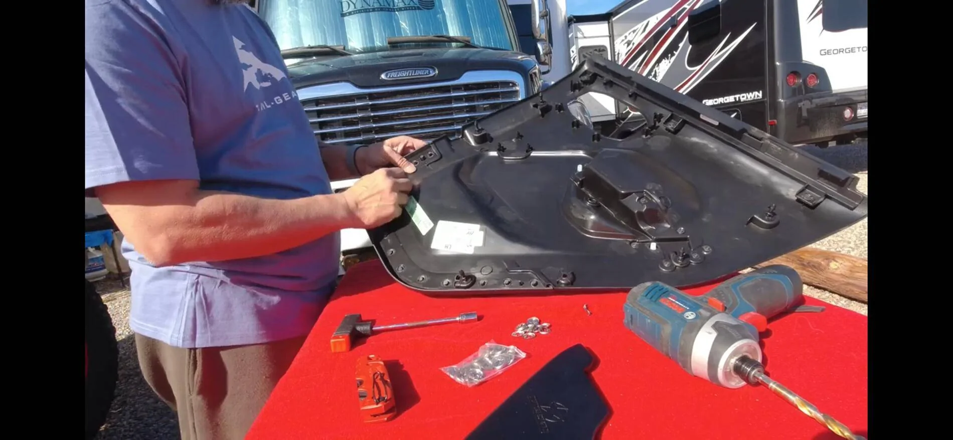

Here’s a screen shot from the Unofficial Use Only install video. That one is held on with screws too.
Jeep Wrangler JL replacing interior door panel IMG_8484
If you ordered a new one it should have the armrest on it. I haven’t had any issues after I changed the armrest upholstery
