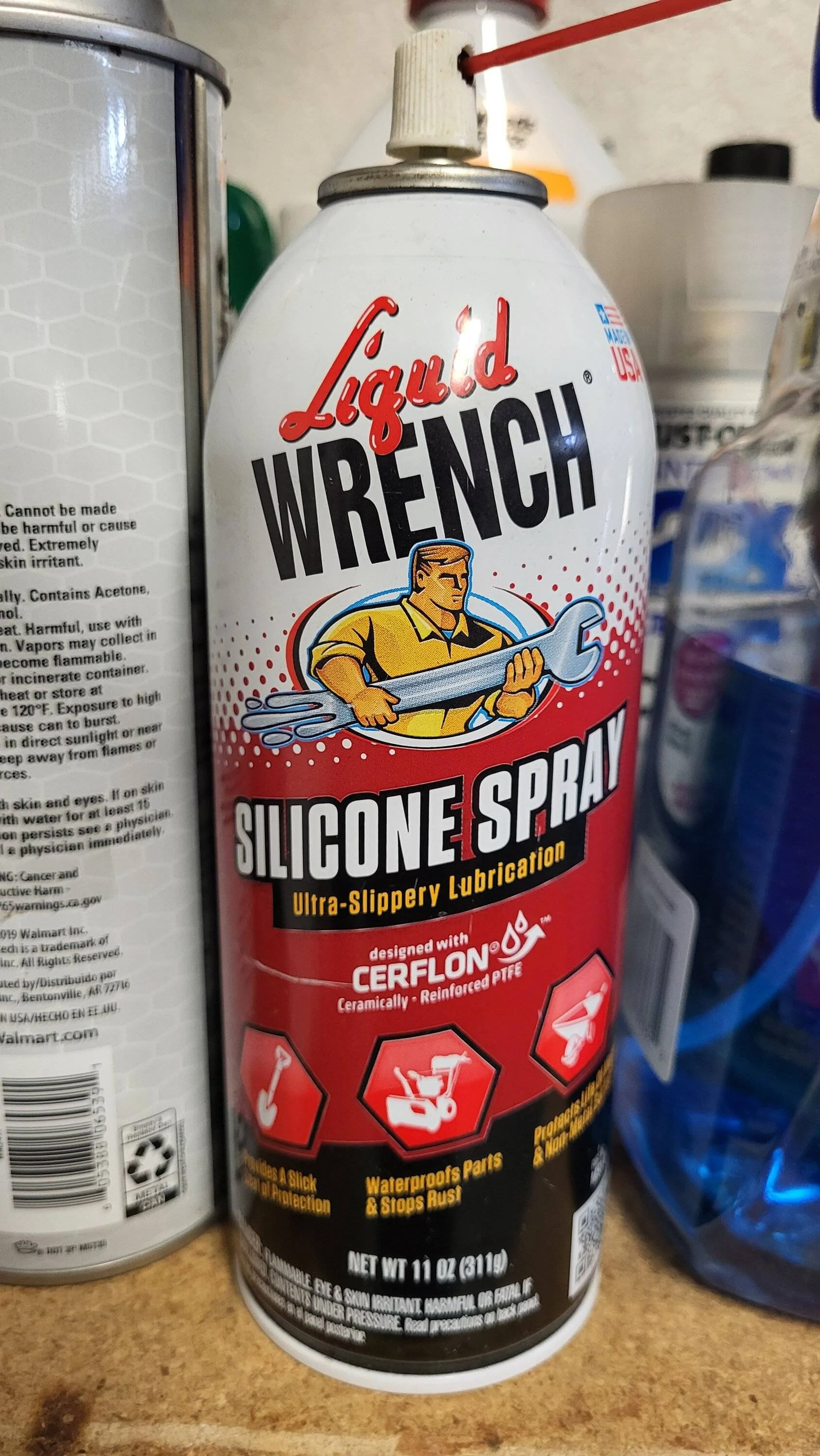

I've been experiencing a crackling/popping noise from the Freedom top front panels. I understand there is going to be movement between the top and the body. I checked all retaining screws for tightness. After reading the above, I decided to try with what I had on hand, Liquid Wrench silicone spray. After removing both front panels, using paper towel sections and the silicone spray I wiped down all mating rubber. I also did the locator studs and side rubber. Also the pads and latching cam levers. WOW! Huge improvement. Noise is virtually gone. I believe this will be something to do annually. While I was in the process, I did the tailgate rubber, hinges and latch.
