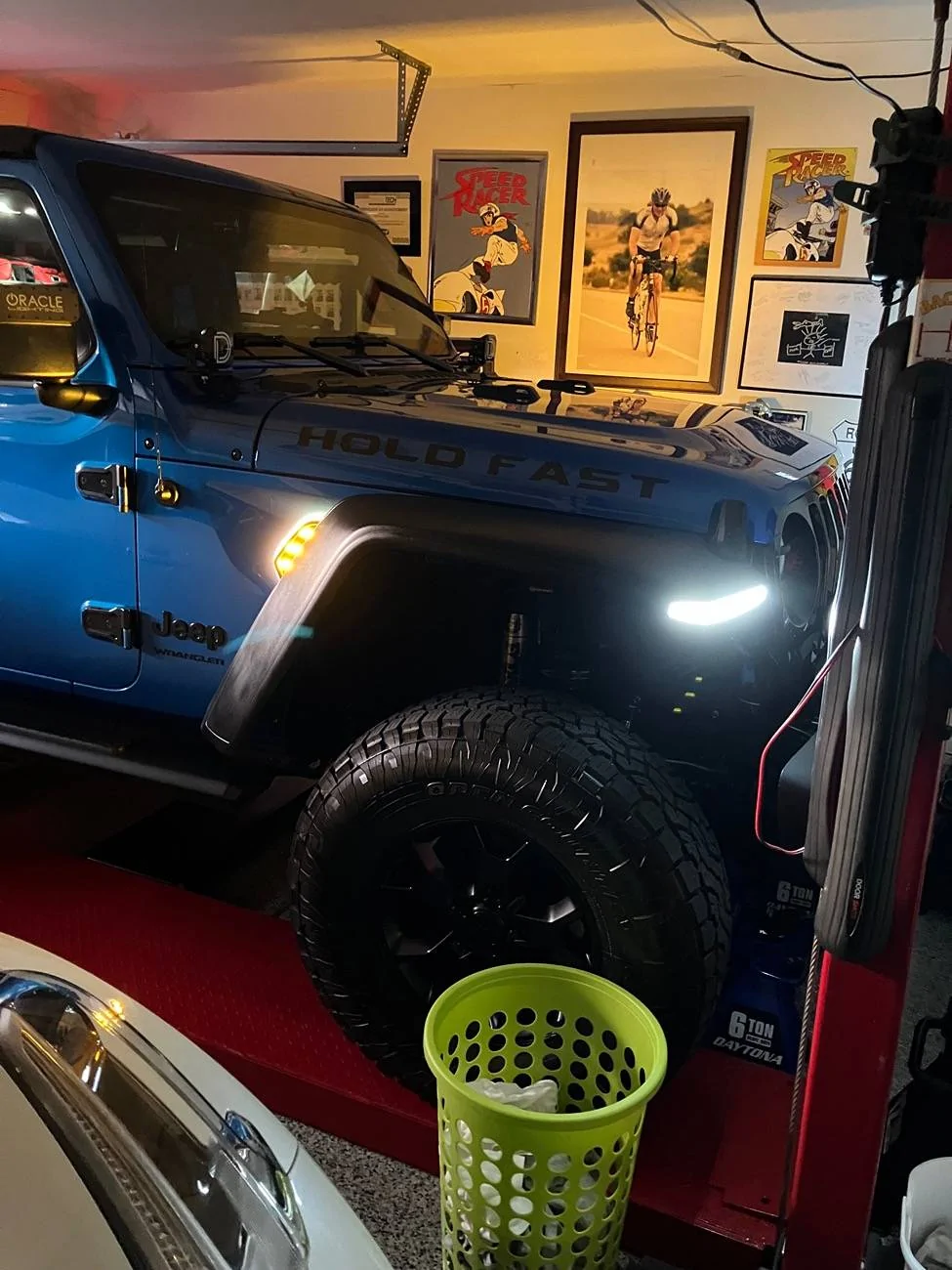

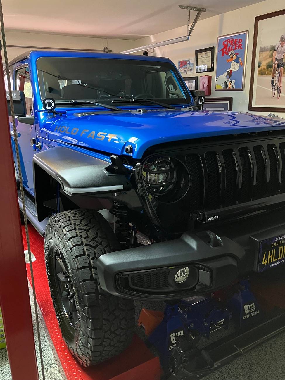

Scot, did you do a fender chop? If so, great job!
Thanks! Yes, did the bushwhacker fenders, with AAL liners. The side light is xkglow, it was a fun project. I ditched the plastic clips and used the AAL nutsert package to attach the fenders
