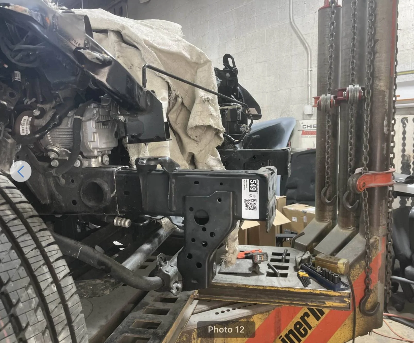

Involved in a accident, at first it just appeared that the factory bumper was bent slightly. When I went to take off bumper it wouldn't budge, had to hook it up with tow strap to pull it off. When I took off bumper noticed that one side of frame at front was slightly lower than other. Looks like it may be off about a half inch. Other side appears to be fine. Already have new steel bumper but I know it will not go on till frame is fixed.
Took it to one shop so far and they said it would probably have to cut and weld new frame part on, but guy didn't seem like he even wanted to do the job.. Looking at where it bent, do you think it is possible for a shop to heat up frame and bend back on a frame machine?

Repairable. The pic looks borderline, like it's kinked, but that's probably just perspective, so if it's not kinked, repairable. If it's kinked, it'll tear. If it's an approved repair, to section the frame, repairable.

Vehicles are made with "crumple zones", and those are made to be repaired or replaced, both body on frame and unibody. Frame repair is a common and well-accepted repair practice, done all the time. However, if the frame is "kinked" (bent over 90-degrees or bent over on itself), it will tear when pulled. That will require a more extensive repair, but more probably, a replacement of that section. Still, common; although, maybe less common on body-on-frame vehicles.

Really just sounds like I need to find a decent repair frame shop.

I know Jeep sells a specific frame repair kit for the front, involves cutting off the ends and replacing that section with new. Someone posted about it before.

Is the metal folded over itself, or over 90-degrees?
