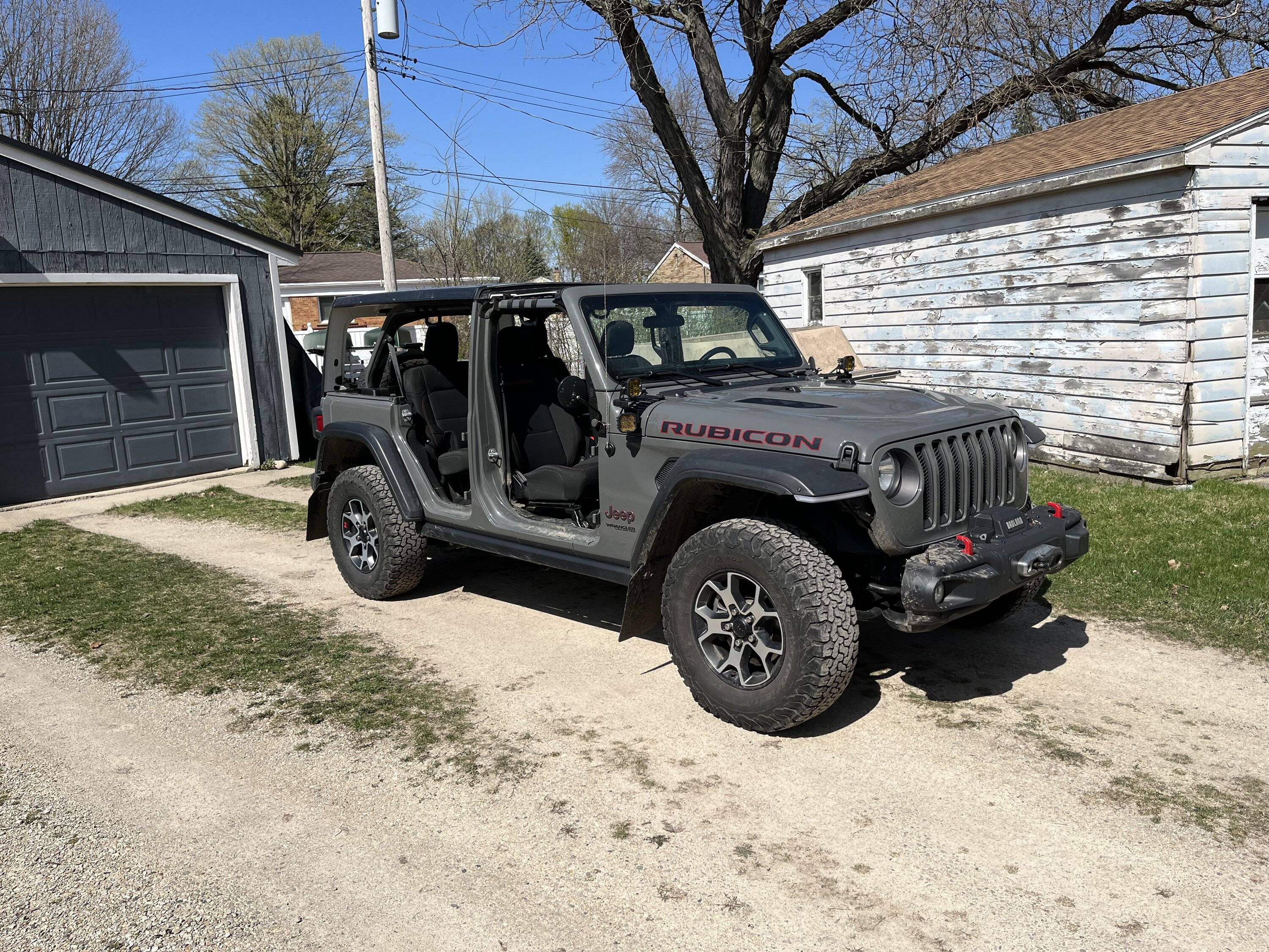

Also, the side windows do come out for the SOT, right? So Jeep is already part way there! I did see in another forum that they have a design for a modular hard top on the Gladiator but who knows if/when that would go into production. Also don’t want to pay several thousand for a whole new top.
