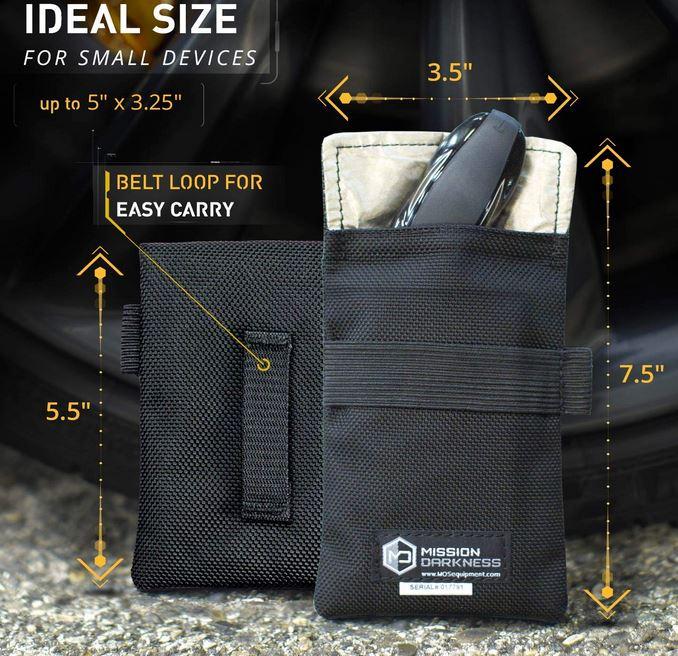

I keep my second key fob wrapped in foil in the Jeep. Had a key made to open the doors. Just in case I'm in the boonies and loose the fob. No problem with locking it with the fob cause it cant see the fob in foil. I would take it to the dealer. Shouldn't lock with fob inside.
@MtCamper
If you ever decide to replace the foil with an upgraded shield, consider this Faraday Bag. I can tell you that this one is just the rgith size for the JL Fob... it's well made..Made in the USA, works well. I prefer it over aluminum foil.
https://www.amazon.com/gp/product/B01H1C21O2/ref=oh_aui_search_detailpage?ie=UTF8&psc=1
