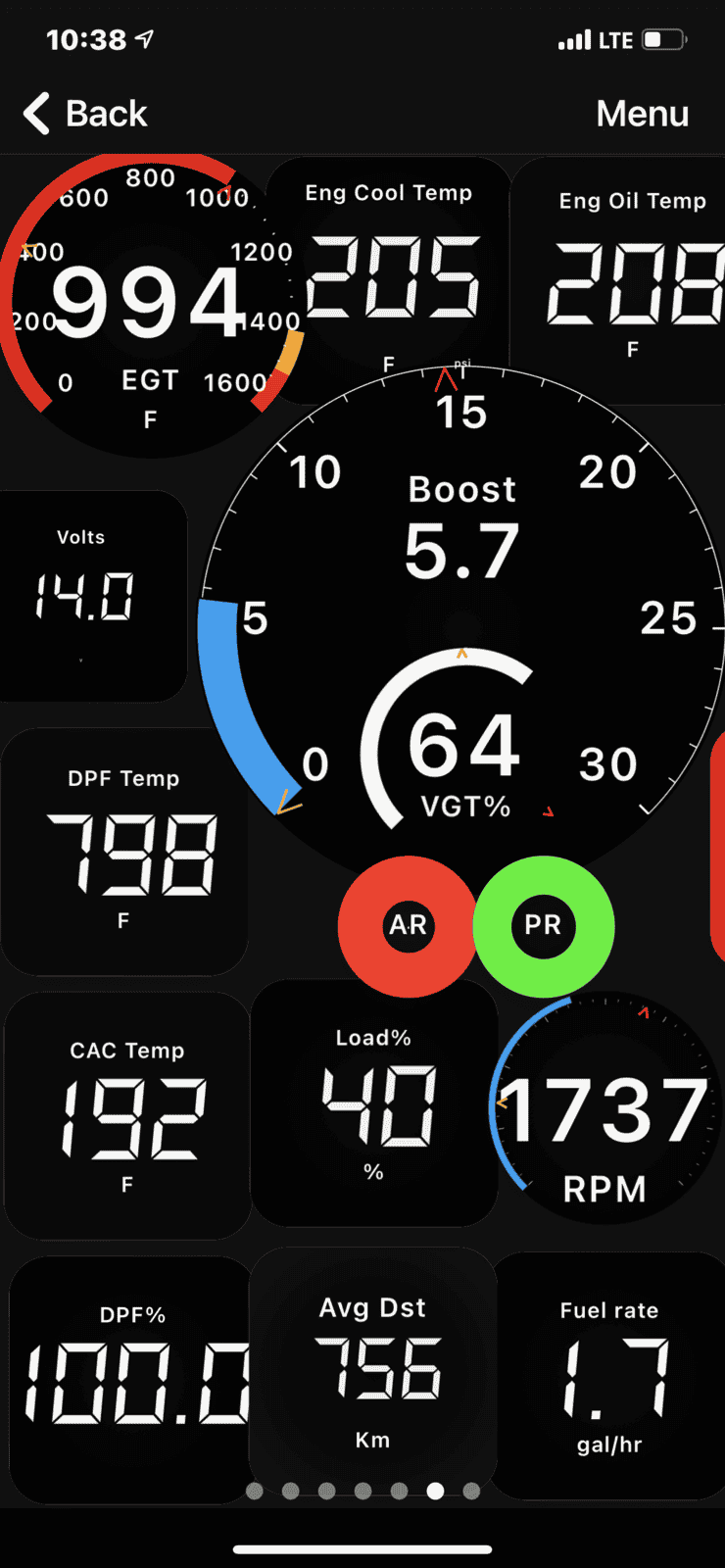

I’m pretty sure we’re seeing a passive regen. 300+ mile trip Sunday, saw the same rapid cycling from off/pas regen status. Soot dropped slowly from 71% to 30% over the 300+ mile trip which matches what I see when OBD Fusion shows passive, during an active regen soot drops rapidly to 8% in about 10 minutes. The rapid cycling matches what the guys were seeing with passive regen on the Scan gauge.
https://www.jeepgladiatorforum.com/forum/threads/scanguage-regen-and-soot-problems.50882/
I’m waiting for an OBD splitter so I can monitor my Idash and OBD Fusion together until I get this figured out.

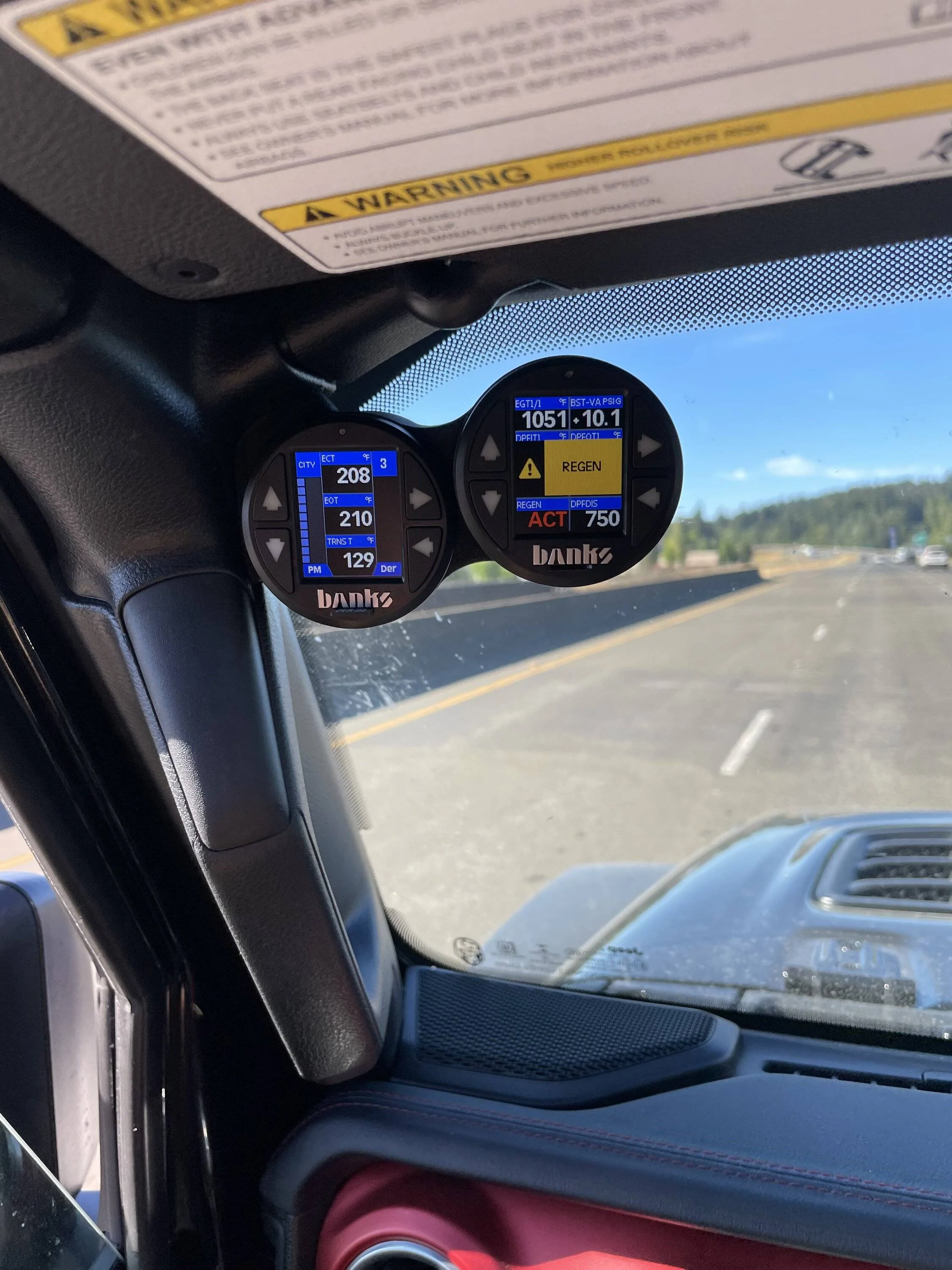

I had set the alert hi parameter to 2 to see if an active regen would trigger an alert. Today on my way home from an active regen started and it did trigger the alert. The regen status cycled between “PAS” and “ACT” the entire time the active regen was going, once the active regen was completed the status again started cycling between “OFF” and “PAS”. I think banks may need to do a little tweaking to the status indicator
This regen started at about 35% but when it triggered the soot went up 75% then dropped to 8% over a 10 minute period and was done.

Really great post very informative. Hopefull using the videos. Thanks. Agree Banks does need a little bit of software update. Have never witnessed the quick intermittent "pas" and "off" That appears to be a glitch too, that Banks should address.

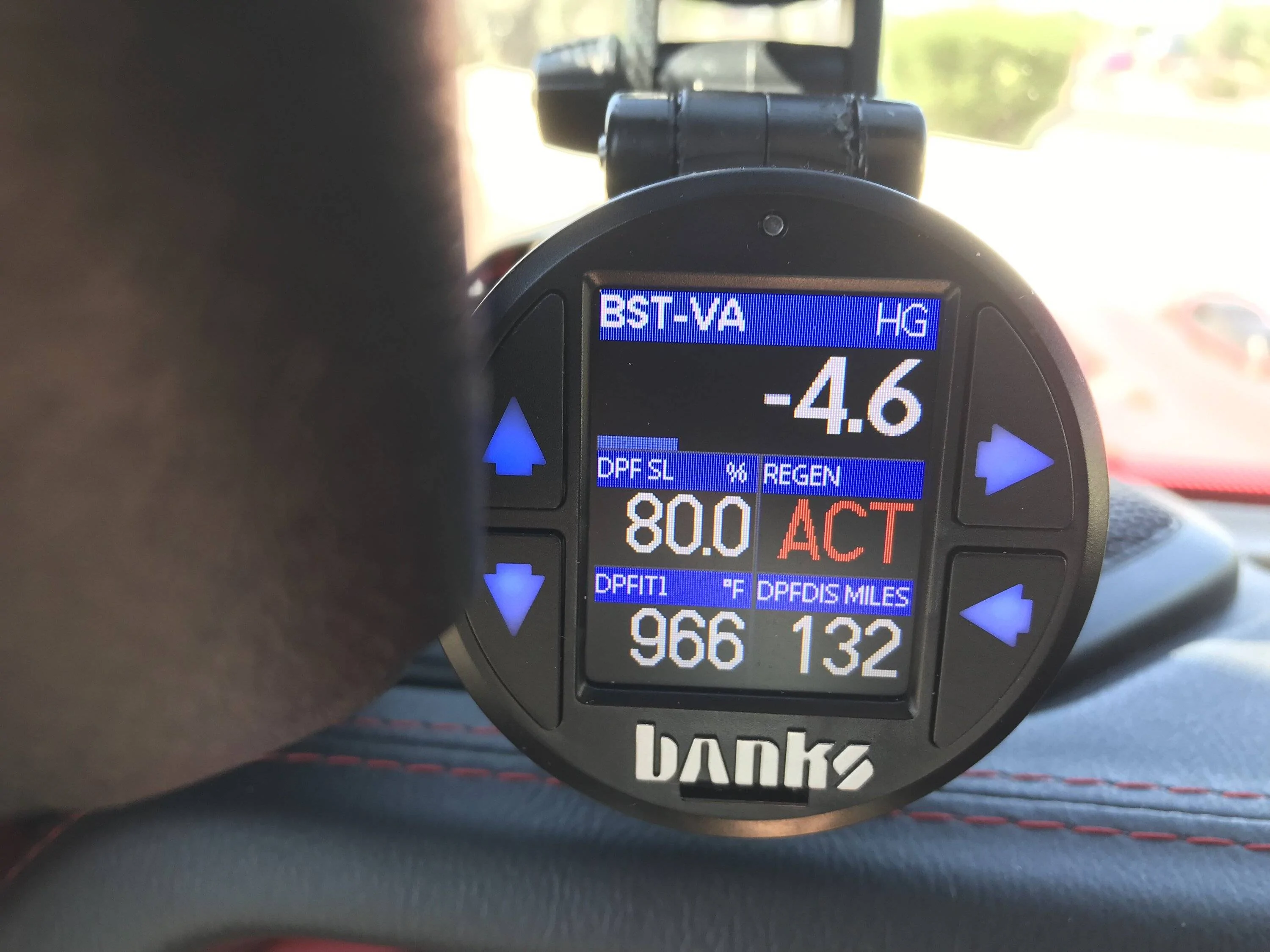

Here is what a regen looks like with the flashing alert turned off. For newbies: note the 80% DPF level (the trigger point), the red "ACT" (active), and, most notably, the increase in DPF temperature. 966 degrees is over double the normal DPF temperature at idle.
