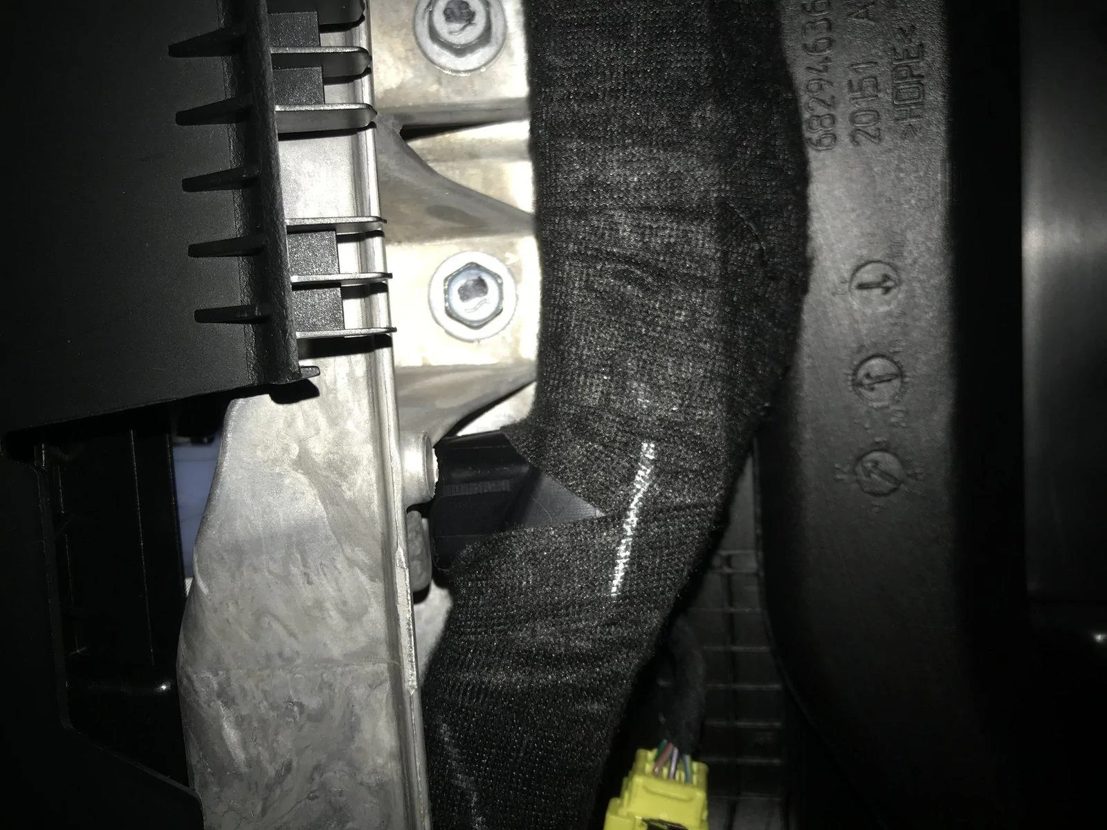

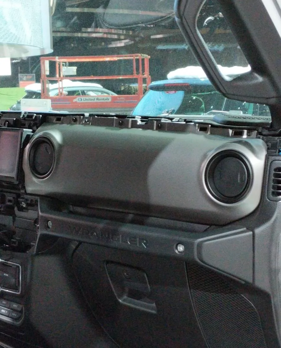

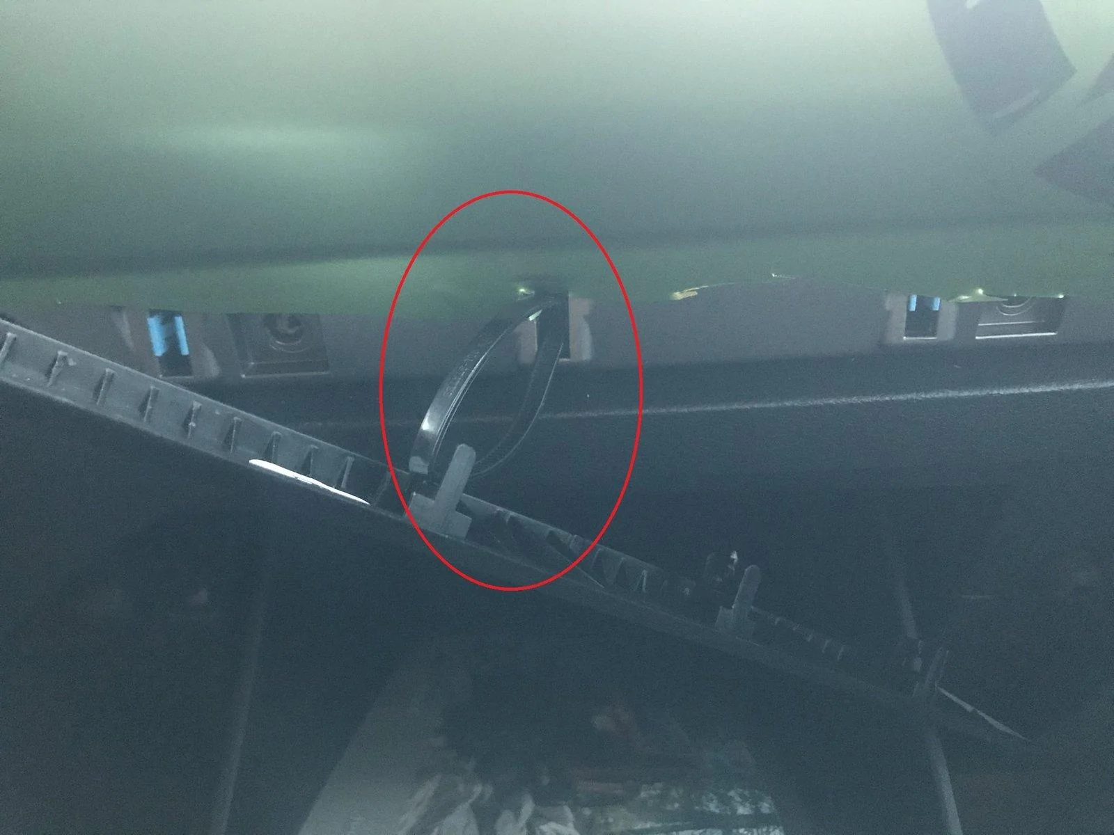

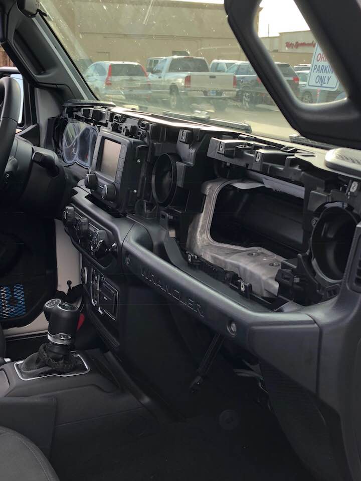

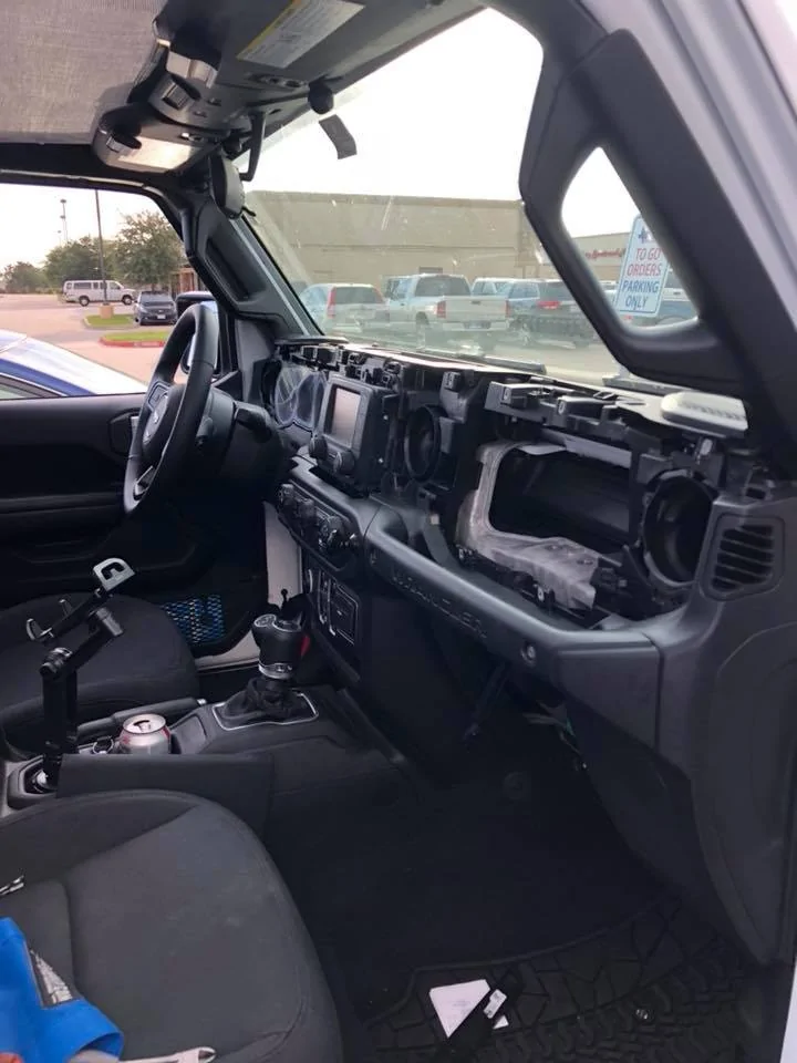

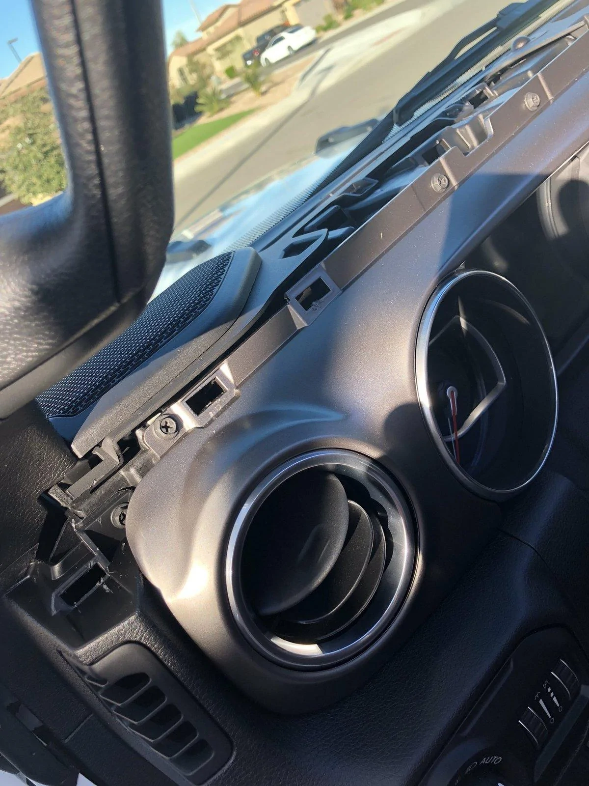

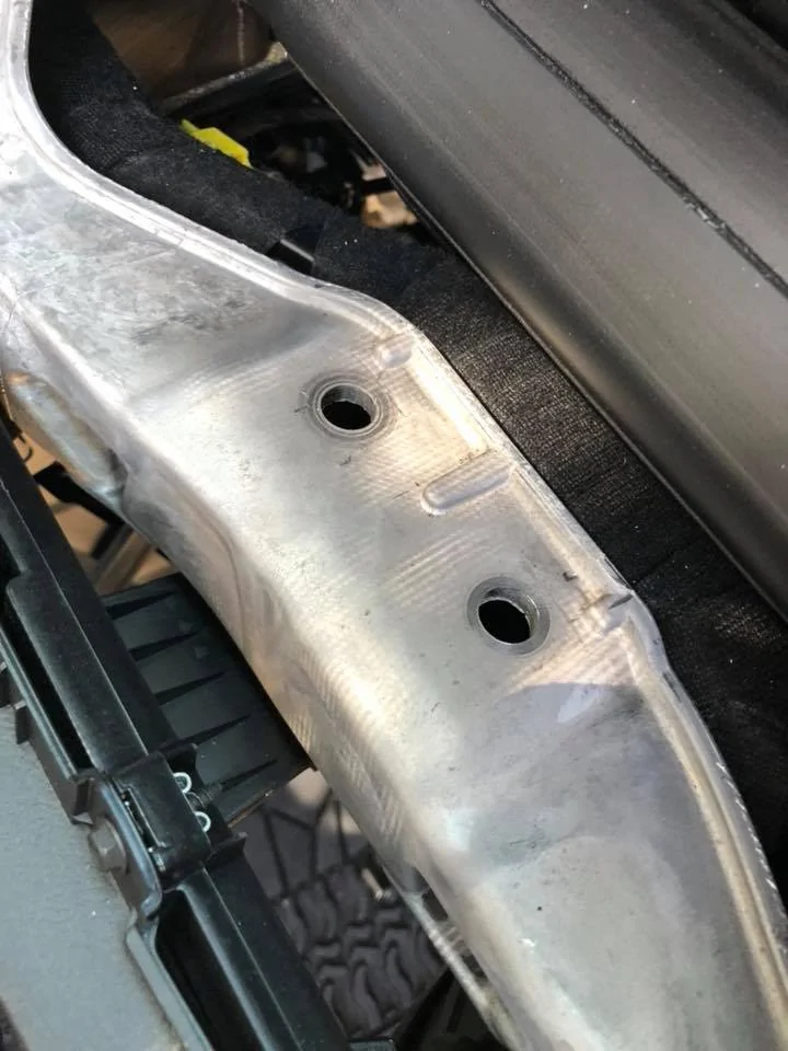

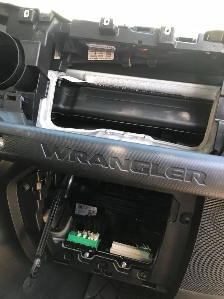

You need to pop off (has clips only) the AC controls bezel. Unplug the AC controls and starter button. The remove the radio bezel (Again clips only). Next remove the top dash pad. This has several clips and one screw that is hidden under the radio bezel. Now the fun part. Remove all the top screws on the driver's side dash (Red piece). The pry off slowly (Clips on the bottom). The passenger side is harder. Remove the top screws. Under the bezel is the SRS Airbag trim piece. You will need to remove that (3 clips) and cut the zip tie. Now remove the two screws that are under that trim piece. Open and drop the glove box. Look up and you will find two bolts (see picture) Those are for the airbag. (the airbag will come out with the dash panel. (The red thing you want painted). Remove the two bolts. Once you remove the bolts, pull the airbag and dash bezel towards you. from under the dash, you will now see a yellow plug. Unplug that plug and you are done!
Jeep Wrangler JL Red Dash Trim Removal / Replacement Dash with top off drivers
Jeep Wrangler JL Red Dash Trim Removal / Replacement Dash removal1

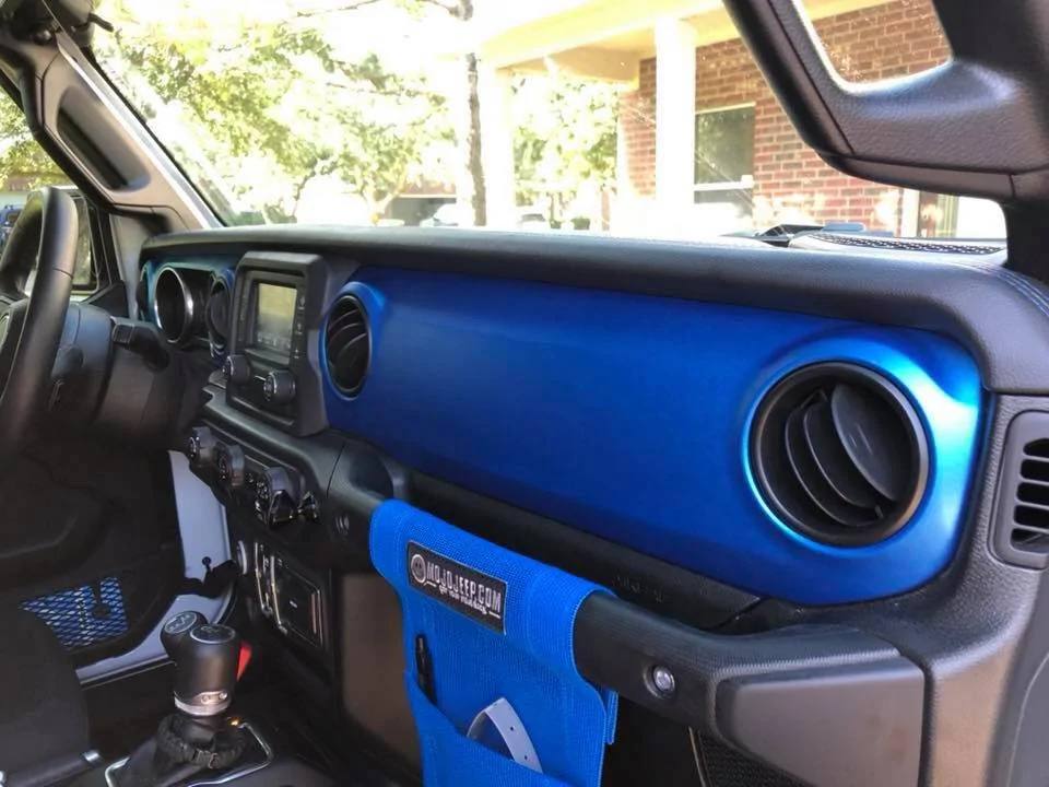

I appears to have been done by a pro. Is that you or did you have it done? If so where and how much, if you don’t mind sharing.

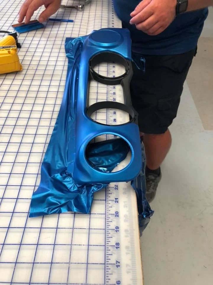

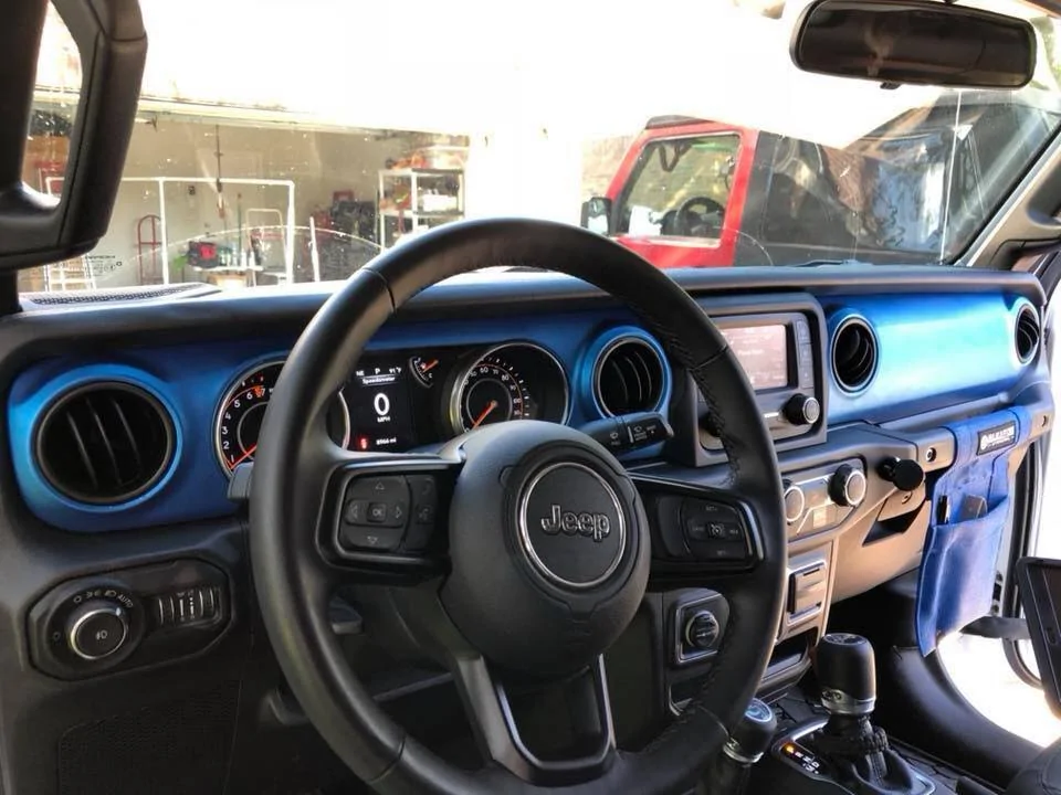

I saw that your workspace looks like a pro shop of some kind. Great job. So how much will it cost me for you to wrap mine?
You can do it yourself. It's not that hard. Just follow the instructions from the link I posted and then take the pieces to a local shop that does wraps. If you are in the Katy/Houston area I would suggest 5S Signs to wrap the pieces.

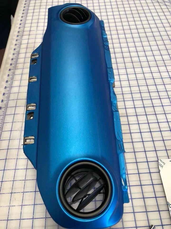

It's a wrap
Phenomenal job!
It really is the way it should’ve looked from the factory

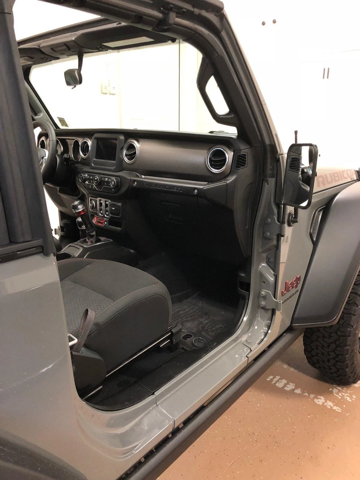

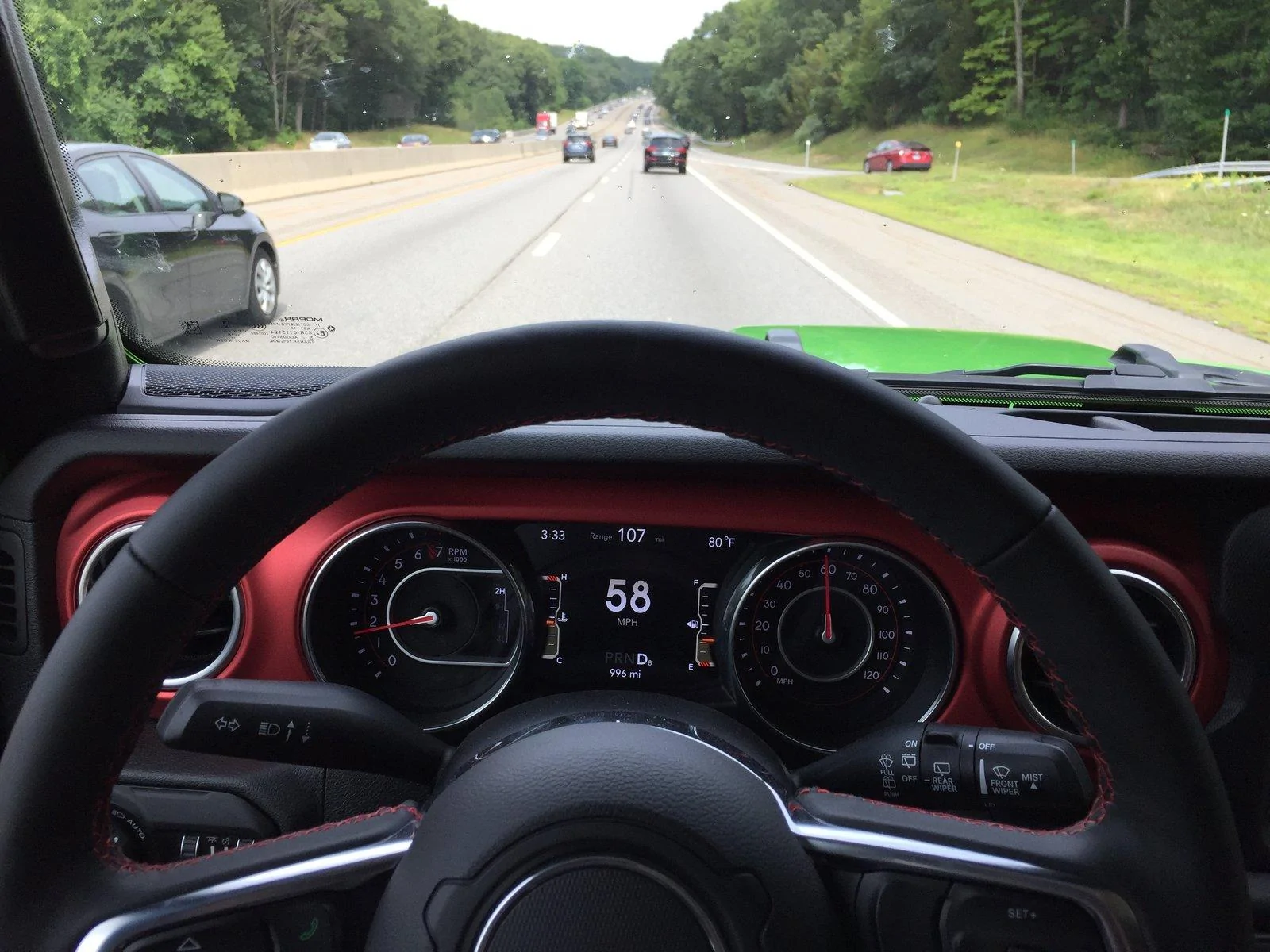

here are some pics of a successful trim swap thanks to this forum...Pic18 was driving by my area and was nice enough to do all the work since I didn't trust myself...so if he sees this he can comment better on the difficulty...
I'm very happy with the grey panels with my stingray grey exterior

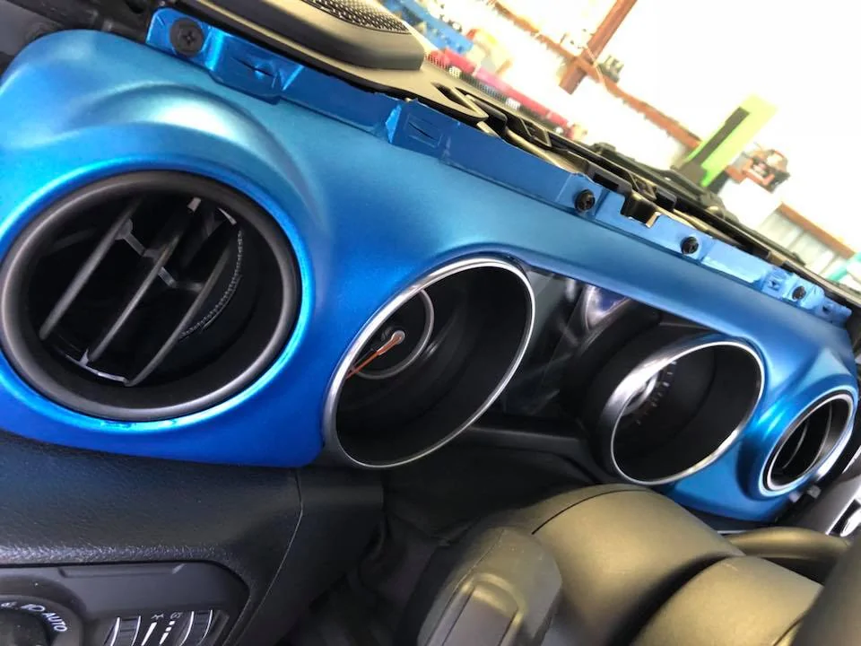

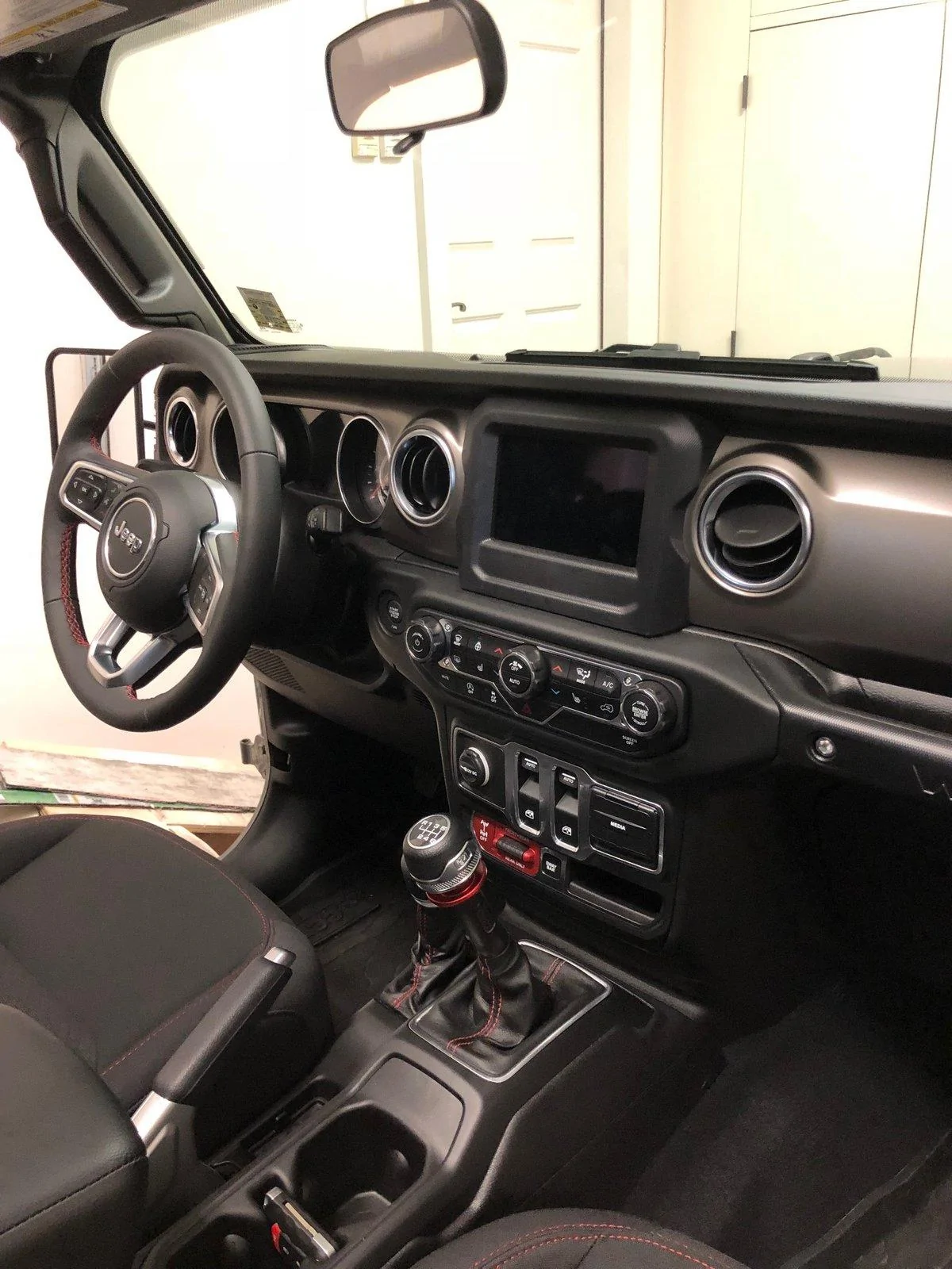

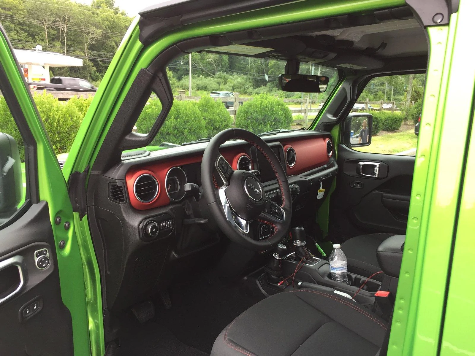

Thank you @codeIV for the great instructions on how to do the removal. Thank you @mango315 for doing the swap with me. Without further ado, I present a Mojito JL with red dash inserts.
I think I may need some time to determine if I like it or not. The red and green both compete for attention.
It's like Christmas time in your Jeep!
