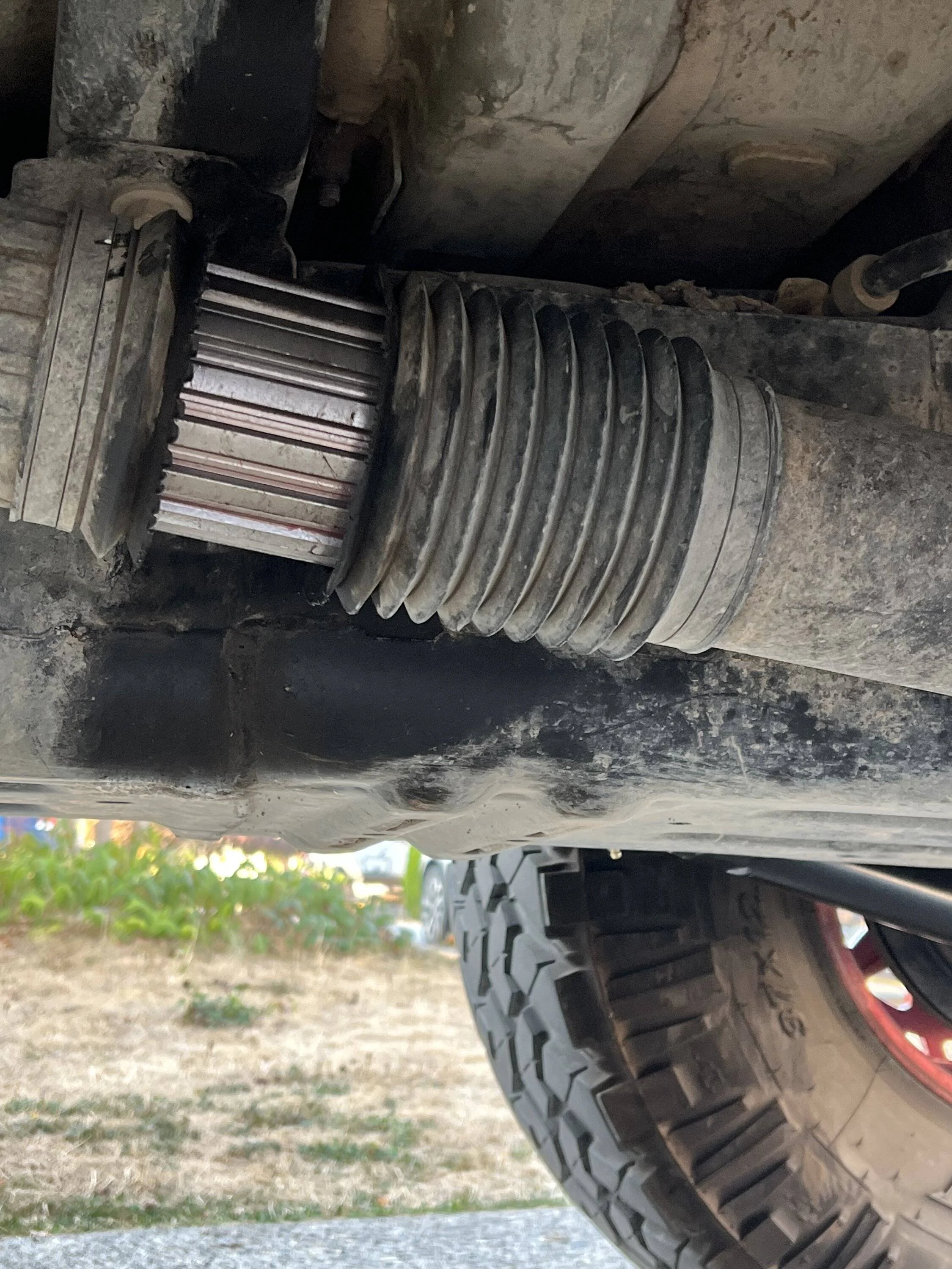

Does anyone know if the JK boot kit fits on the JL Rear Shaft? Tore mine and can't find a replacement for the JL...

No idea..check Mopar parts sites - just make sure you remove and thoroughly clean those spines and regrease or you will be replacing the drive shaft very soon..

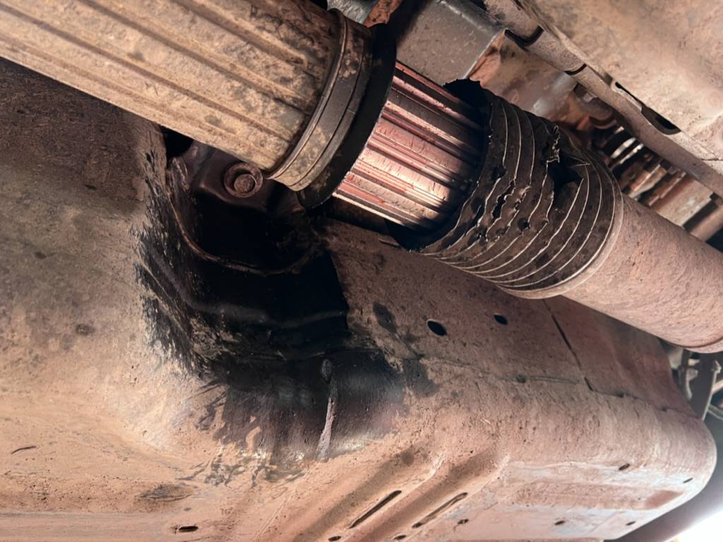

Same thing happened to my 2021 JLUR. Any luck in your search?
After talking to some of my Jeep mechanic buddies, they all confirmed the rear drive shaft for JLU is not serviceable, the fix is to replace the entire rear drive shaft.
After looking into 3rd party options, spoke to the Jeep dealer, they only warranty OEM parts.
So I ordered one from a Mopar parts dealer, should be in next week.
I helped buddies swap rear drive shafts in the past, seems like all you need are the right sockets and allen bolts, and a few bungie cords. No lift needed, the Jeep can stay on the ground.
