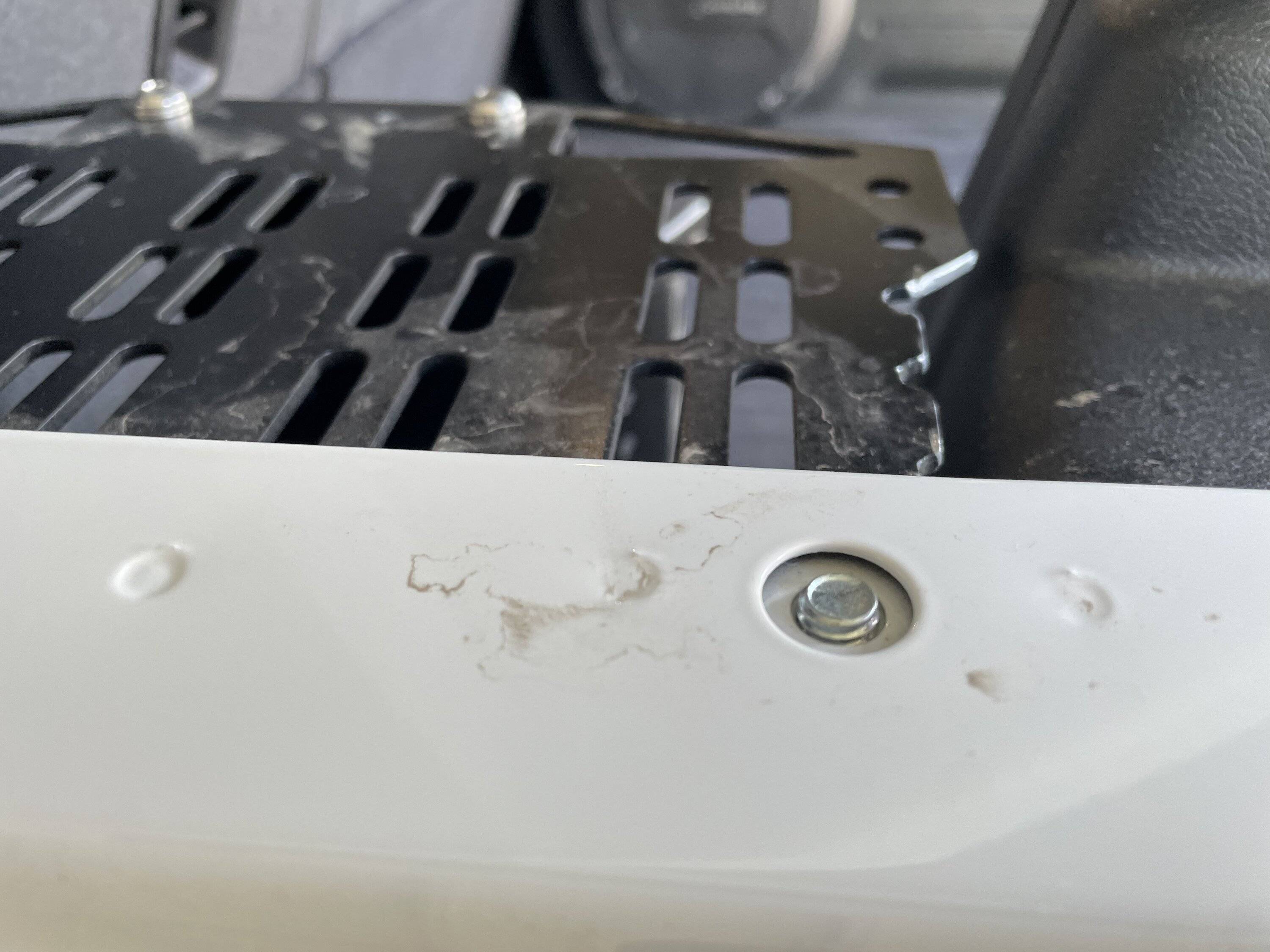

The bottom of the window is flat with two pins that go in holes in the tub. There is foam weather strips on the window with cutouts where the bolts would go. A bolt will not fit between the window and the tub, I think the only solution is to use short bolts inserted from the underside, they can not protrude above the tub or they will interfere with the window.

Like this..
