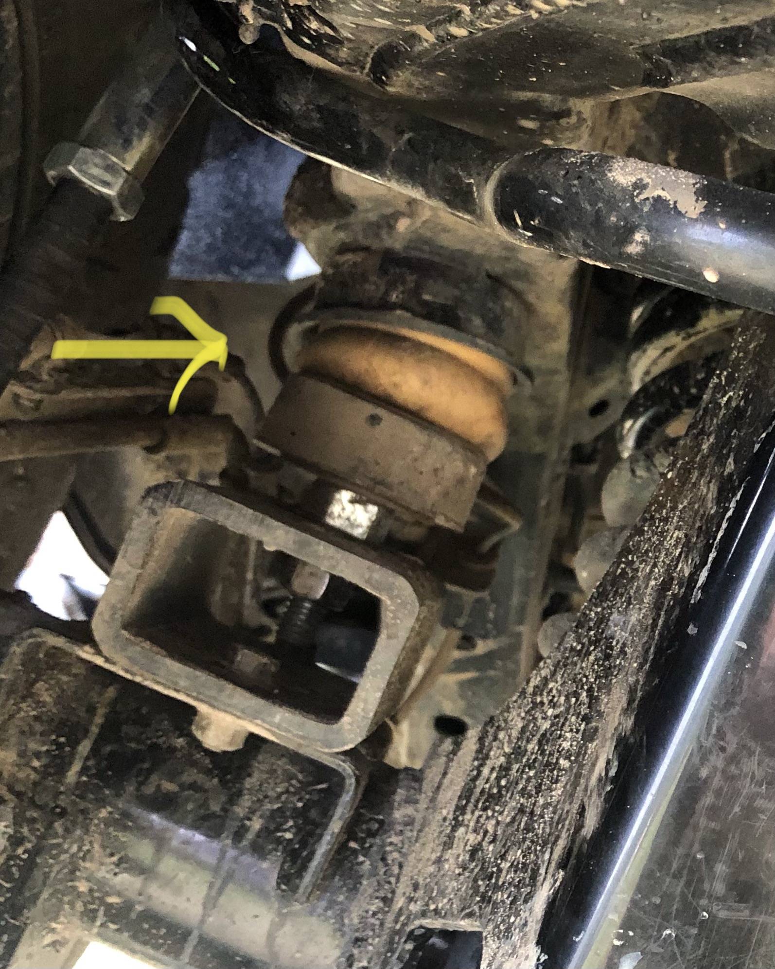

Hi JL People, does anyone know how much the bump stop rubbers compress when the suspension bottoms out, say driving fast through a deep rut.
I am referring to those Yellow/ white bump stop rubbers at the rear.
can they compress under suspension force and with how huch, an inch?

It looks like 1/2-3/4” ish, I can’t see the front through my spring when compressed, but here’s pic of the rear……..
Jeep Wrangler JL Rear Bump Stop Rubbers 4095B859-DF9C-440B-8DC8-9720C6A26332

Under high speed bottom out conditions, they will likely get very close to metal on metal. At some point they should reach "block height" like a coil spring. Just depends on how big that rut is andhow fast you hit it.
