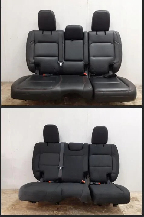

Hi, guys, is it possible to swap rear bench? I have sport 2D bench and Im able to buy rear benches from 4d rubicon, where are 3 headrest and its possible to fold it in 2/3 also with or without armrest.

Maybe, but it's not going to be just a bolt it in and go kinda thing. You will have to fabricate new mounts and make sure that they are strong enough to keep occupants secured in a crash. The fitment might be tricky as they don't sit in the same area between the wheel wells exactly.

If you have a 2 door, a 4 door bench won't fit due to the bench being narrower because the wheel arches intrude in that space.
This is the answer. 4-door benches are about 8in wider at the base because they go forward of the rear wells, whereas the 2-door seat needs to fit right between them.

I thought the mounting points wouldn't fit, but the width is really limiting. Anyway, I'll measure it and look for an upgrade.

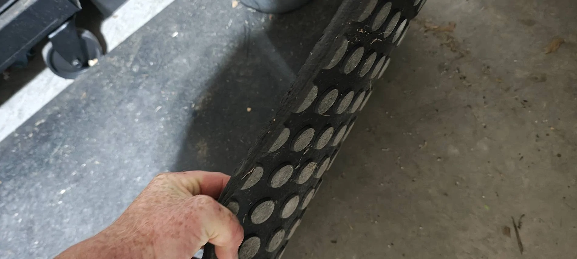

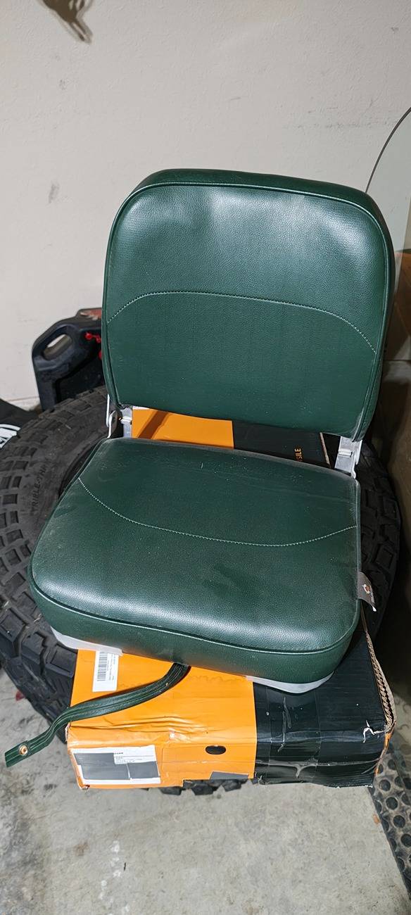

One of these days I'm going to turn this thing into a workshop chair, until then I've just been storing it in the garage.

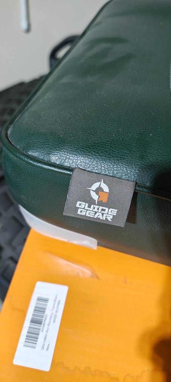

I believe the chair was like $50 on amazon. It is a fishing boat chair. Comes with the bolts although I ended up opting for longer ones because I wasn't in fact installing it on a horse stall mat that I was using as a cargo carpet in the back of my jeep.

I've since cut up the cargo horse stall mat after removing it from my Jeep and I'm not using it as a shop mat in front of my tool chest.
Jeep Wrangler JL Rear bench swap 1000011510
Here's the aluminum plate and the bolts I was using with washers and lock washers. The idea behind the aluminum plate was to spread out tension over a large surface. If you just had washers and bolts going through the horse stall mat into the seat, any sort of crazy movement in the Jeep could yank the bolts through the horse stall mat and the seat would fall out of place. With the aluminum sheet metal there, pressure is applied across a 12-in by 12 in surface, basically the seat ain't going anywhere unless the horse stall mat tears out with it. I don't know if you've ever picked up a horse stall mat before, but they are unwieldy, they do not tear easy (they're intended to hold a 1000 lb animal), and each mat weighs about 80 lb. So moving around is no easy feat. Especially because of how floppy it is!
The process was very simple. Drill some holes in the horse stall mat, that match the bolt holes in the boating seat, put a piece of aluminum sheet metal underneath the horse stall mat, and put the boat fishing seat on the other side of the horse stall mat, pass bolts through the aluminum sheet metal and the horse stall mat into the boating seat, and then strap the whole cargo mat with the folding seat attached to the normal tie-down points I was using in the jeep.
In my case I did not attach a seatbelt to it. If I ever improved the design to make it more safe and more DOT compliant, I might have installed a seatbelt, but really it was just something fun for me to do, and a good place to eat lunch, and/or a fun space to hang out in the back of the Jeep when I was at the park. I can't tell you how many sandwiches I ate in that seat over at Denison Dam.. it's a big number! :giggle: ;)
What it leaves you with is a really fun jumpseat that I would not recommend using while the vehicle is in motion outside of extremely short hops with people who are okay sitting in an extremely unsafe jump seat.
