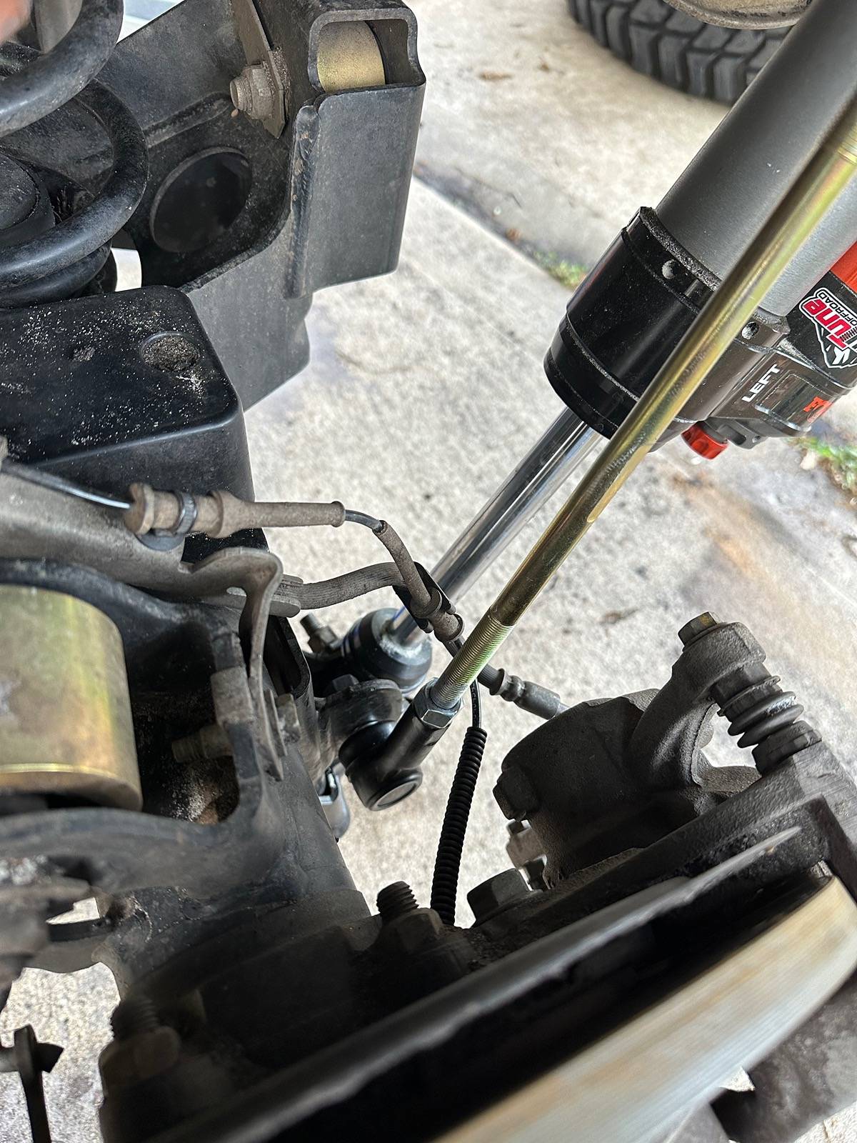

For you guys with rear antirocks did you leave the brake lines on the outside of the rods or did you move them to the inside. When it’s all bolted up the ABS line seems fairly snug so I played with leaving it outside or moving it inwards and was more worried of it getting snagged on the bottom of the end link if left inside.
Seeing how it looks on the inside but worried ABS line could invert and snag on bottom end link

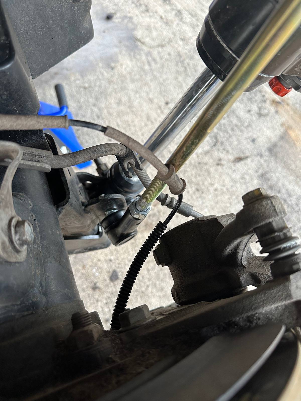

How I left the lines just didn’t want anything getting pulled tighter

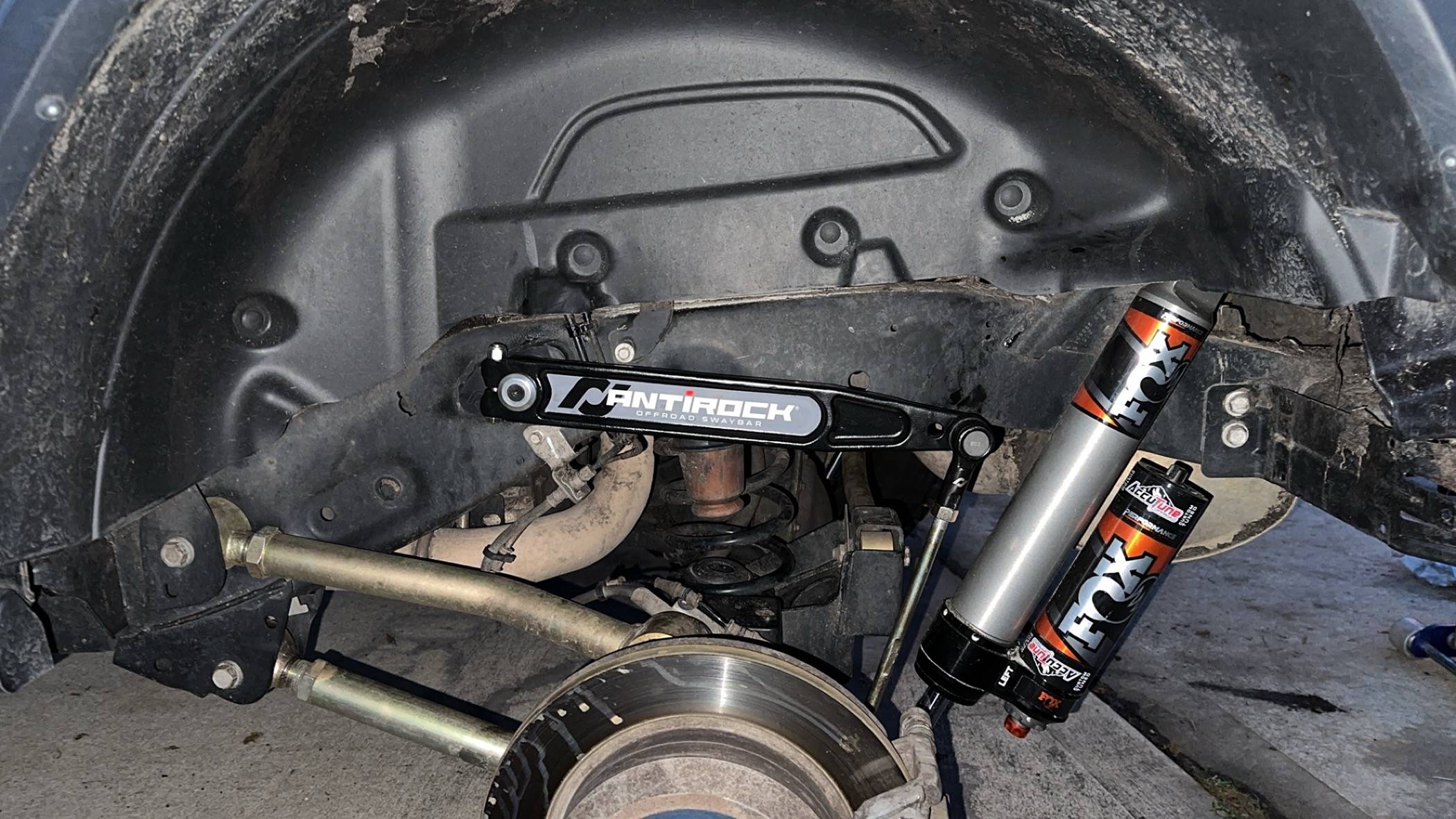

With 7 inches up and 5 down for suspension travel this is where I clocked the arms I think that’s about right

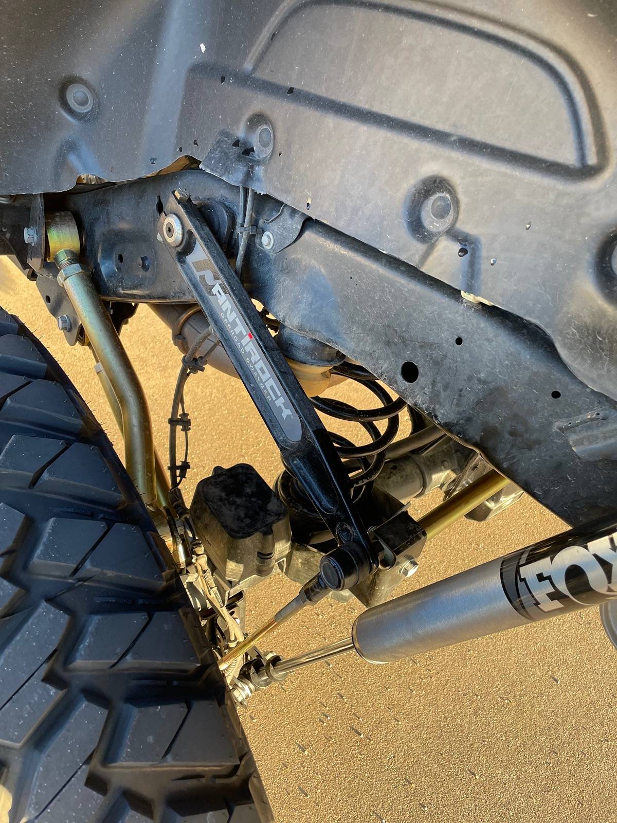

I kept my link inside the brake and ABS line. I did gently bend the hard line going into the caliper out slightly tk get a little more clearance. So far so good.
