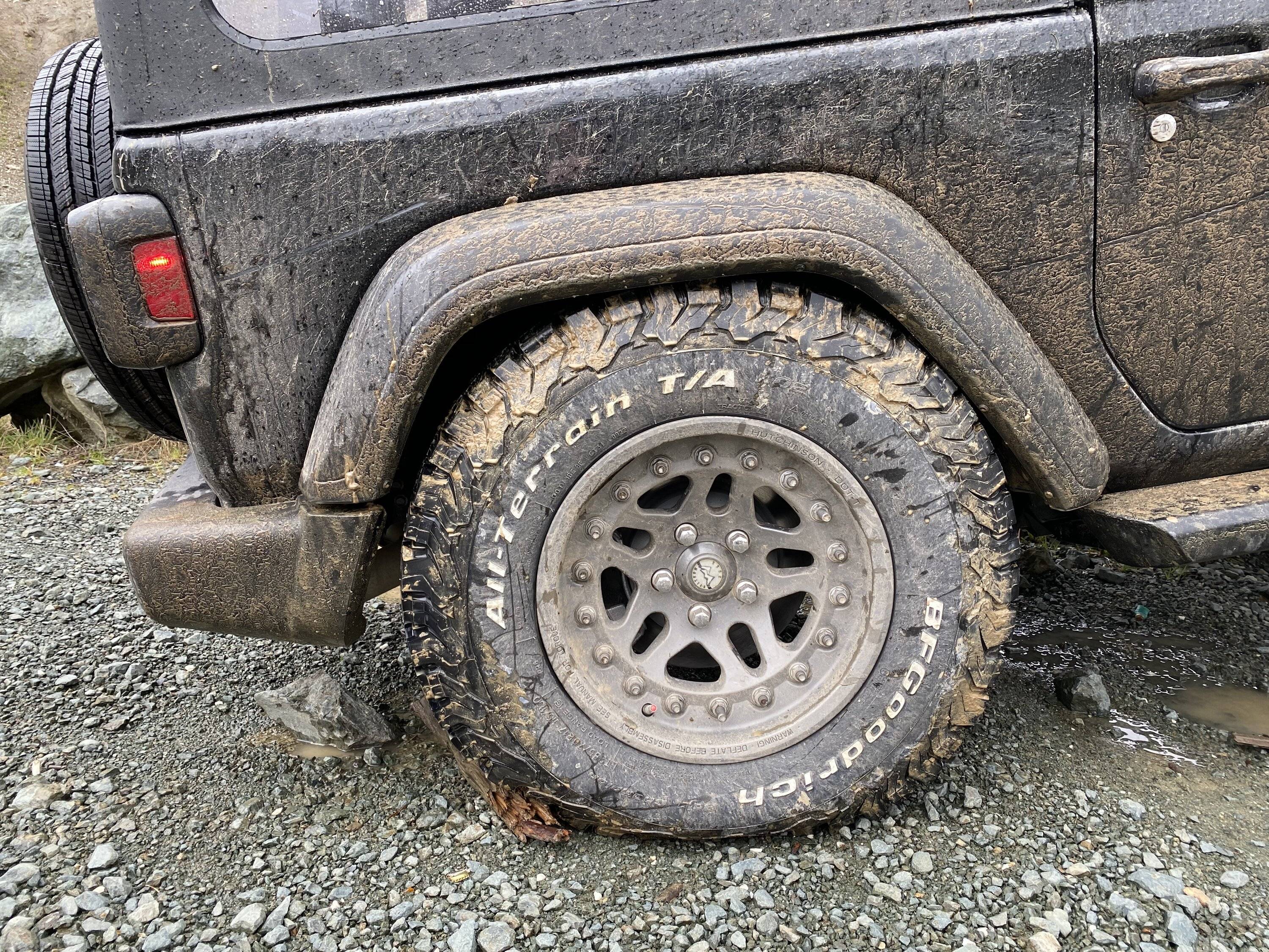

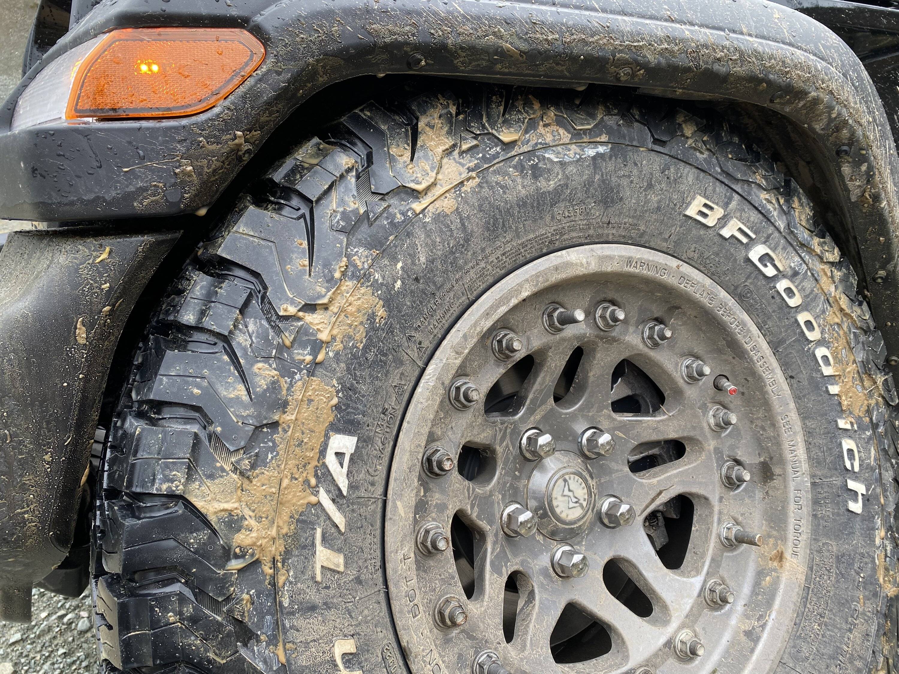

Ok, I know this question has been asked in different forms previously but let me ask once more.
I have a JLU sport with 3.45 gears and std tires from the factory. I want to put a set of Rubicon pull-offs on it so say 33”. I do not plan to ever go larger on the tires. I want to maintain the current acceleration and highway behavior and keep reasonable mpg. My use is 9 on road and the other 10% is beach sand and dirt roads. The labor for a gear change in my case is free.
3.6l v6 and auto trans
question: So change to 3.73 or 4.10?
will I need any spacers or suspension change in height to avoid rubbing or better shocks to control the heavier tires?
thank you very much in advance.
P.s. I may tow a boat or overland camping trailer. In my 2007 JKU I have run TrueTrac front and rear with 4.10 and 33s and will likely do that on this one as well. Of course that is a different engine and transmission.
Jeep Wrangler JL Re-gear? A9510105-1464-4F38-83C7-47C61EC5B050
Jeep Wrangler JL Re-gear? C22497C7-874C-42BC-9245-8F134F832BE9
These wheels sit a bit wider than stockers, so if you use stock wheels when upgrading to takeoffs you should be good. I was good with these, but did have to remove some bumper filler once I did adjustable control arms.
As for gears, I’m still in 3.45’s and totally fine. 6th is still useable on the interstate. Your experiences may vary and there’s no wrong answer.
