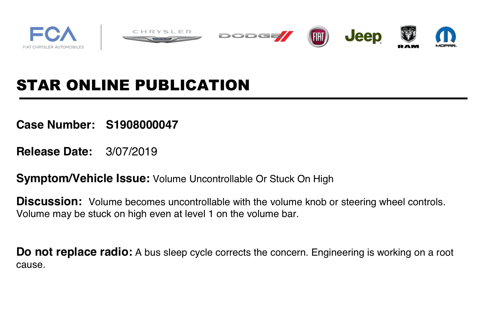

is yours stuck at a certain volume and you cannot change it? if so, switching to AM radio and back should fix it.
or does your volume knob increase the volume, but it is significantly quieter than it should be?
For this one, I am still having the issue, but only with the doors off. If I remember to turn on accessory before start, I never have the issue.
My GPS stopped working correctly, so my radio being replaced next week. We will see if that fixes it.
