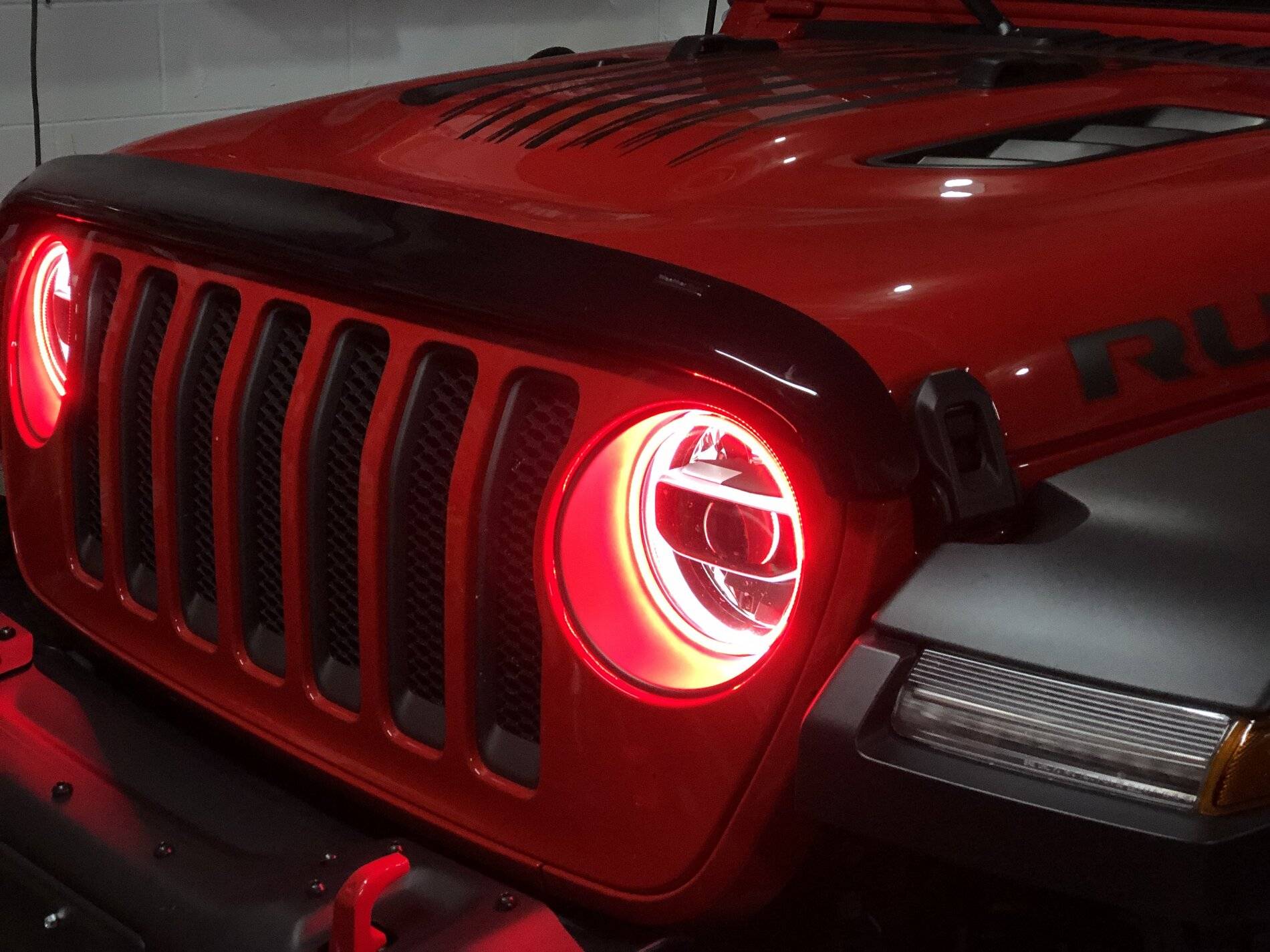

One of the driver boxes is about 30-32" from the antenna, I did try moving it around a little to see if it made a difference, but no luck. The other driver box is on the opposite side of the vehicle... I'll try twisting the wires together to see if that helps also.

i’m pretty sure moving the ground off of the fender and directly to the battery has solved the problem. I will know more in the coming days as we drive it more. But initial tests seem to be going well. I did go ahead and put the Ferrite clamp around the ground and the positive wire just in case
