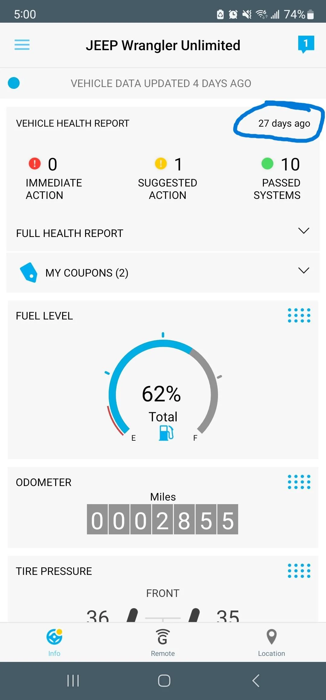

One thing to note, if you get vehicle reports they stop when plugged in.
I do get vehicle reports. Interesting
What about your install. Did u disconnect batteries?
I did not disconnect, last time I reconnected I had the key with me also. But I did let the Jeep go to sleep on original install and no lights.
Weird my health reports never show up with ODB plugged in.

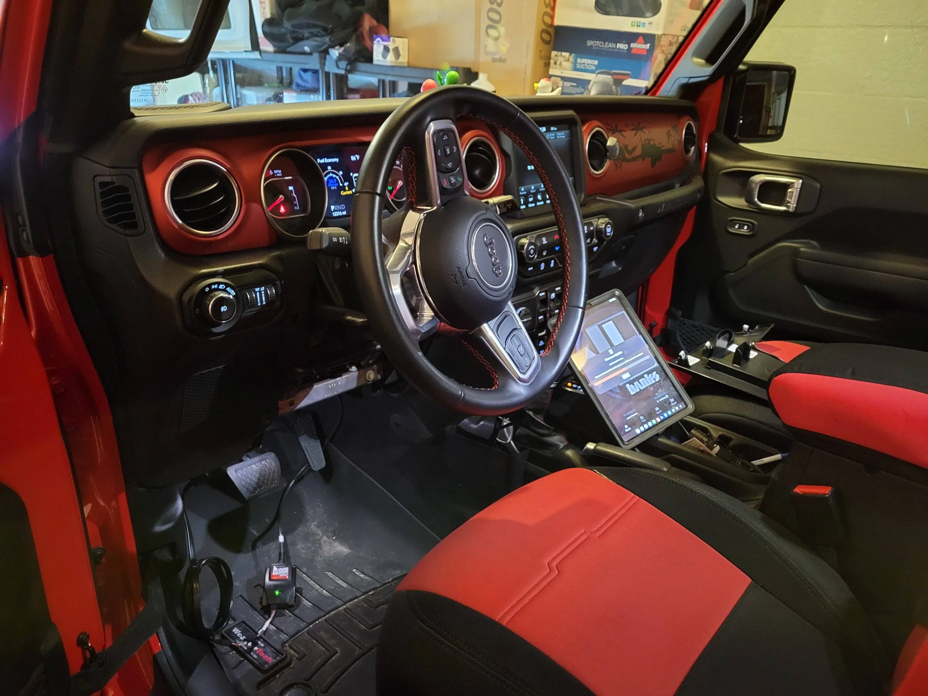

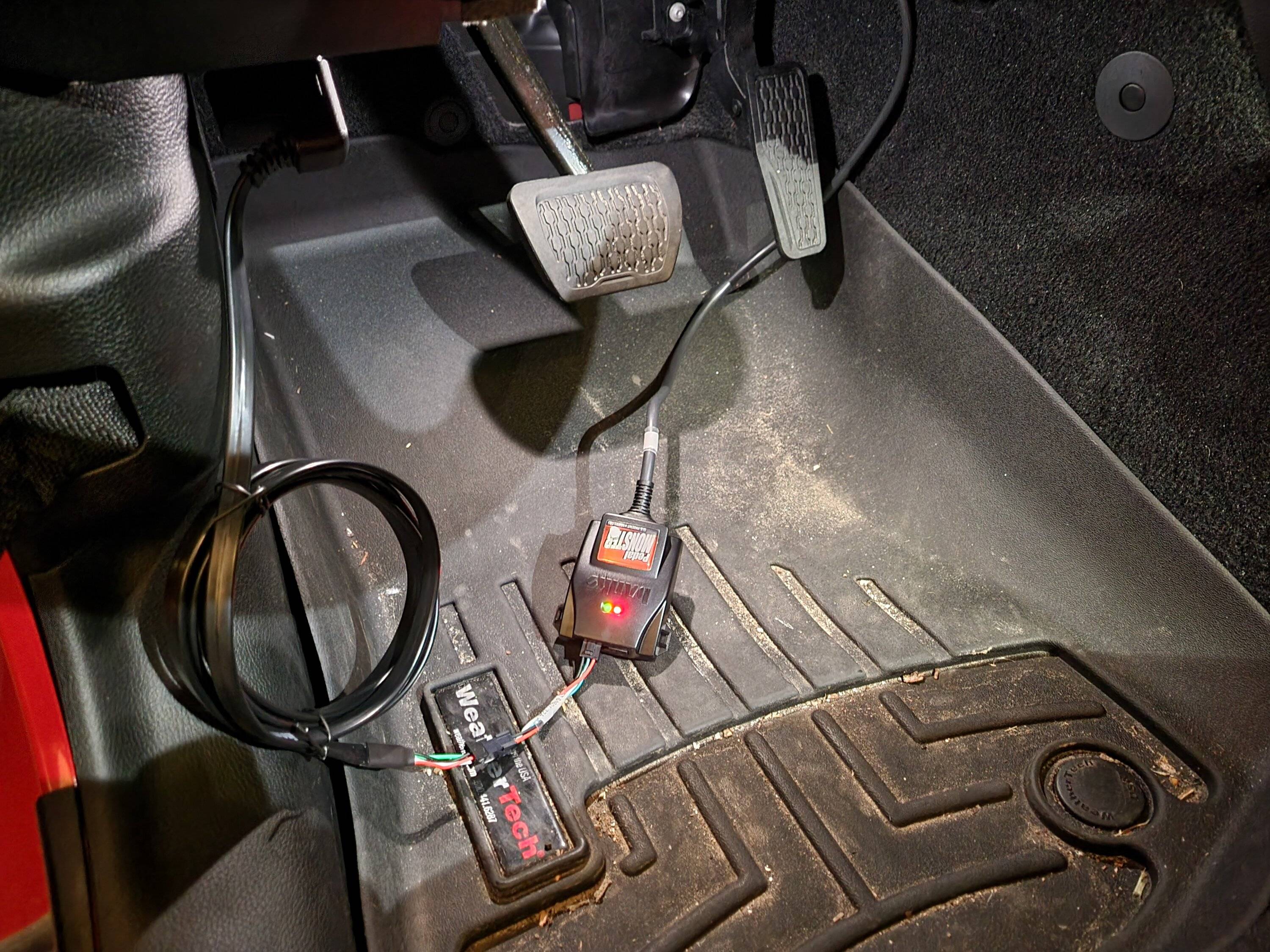

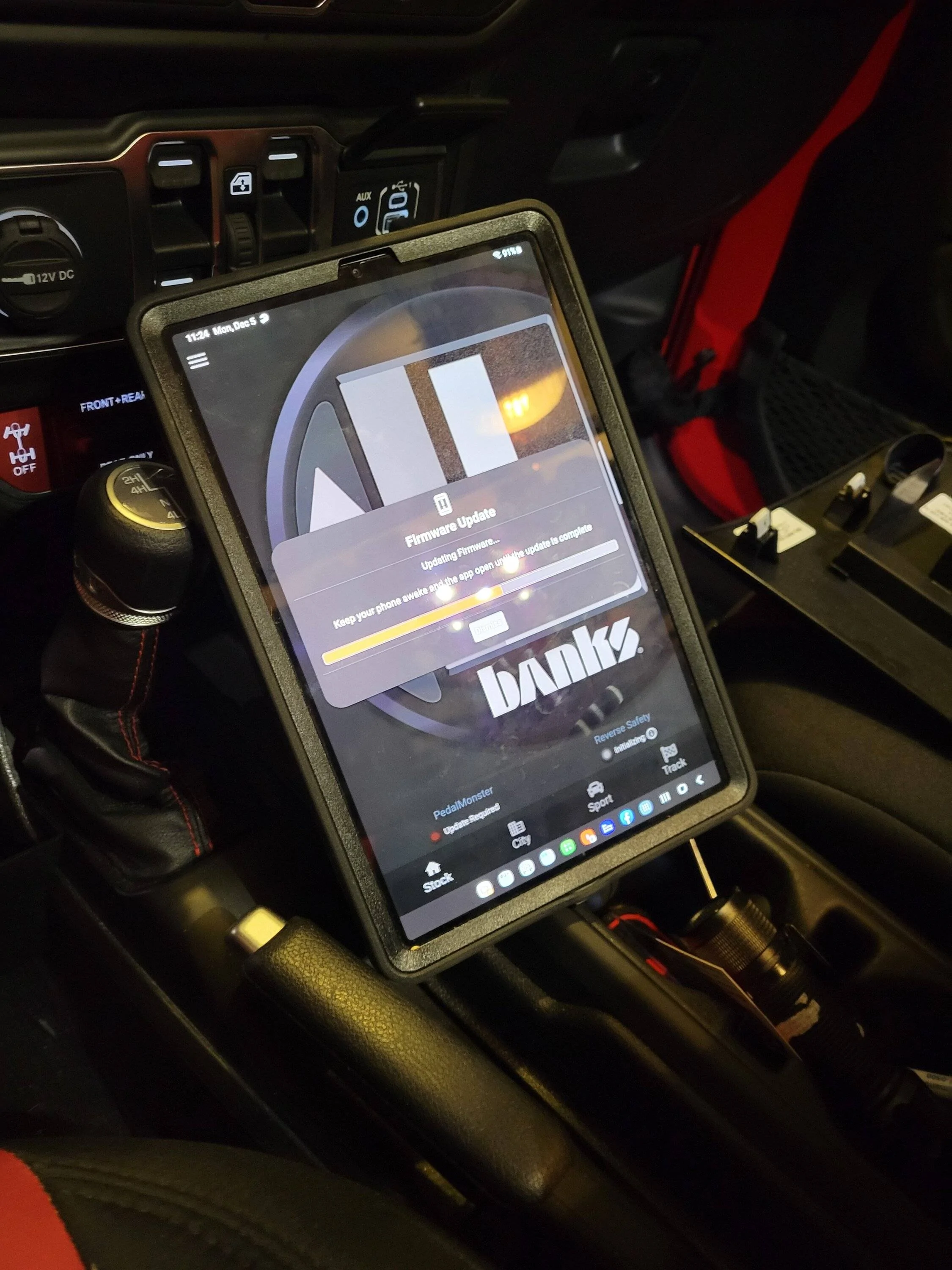

Update. Thanks All
I figured out method #2
Turn off vehicle, open door 10 minutes before install
Installed and tested. I had something called Diesel Warming light pop up, then has disappeared since. Never seen that before. Hoping it's the only indicator issue
Only tested around the block so far.
