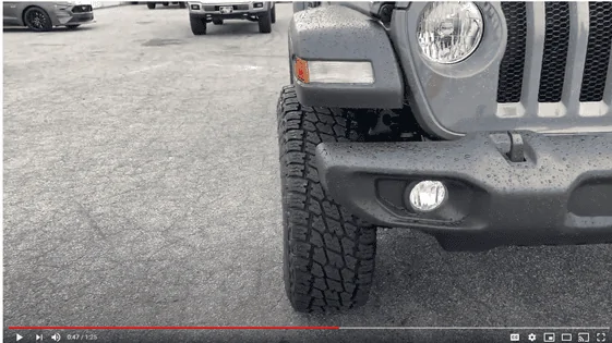

Hi All... getting my 20 Willys setup with 35x12.5x17 (17x9) and a 2.5" JKS lift. I want the tires to stick out past the fenders a little but not too much. I've seen some videos/pics that make it appear that the +1 offset will let them go past maybe an inch or so which is good w/me.
I like how it looks in the screenshot below which is supposedly 0 offset, but it's also at an angle. Just want to confirm since the pics and videos aren't always clear.
I figured if it wasn't far out enough I could add 1/2 inch spacers... is that reasonable or are there reasons why I wouldn't want to do that? Thanks.

What size tire are you planning to run? You can go with less offset with larger tires and still maintain the same scrub radius due to camber angle. You will also need less offset with larger/wider tires to keep them from rubbing at full lock/stuff.

Hi terruta.... I went with the +1 and couldn't be happier. The tires stick out just enough and pretty much match what the video shows. Maybe 1/2 to 3/4 tread if that makes sense. JKS recommended 5mm backspace, which is what the +1 offset had. For me... it's perfect.
