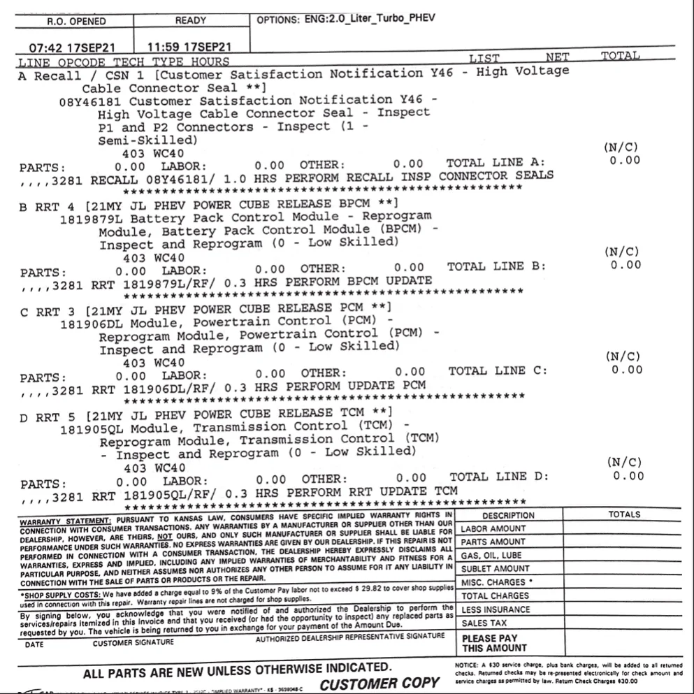

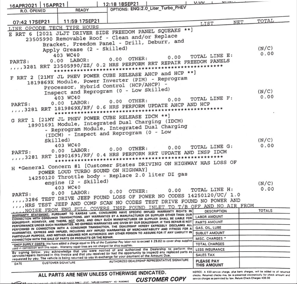

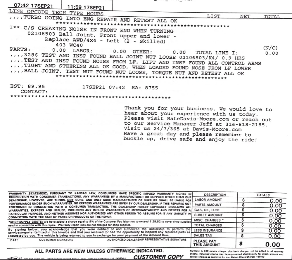

Nope! They didn't mention it and my paperwork didn't say anything about the gas cap tether. I can attach my paperwork if people are interested in seeing what all they did.

Yes, please. My service writer didn't tell me everything they were going to do.

@BluJay Wow, what a list. Is everything functioning as well or better since the recall work? I had no issues before I took it in for the recall and I'd hate to have issues now. How long did they keep it? Mine has been in 2 days so far. Supposedly because they had to order the recall part and missed the cutoff on Tuesday to order.

My 4xe is sitting at the dealership waiting for me to pick it up this Saturday, and left the factory 3 weeks prior. They are obliged to do all that prior to my delivery, right? I know its not recall work, but do they have to wait for me to complain or will they do all that proactively?

Correct. They should be applying the RRT's before delivery.
