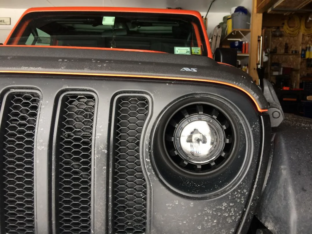

How do you even know they’re centered properly? It seems once they are installed you can’t access or adjust them further other than the rear beam adjustments.
You honestly dont, I am just making it look close enough with the eyeball gauge and calling it a day. Trucklites are known to stick out a tad further than most lights as well so that adds to the battle. Both are shoved in the buckets, went to connect everything and the plugs on the trucklite anti flicker has an extra nub keeping it from plugging in to the supplied adapters, MORE filing! At this point I wish I would have driven over to Quake and handed them my card and been done with it. I'm not bashing the adapters as its early and theres bound to be issues with all the different options out there but they are not trucklite friendly, get the super sevens haha.

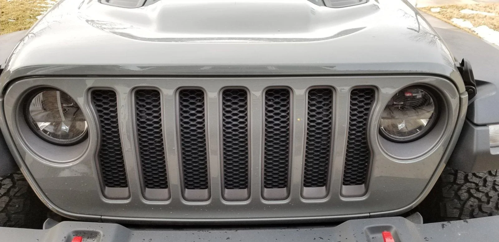

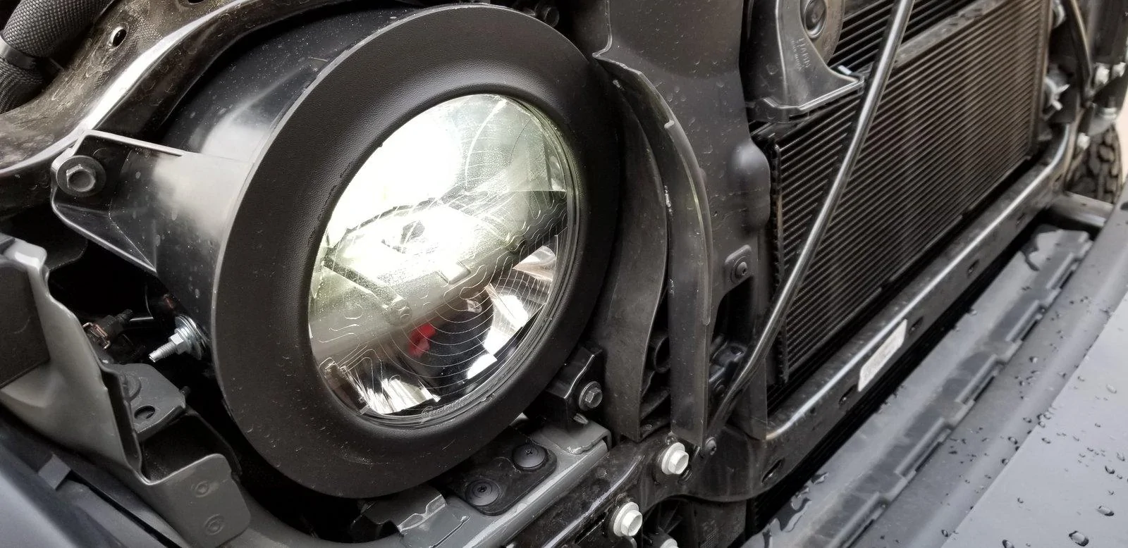

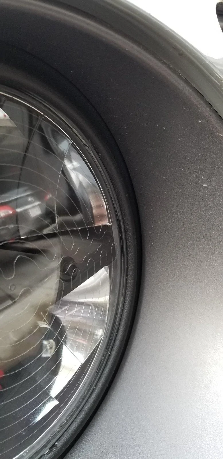

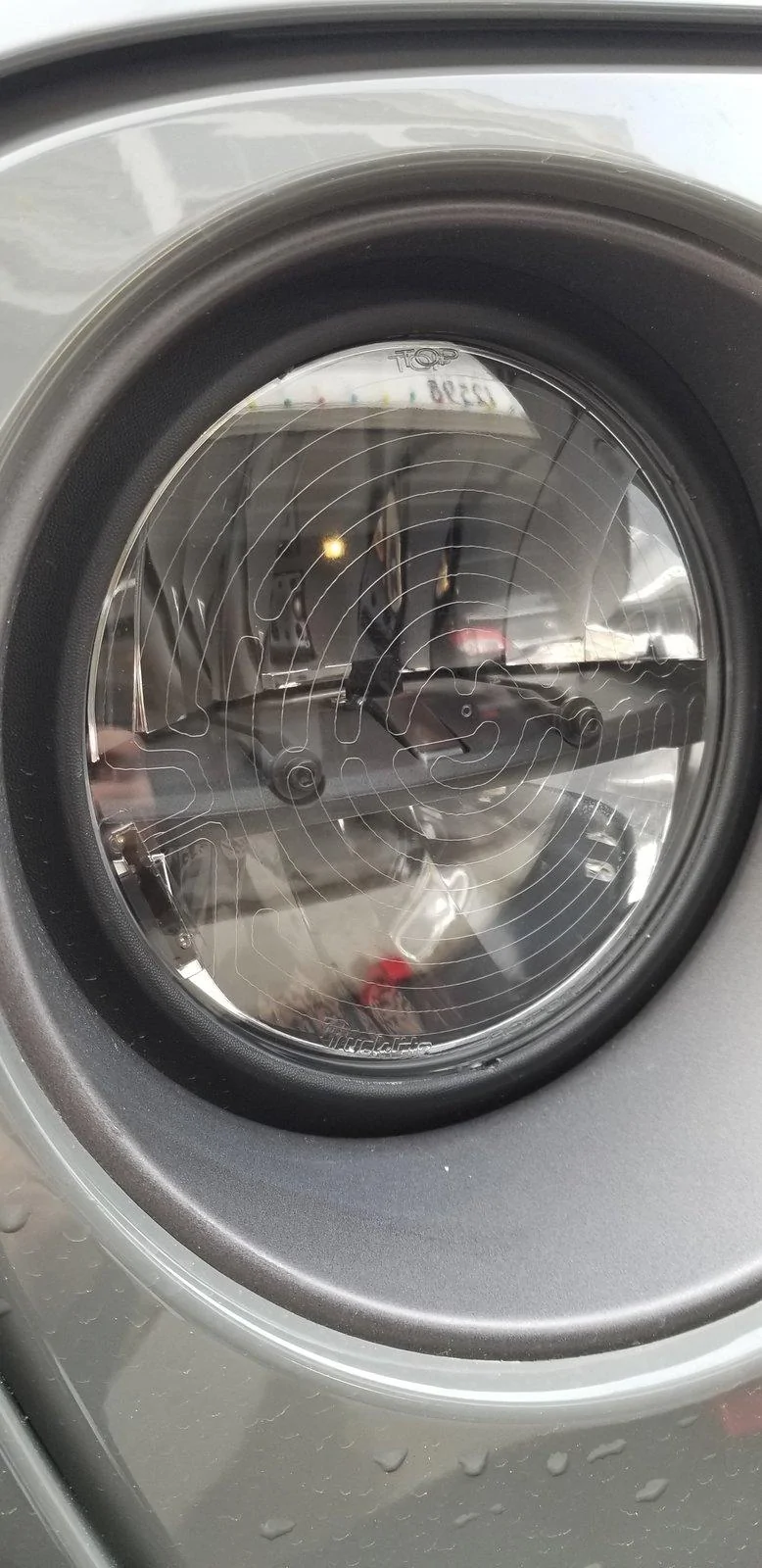

Done! All aimed up and everything, I took a few pics so you all could see how the gaps are filled, lots of work but worth it to me. Tonight I throw in my jw fogs which looks to be a LOT easier!
Glad that it all worked out. They look awesome. I did fogs and they were really easy. Now that I think I know what my problem was, POLARITY.... I think I can finish my install tomorrow. Nice job. And aiming worked ok too? Thanks for sharing.

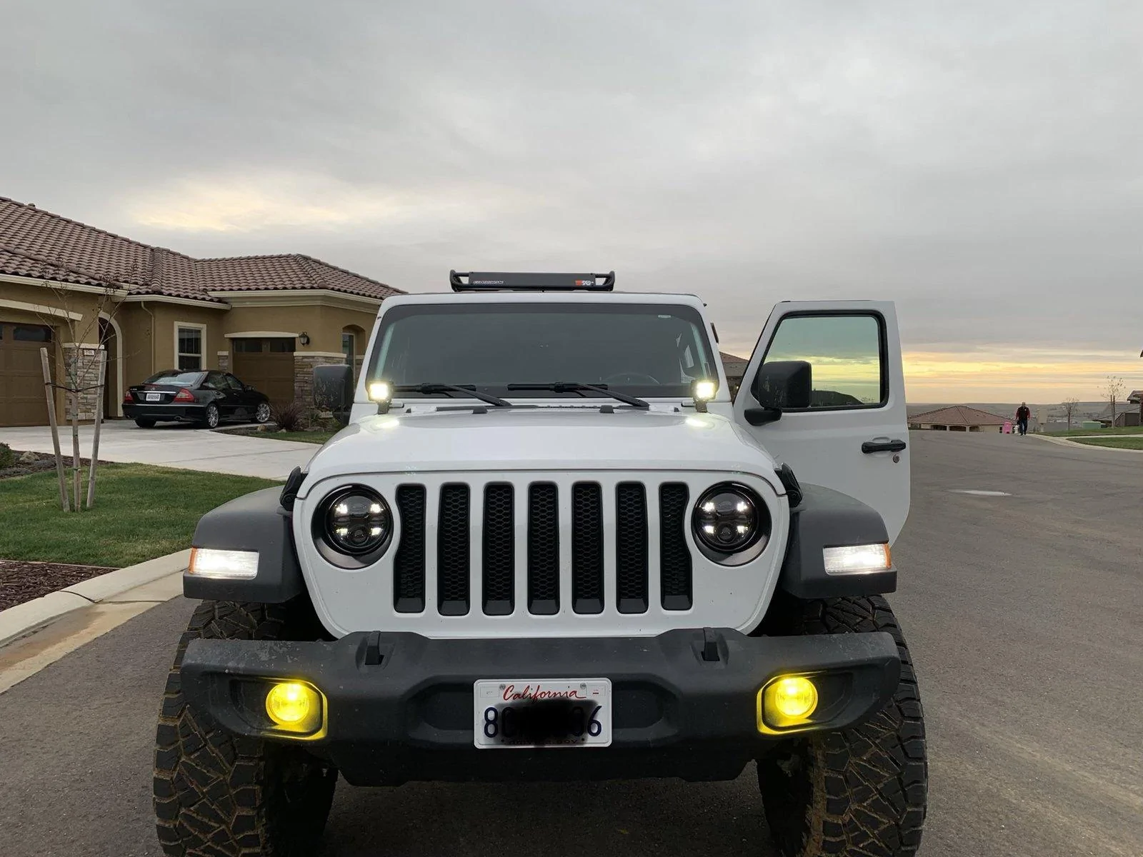

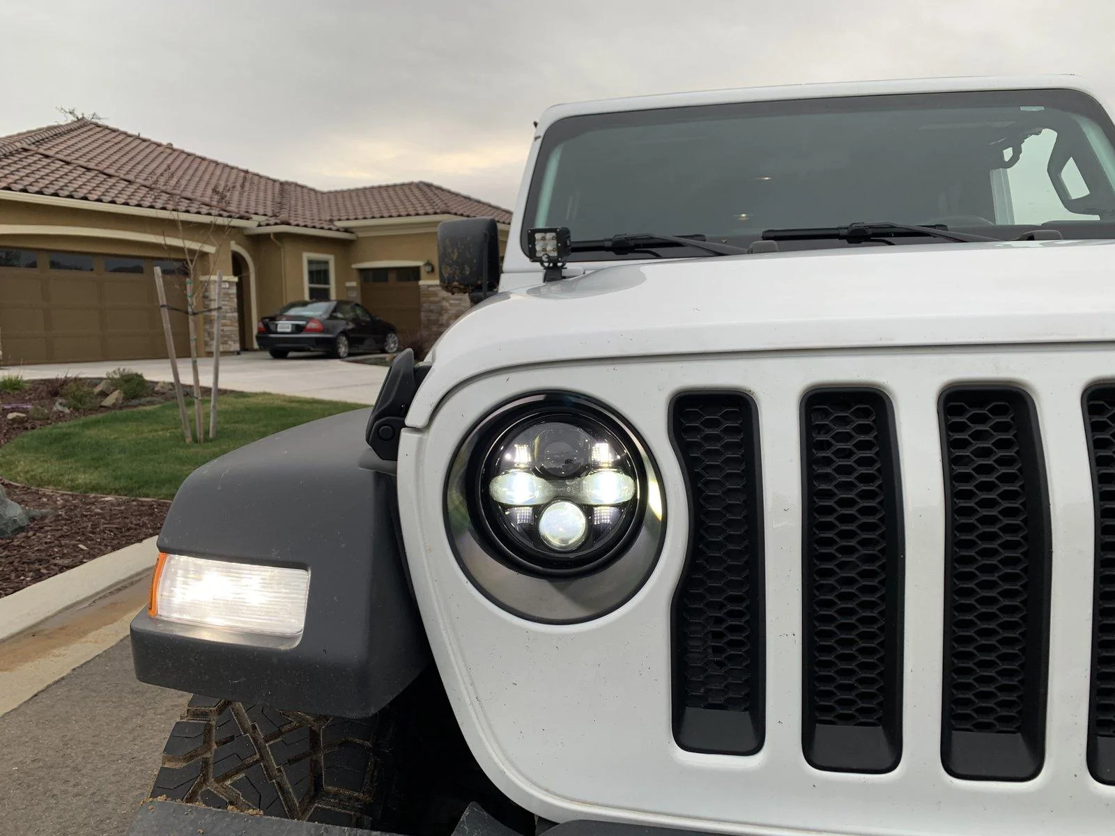

Just finished mine too, morimoto sealed 7 2.0’s went in super easy and all connectors were just fine no trimming or cutting! Now in need to wait till it’s dark to try and aim them, how do the rear adjusters work? (Which one does side to side and which one up and down)?

Very nice! These are my favorite headlights

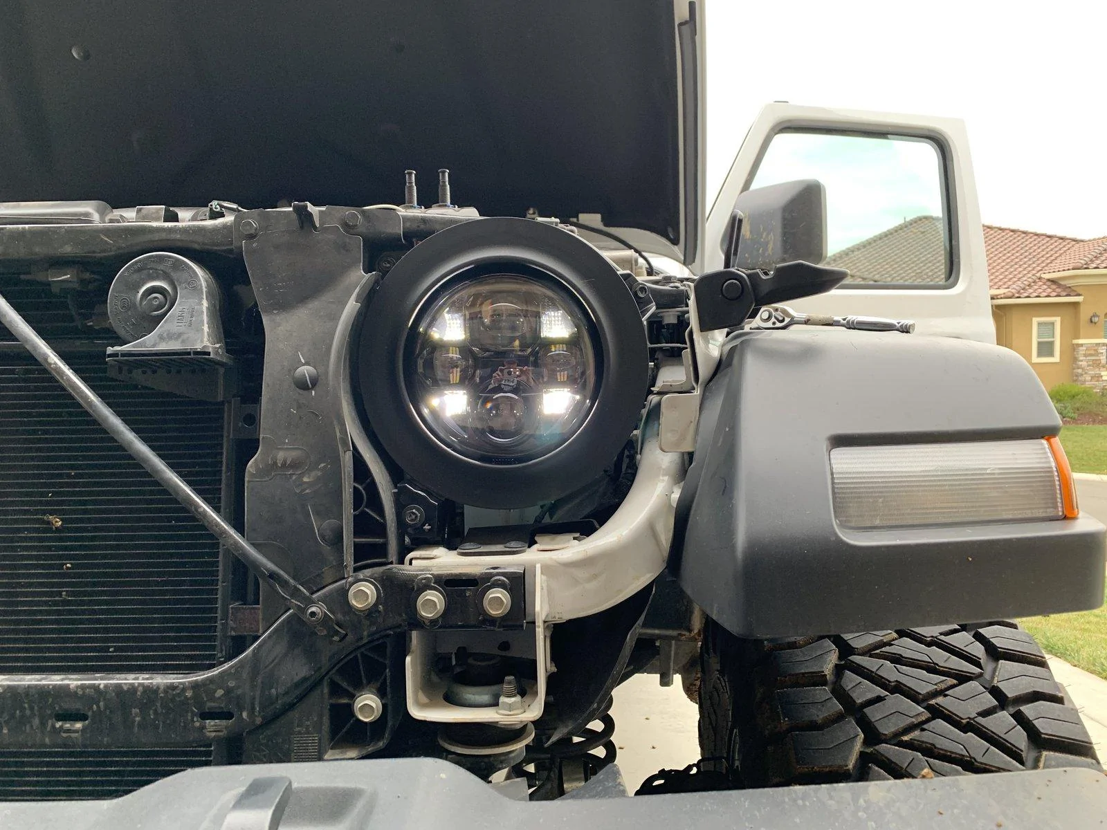

Finally got the lights installed. However when I turn on the high beams the lights go off....Got to improve my electrical knowledge base. My original headlights with LED bulbs did work but now with the new headlights (super 7's) the above problem. SO much for plug and play. Calling TRS Monday AM....I do like the look of these and hope I can get them working....

Mine did that before. Check the pins and the connectors. I did that and zip tied them securely and so far it seems good to go :fingerscrossed:
