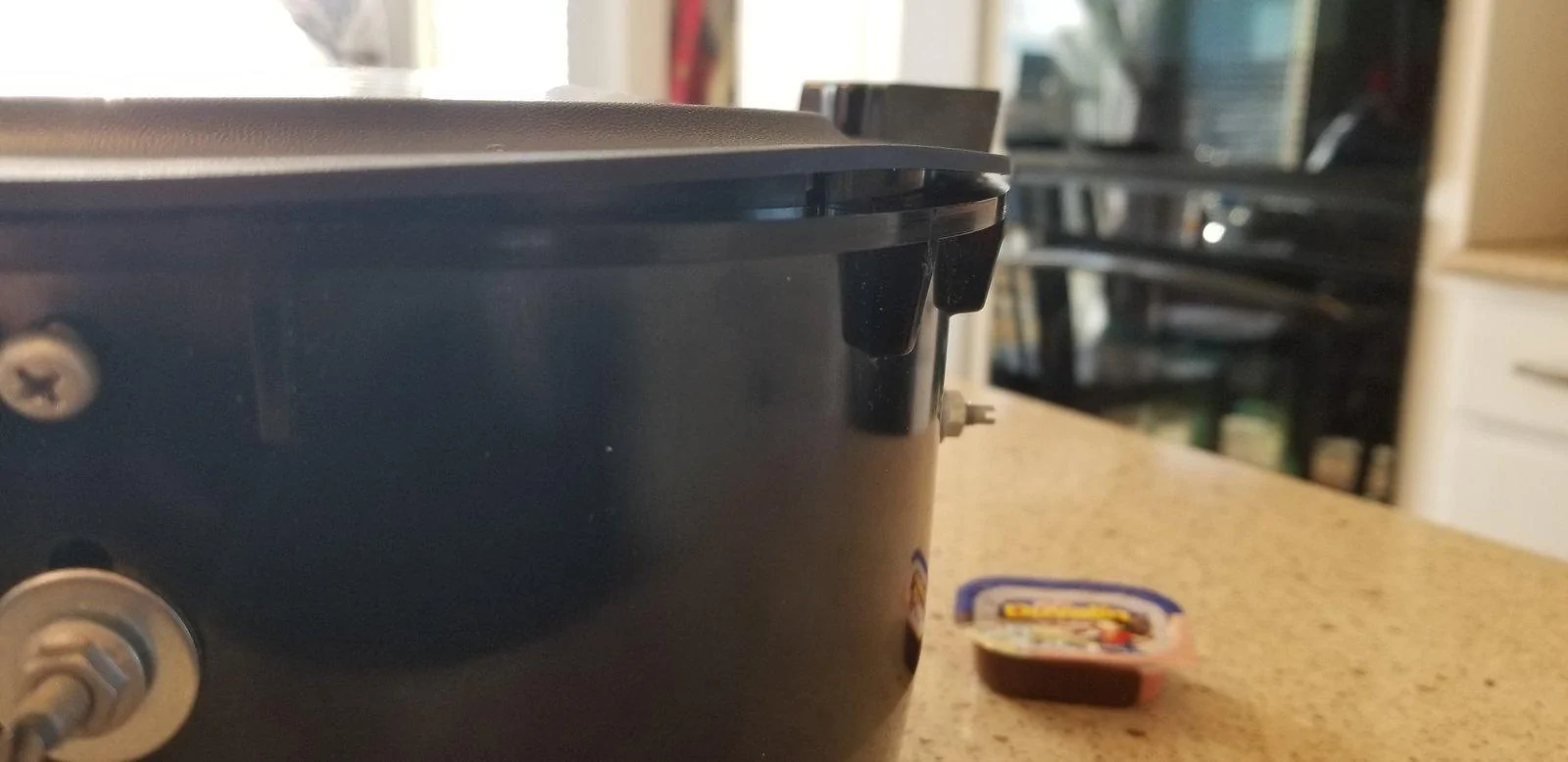

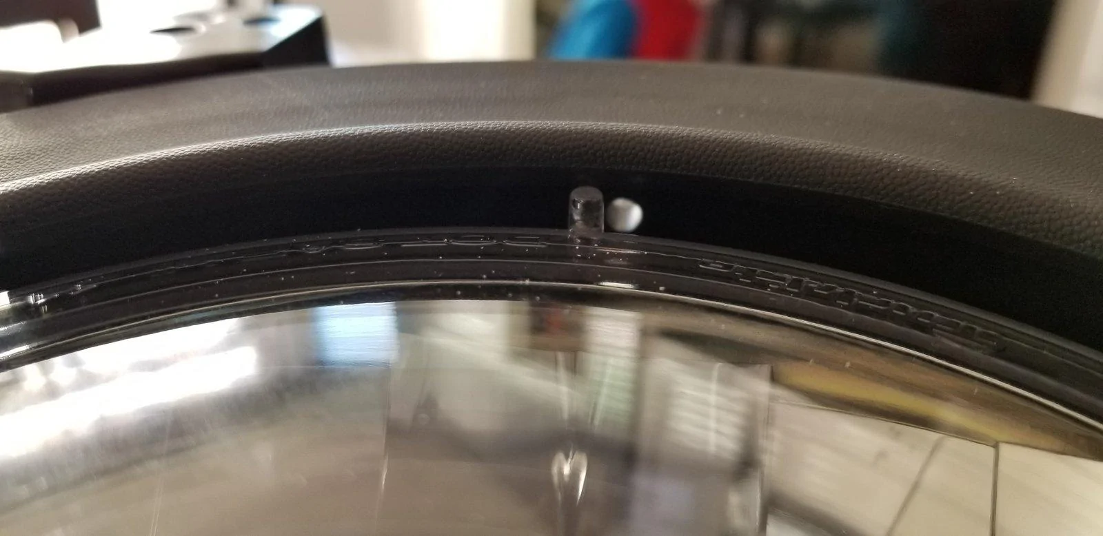

Got my adapters in, one problem if you're thinking of using trucklites. The lights have these three nubs that keep the trim ring from setting flush with the light. I'm currently grinding them down to get everything seated properly.
Any advice, tips, or pointers for installing the lights in these damn adapters? Lol
what are the side and rear adjuster screws for and how did you set yours up? Seems side adjusters just center the light, what about rear(fine tune) TIA
I finally have more time to play with them more tomorrow. I'll let you know for sure, I still have to grind the nubs off the other light and then I'll get to mount them.

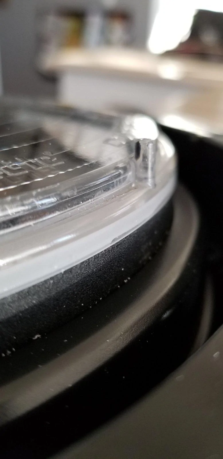

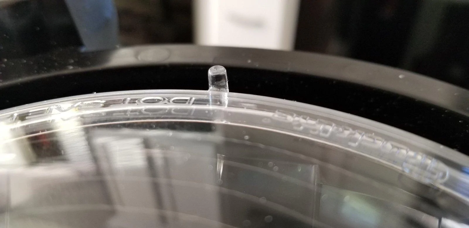

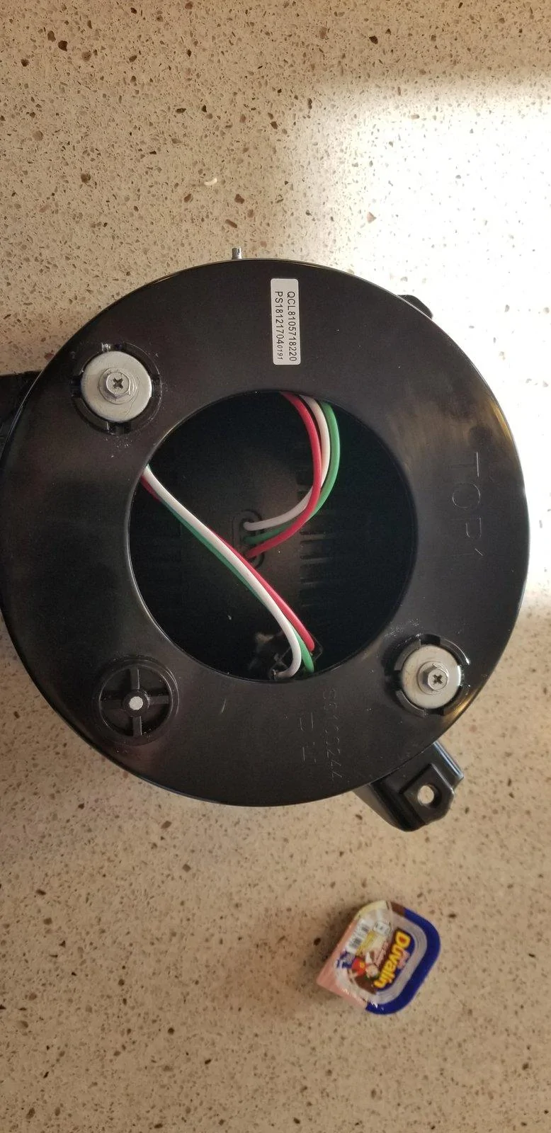

So the three screws are for centering the light within the adapter, and the rear are for beam adjustment. I filed the ever living crap out of the nubs to get the top ring to fit but I'm having trouble getting it flush, when it's completely level the trim ring is not even close to fitting, when it is flush its pointing so off center the top of the light is covered and the bottom lip of the light is sticking up.
How do you even know they’re centered properly? It seems once they are installed you can’t access or adjust them further other than the rear beam adjustments.

I am with you and what is to say that they may not shift once you make adjustment. I am not real happy with the whole design. Disappointed to say the least. Especially not for the price.
