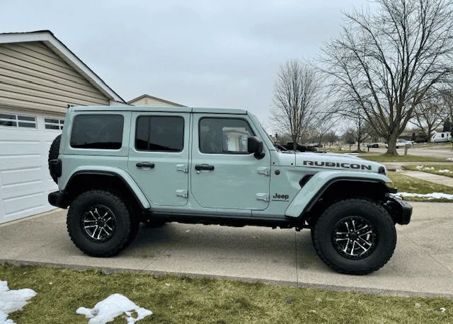

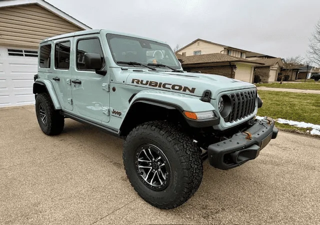

Got the first wash today and they put the decals back on. Everything looks great and PPF adhered great. Crap day so you can't see how shiny she is. You can see a little snow reflection and a bit of the rubicon decal on the fender though. Impressive for this overcast day and this color..
Jeep Wrangler JL PPF and ceramic coat 1706808157000
Jeep Wrangler JL PPF and ceramic coat 1706808109798
