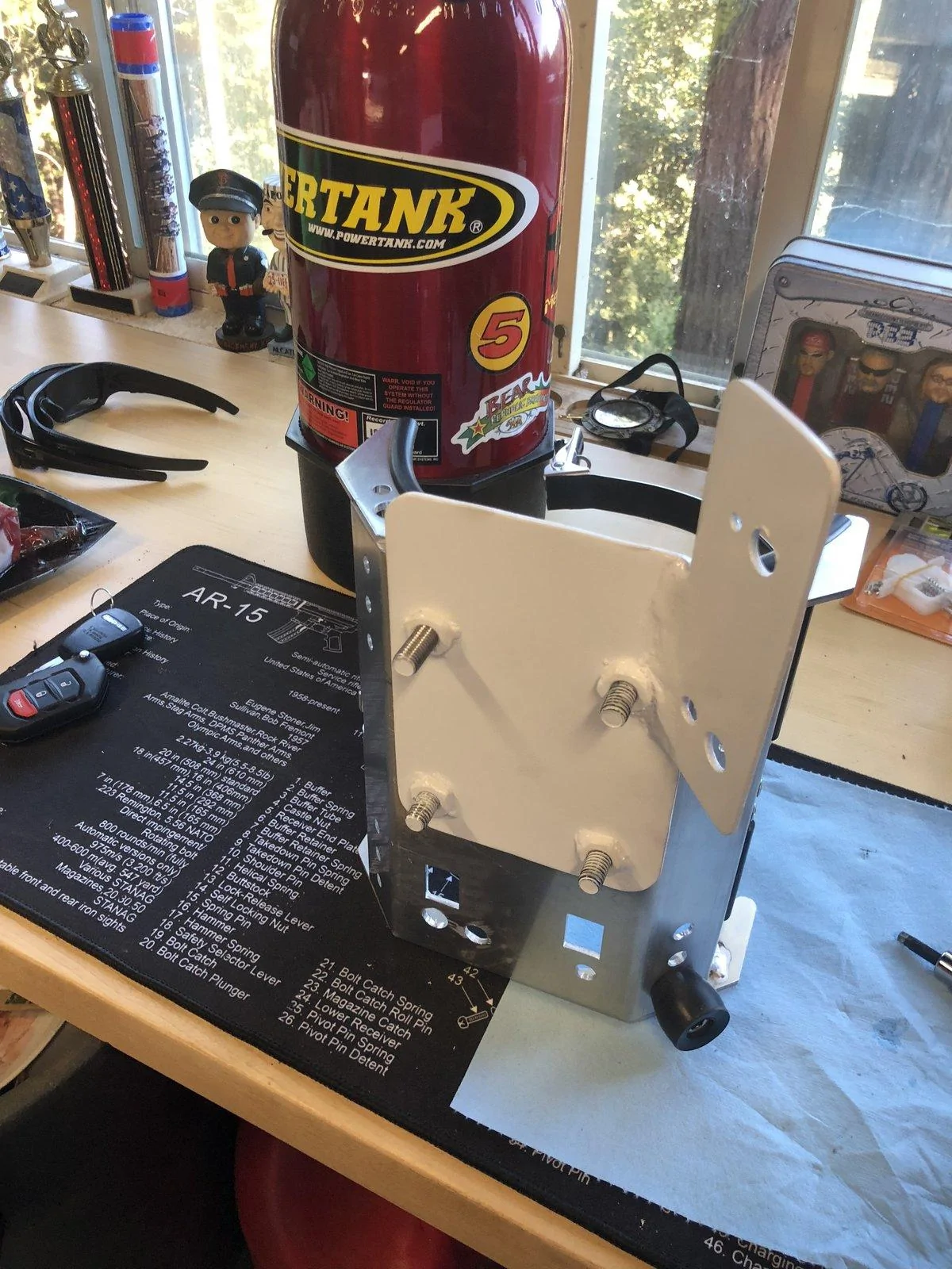

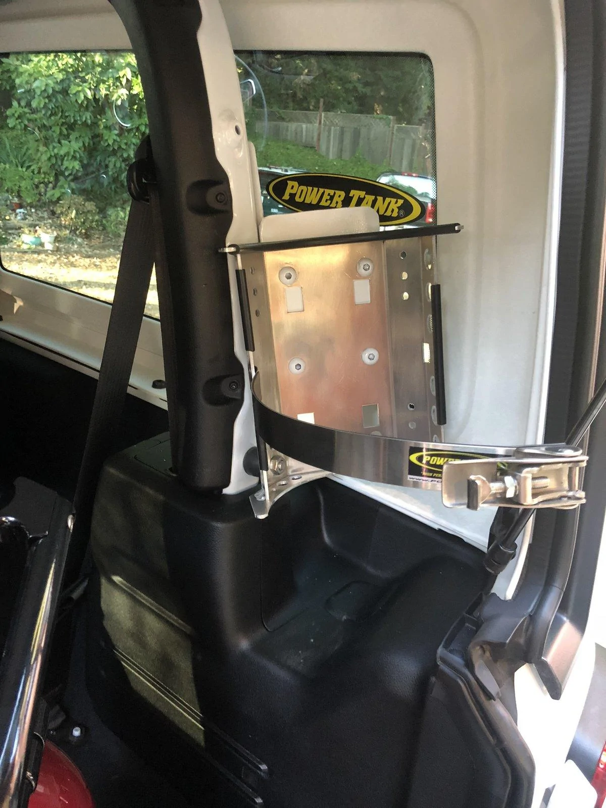

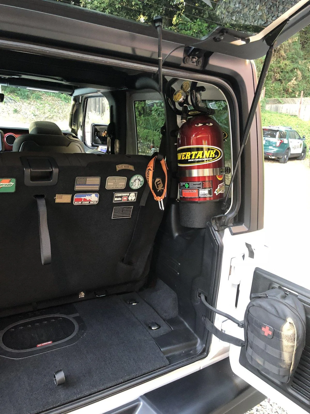

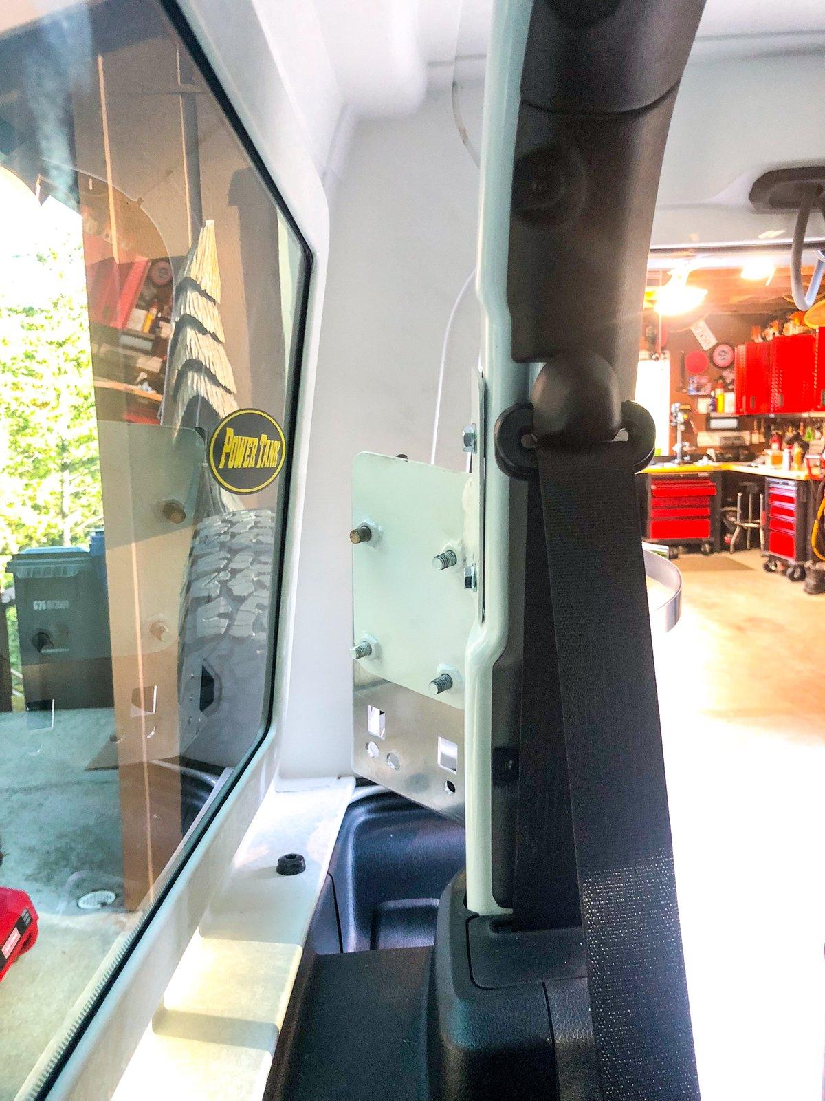

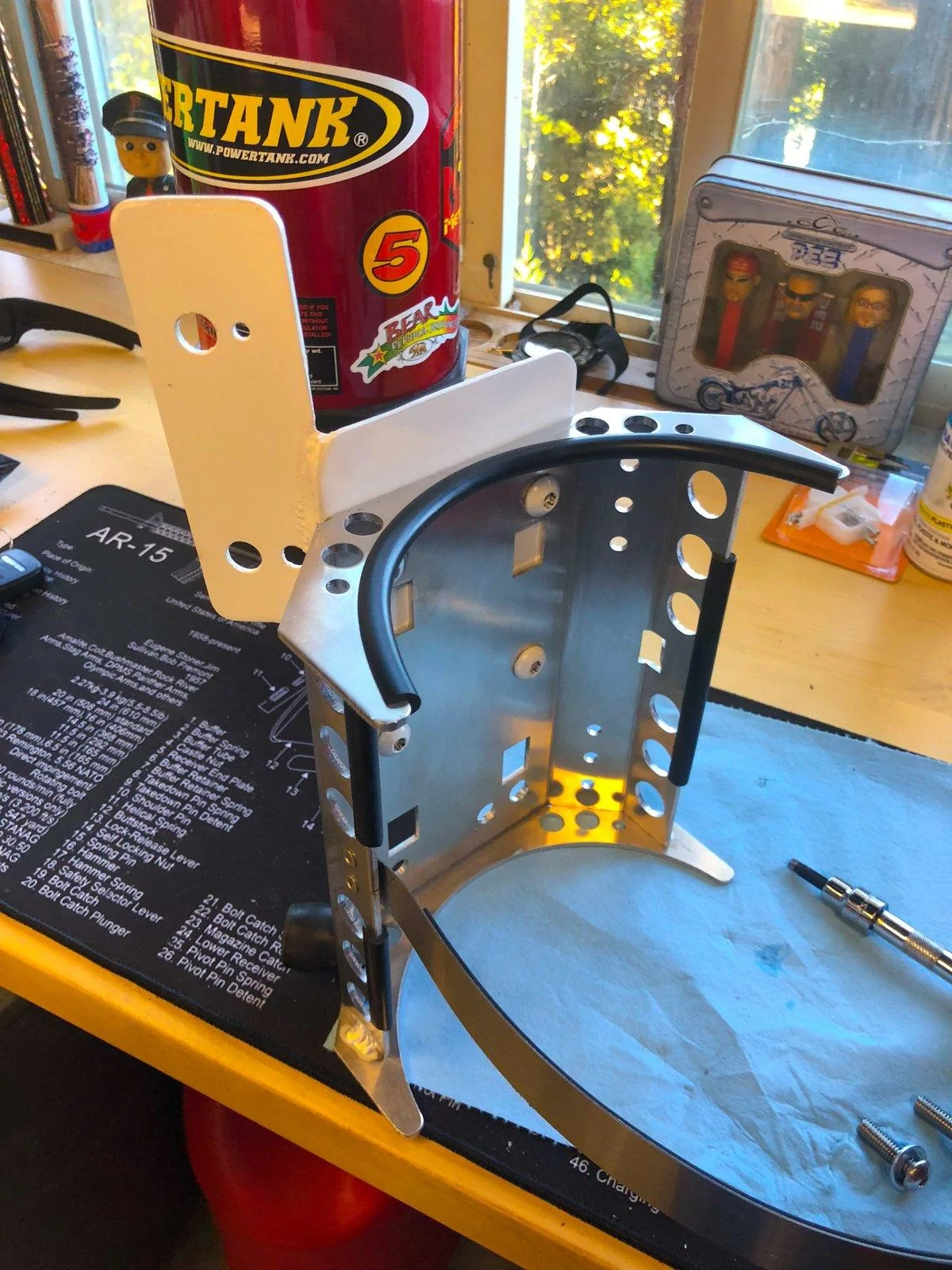

Been a while since I posted. Life gets busy. So here’s my solution to getting a good mounting location for my powertank that helped maximize the space in my 2 door. I used the stock soft top mounting holes and fabricated and welded a bracket to get the powertank cage to mount at the right angle and off set. It was a tight fit and required some tweaking to get everything to work.

Looks good. You’ll love the powertank. I used one on my last dedicated trail rig. It ran the arb lockers and was also handy if I ever needed to set a bead. The rig got towed everywhere so rarely did I have to air up with it, but when i did, it was wayyyy quicker than my on-board compressor.
