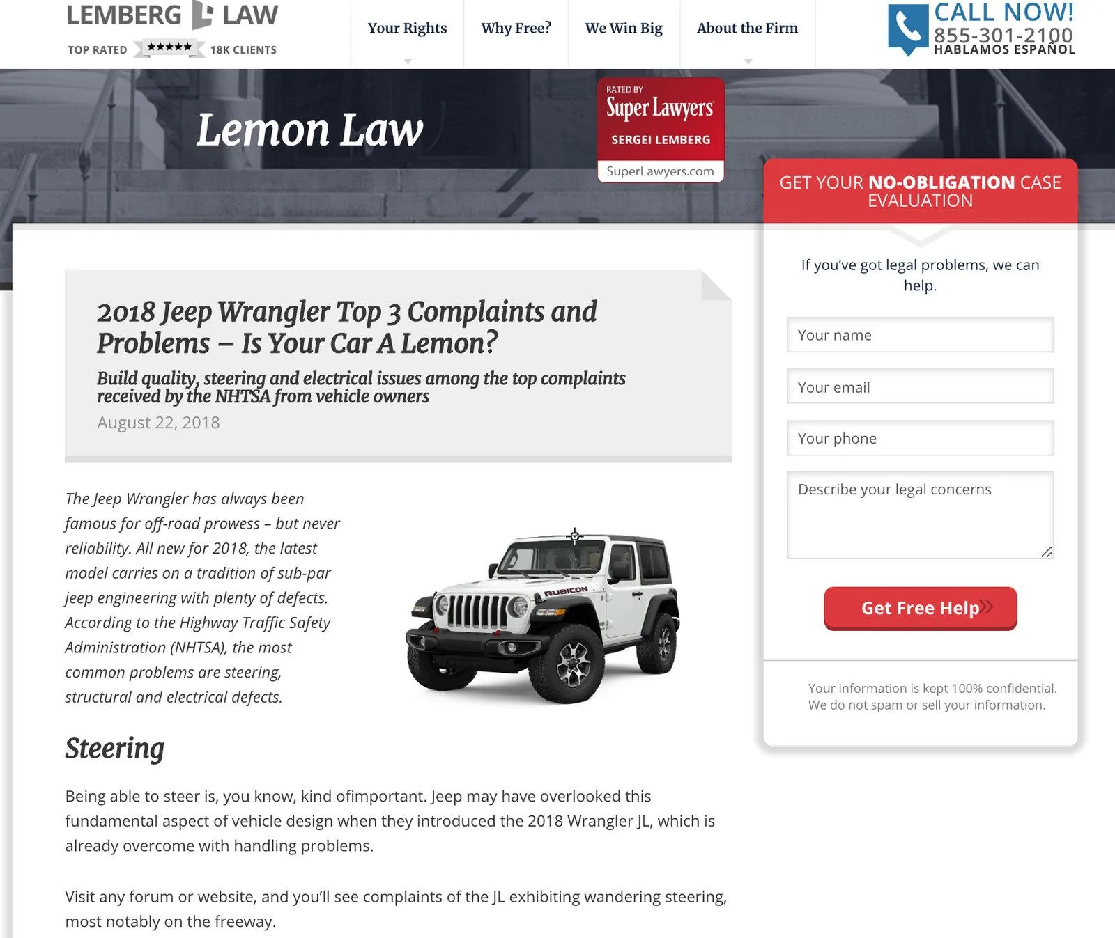

yes, lets sue and yet we complain about the cost of these rigs as FCA jacks the price another 1000 to cover the class action cost. LOL
Hmmm, I'd pay the $1,000 extra if my JLs steering didn't suck. Even my dealership confirmed there is a steering problem and that it is NOT a Jeep thing.
