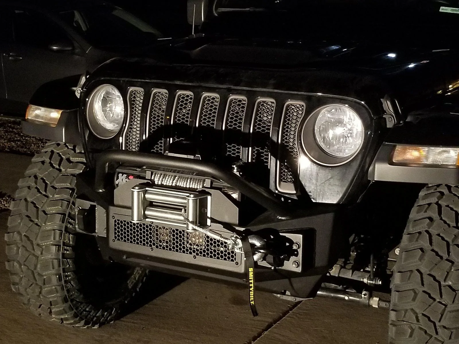

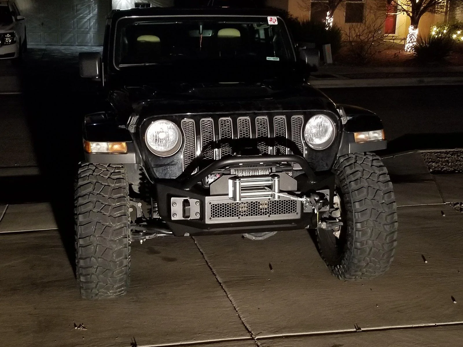

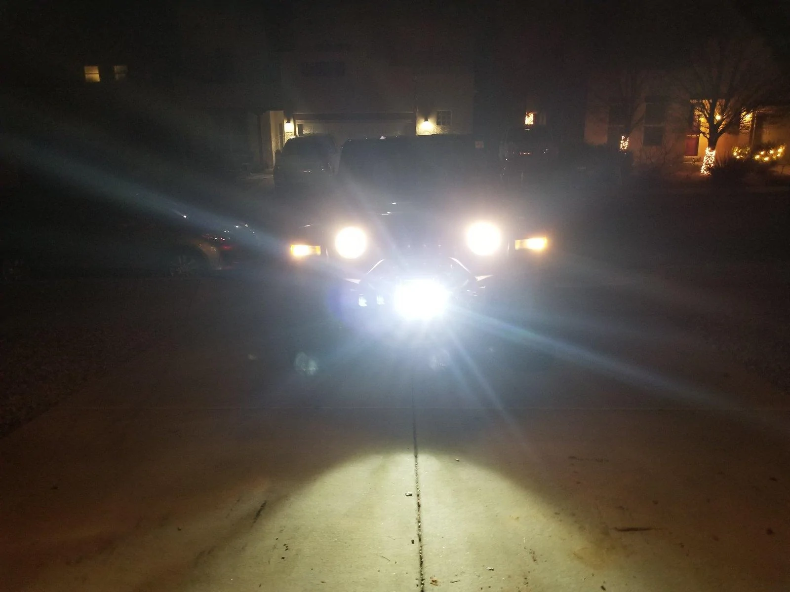

Installed the Go Rhino stubby front bumper and two @InspiredEngineering cube lights with plug and play floods to replace the fogs. I had to remove the harness from the old plastic bumper for the plug and play to work, but it works like a charm by pushing the fog light button on the dash.
How are the fogs behind the mesh grill? Do they still look as good as the oem fogs?
I think they look and work great. There are four different places to bolt the the cubes to and with the kit they work with the oem fogs. I replaced the fogs with floods and put spots up higher.
