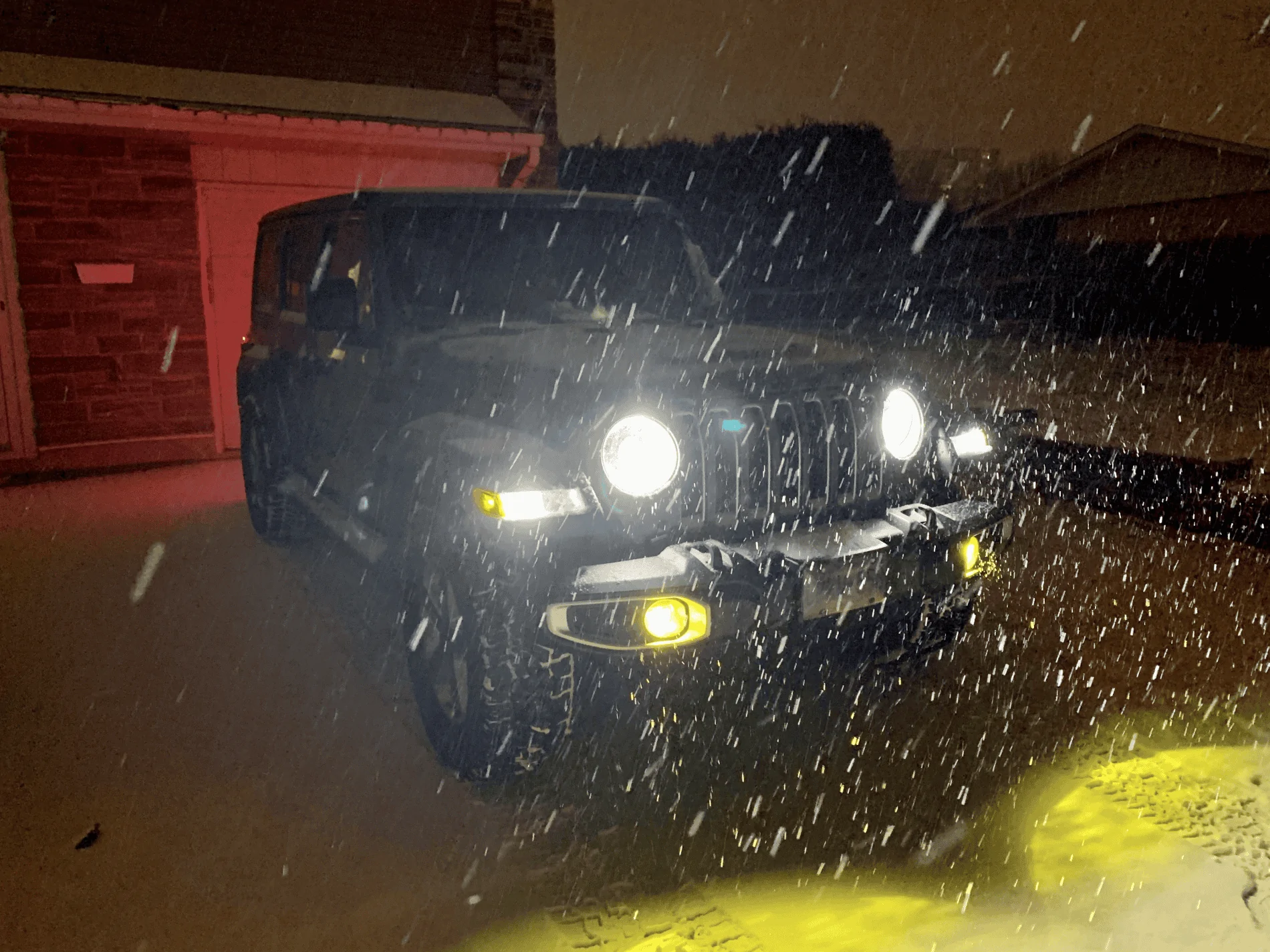

For those who are considering the OEM MOPAR LED FOG lights and installing them onto a vehicle that had halogen from the factory here is my experience:
Many websites claim 'plug and play' but this was not the case for me. I picked up some MOPAR led fog takeoffs from a Sahara with LED from the factory. When installed into my 2020 Sahara bumper with halogen from factory the fog lights would flicker at certain engine rpm settings (Very annoying). I have since fixed this by setting my fog lights to LED using JSCAN. In addition, the MOPAR fogs look great with the yellow LaminX film!
