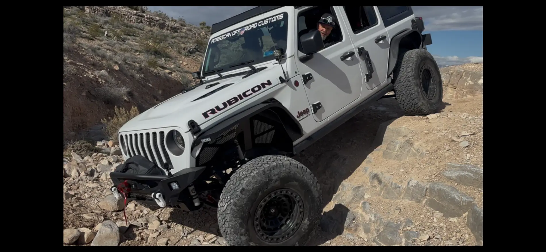

AEV dual sport RT 2.5"
Side note: A Rubicon can run full size 35's with minimal rubbing with no suspension alterations. I ran 35 inch Kenda Klever KR629 MT2's on my jlur for more than a year and wheeled it extensively, primarily rock crawling.
