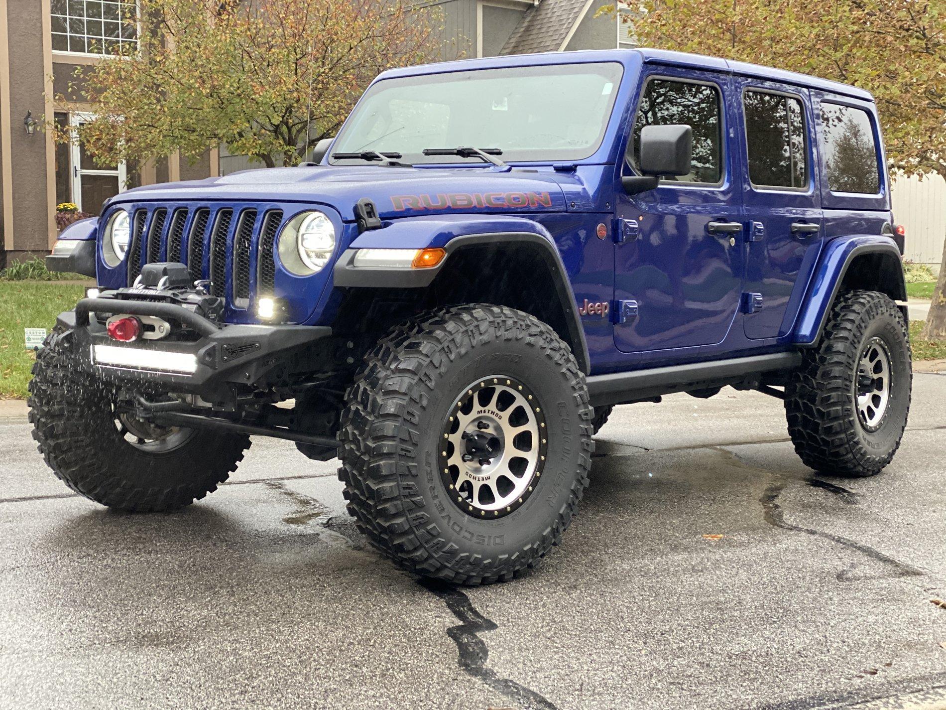

I have the rancho 2.5 with the 9000 adj shocks. Rides pretty much like factory. For the money and your needs I would say it’s hard to beat.
I added new trackbars, but they were not “needed”. Also added the rancho geometry brackets to bump up the castor after adding a spacer upfront to help with the bumper/winch sag. But once again, these add ons weren’t required. Just helped improve everything even more.

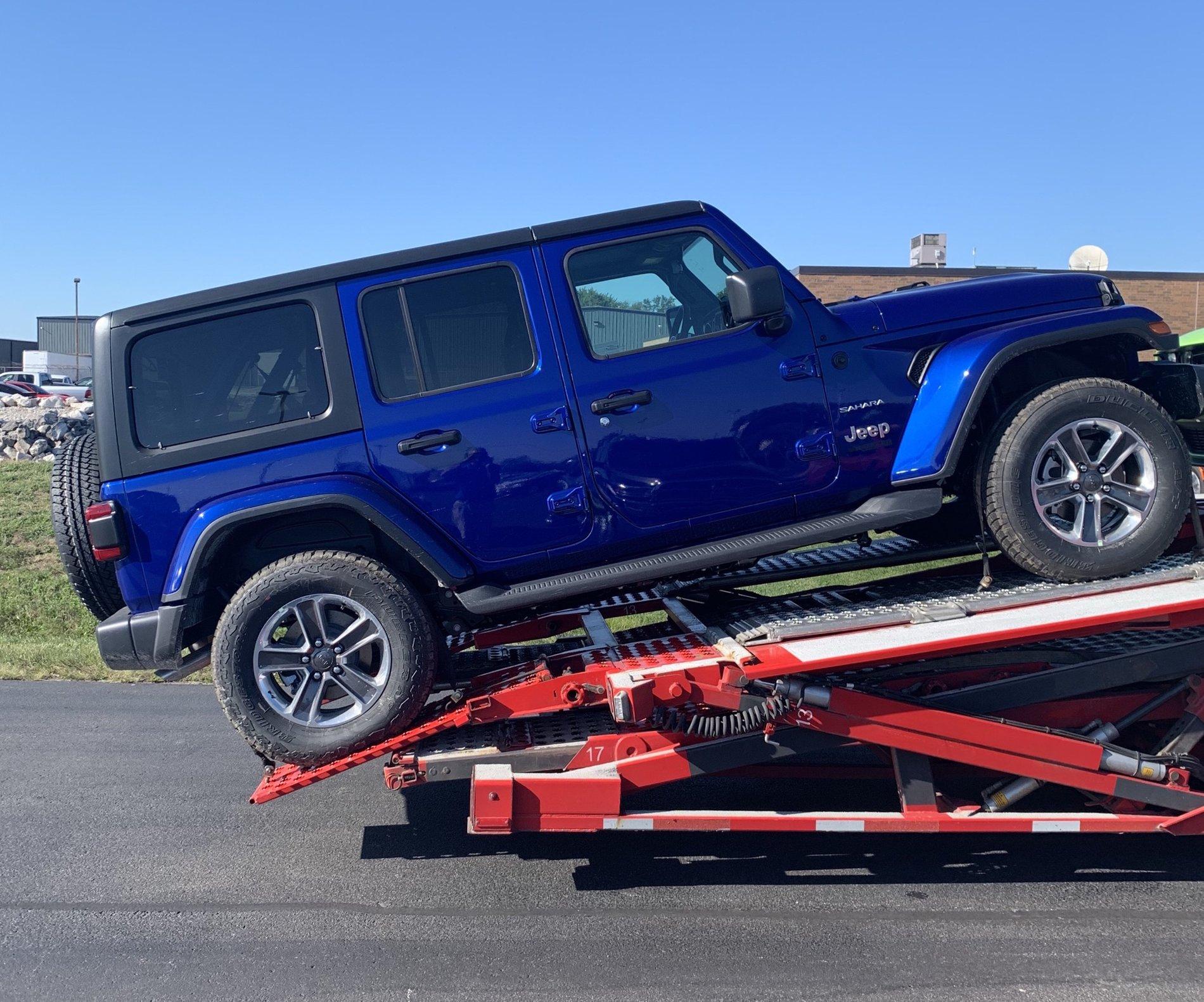

Additional info to the post above.
JLJP74 Ocean Blue Metallic 2.0L 4 Dr.
Ordered: 7/27/2019
Arrived at dealer: 9/4
I took delivery: 9/5
Added 2” Mopar lift, 20” wheels with 35” tires: 9/10. 35s are TOYO Open Country A/T II XTREME (35X12.50RTLT).
The Jeep rides really well. This is my DD. I transitioned from a Toyota Highlander. In my opinion the ride is comparable to how it was stock but rides slightly more rigid. This was my goal. So I am very pleased with it.
