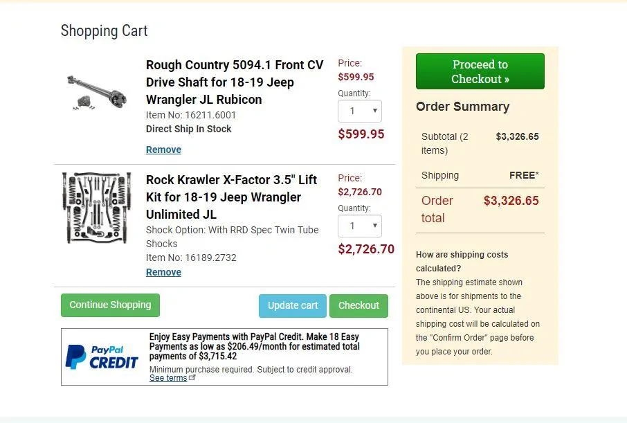

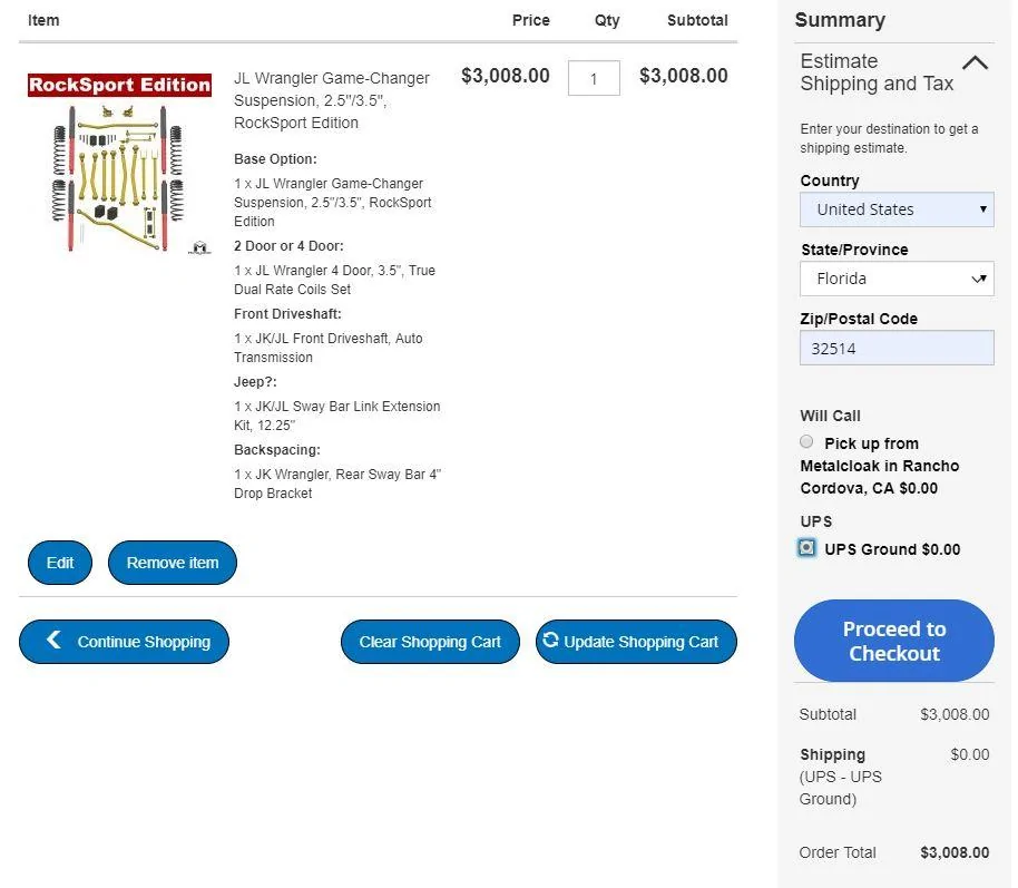

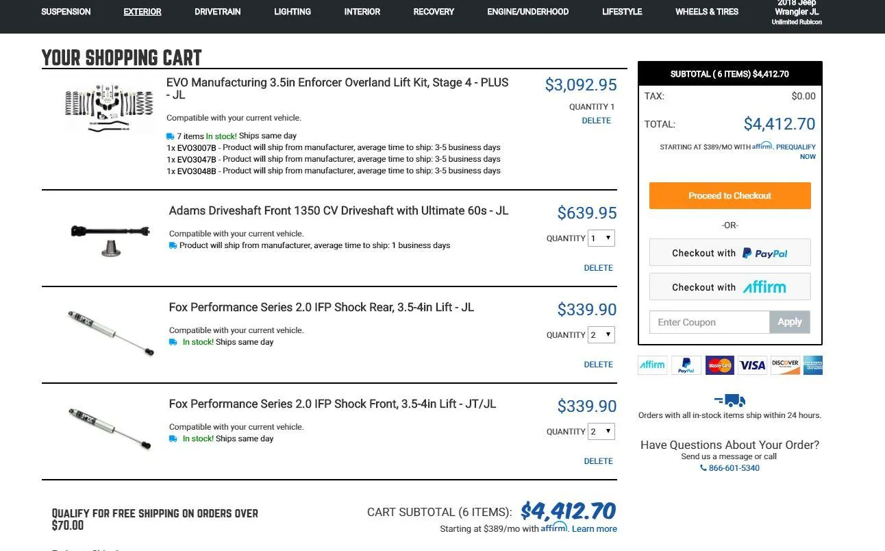

    I have been trying to decide between these three lifts for a while now. Evo we all know and its good just a lot more expensive. Rock Krawler is similar and has a life time warranty on hard parts and is about 1k cheaper. Metalcloak seems to be a little further ahead in the engineering and technology, but the warranty is not there comparatively. Here is my question how much articulation can I expect for the different kits comparatively with each other and which one would you buy and why when the prices differ this much for the same components?

    So I had the 3.5" x-factor on my JKUR, it's a solid kit and will do every thing you want it to do. Like JimLee said it will flex like crazy and adding limiting straps is a great idea. I say go RK and use the extra money for more jeep parts!!

    We install a bunch of metalcloak. I really like their kits! The only complaint I have and it’s relatively minor is the front track bar. To install it, you have to open up the axle side window because the head on the TB is so big. Its not a big deal but time consuming to make sure it’s nice and clean and ensuring it fits perfect. Besides that, they add in a bunch of things like the shock mounts and shock spacers.

    Could I get a little input on the lift? I have a 2018 JLu rubicon with a front steel bumper and which as of right now. I have a set of 37x12.50.17 goodyear mtrs in my garage ready to go on my stock wheels. if i go with the 2.5" xfactor will I get rub with spider trax spacers at full articulation with the 37's or do i need to go to the 3.5"
  13. Rock Krawler Suspension
    Rock Krawler Suspension Well-Known Member
    Rock Sponsor (Level 1)
    First Name:
    Tech Support
    Vehicle(s):
    Red JLUR, White JLUR, Yellow JL (3 so far), Bikini Diesel JLU, Billet JT, Hydro Blue JT
    Joined:
    Oct 15, 2017
    Location:
    Waterford New York
    Posts:
    452
    Liked:
    392
    With the 2.5" some trimming will be needed to flex 37's, the 3.5" is much better for someone who plans to do a fair bit of offroading on 37's with a Rubi.
