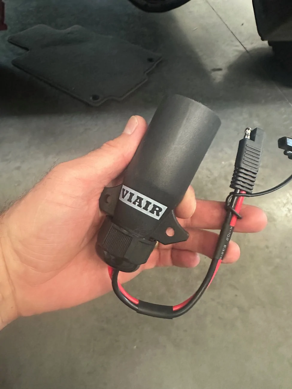

I use this with my 400P....works great and easier plugging into the 7pin then popping the hood....some will say they don't work but it has been flawless for me....
