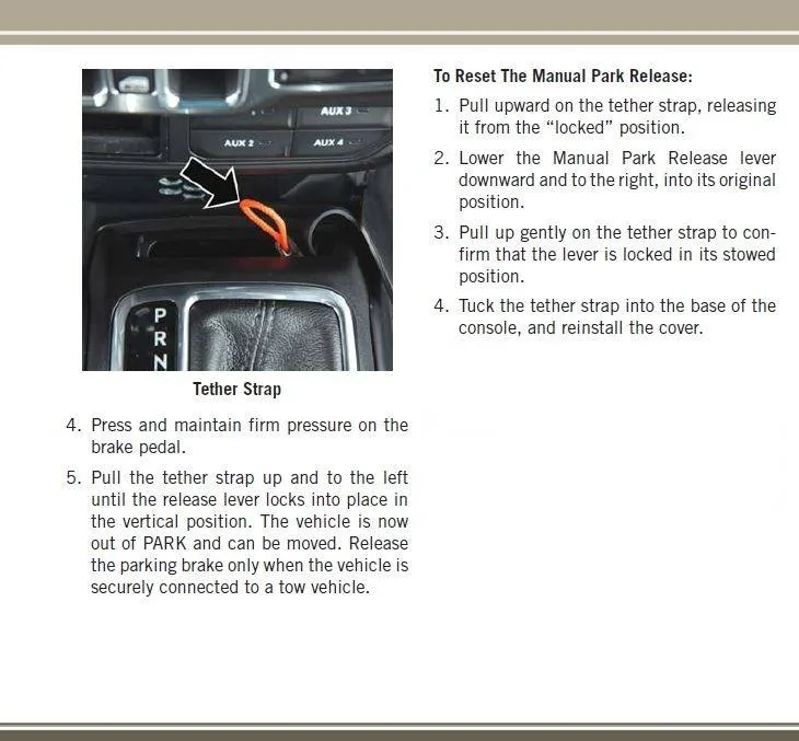

If it needs to go to the dealership ....You MUST specifically tell the agent that answers, that the owner's manual says Flat Bed only or you may very well not have a flat bed truck show up. Anyway, do not tow it, Flatbed it.
Note: If you cannot get the JL out of park so it can be winched onto the Flat bad, follow the info in this ..
