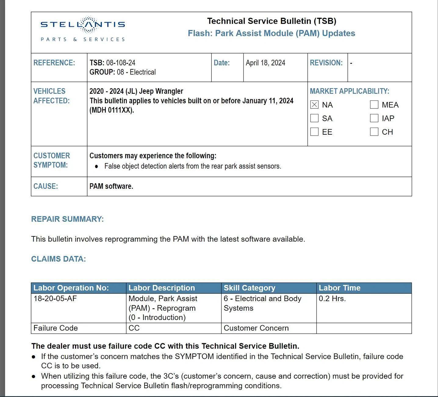

Back in June I started getting the "Parking Sensor not available. Wipe sensors" message. Since the Jeep is parked in the garage, I suppose it's possible dust covered the sensors. I wiped them off and it's fine for a short time. It will flash, turn off while driving (turning back on the sensors). After parking at my destination and getting back in to depart everything is fine for the entire trip back home. There may be an intermittent short somewhere, but I have no idea where to look. The sensors themselves seem fine.
Has anyone else had this issue? Were you able to resolve it?

alphawolff
Jul 31, 2023
3,657
6,287
california
2021 JLU
There's an update for this. Had to do it on my 24 392. The sensors still flake out sometimes but it's better than before. I suspect we'll get another update in the future to fully fix the issue
