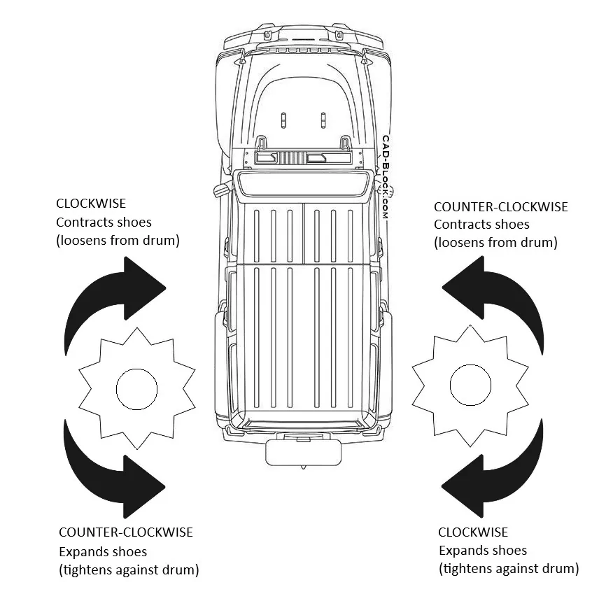

Been working on my parking brake recently, and after reading all of the posts of "just adjust the star wheel, I forget which direction is which, LOL", I figured I'd post this as a reference for anyone who's scratched their head after making an adjustment, wondering "did I go in the right direction?", or "do I need to go further, or reverse course?". Hopefully this proves helpful.
