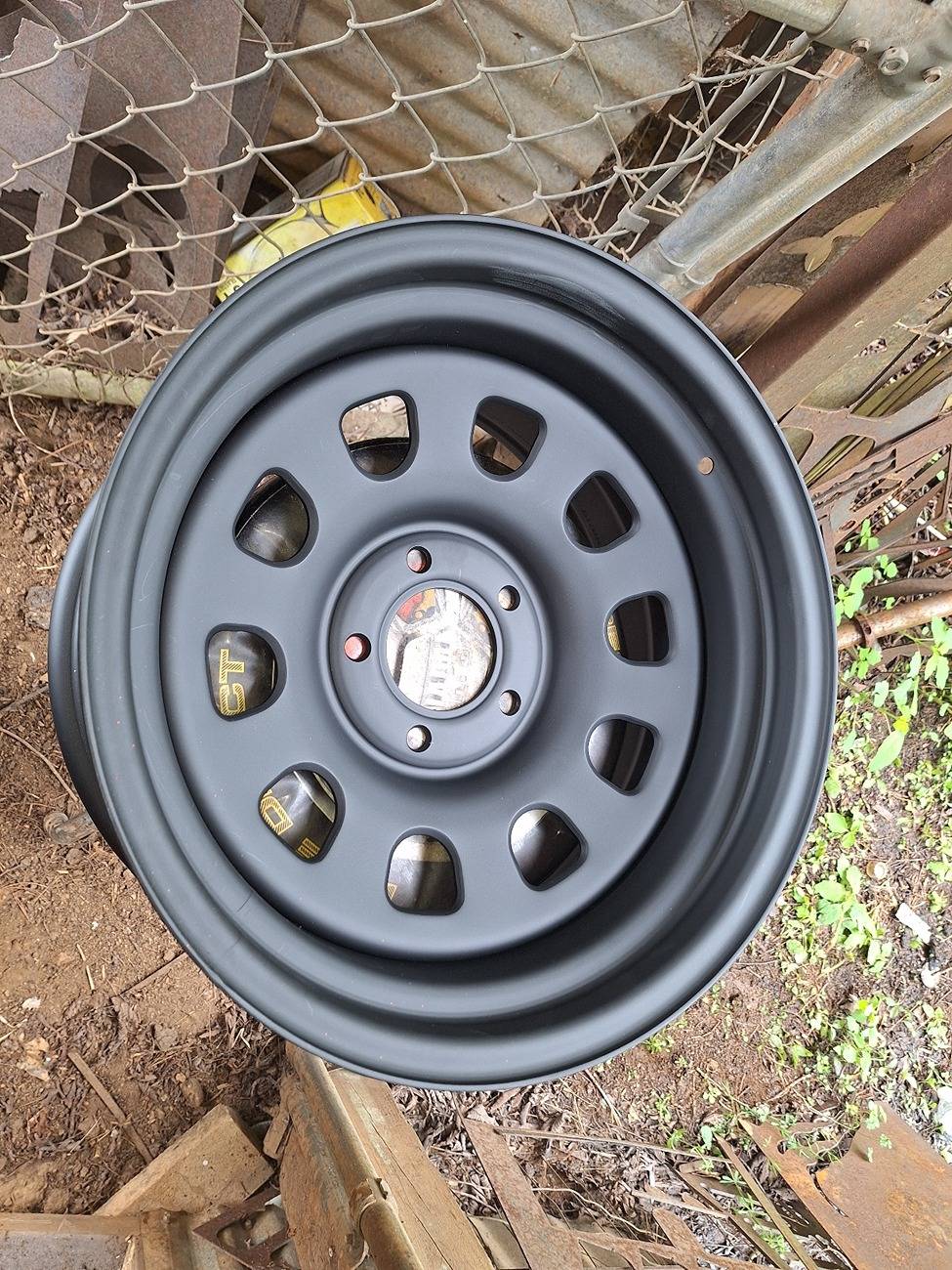

So I decided to paint my wheels to match my theme/jeep.
Started with $69 D steel wheels.
Sanded with 400 grit, Prepped with alcohol,....
Jeep Wrangler JL Painting my wheels 20250503_152915

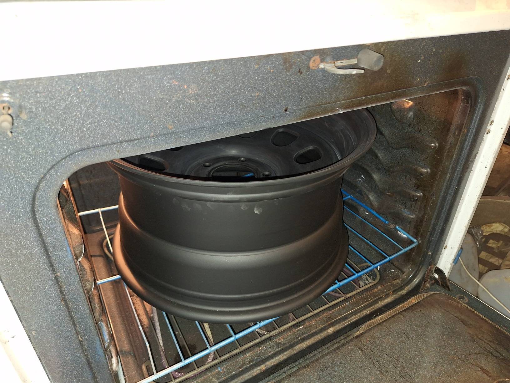

Into oven for 2 hours to out gas and get hot.
Jeep Wrangler JL Painting my wheels 20250503_154259
And then pai Ted and back into oven for 20 minutes.
Came out great, looks better in person.
Jeep Wrangler JL Painting my wheels 20250504_072004
Now to make 4 more match..

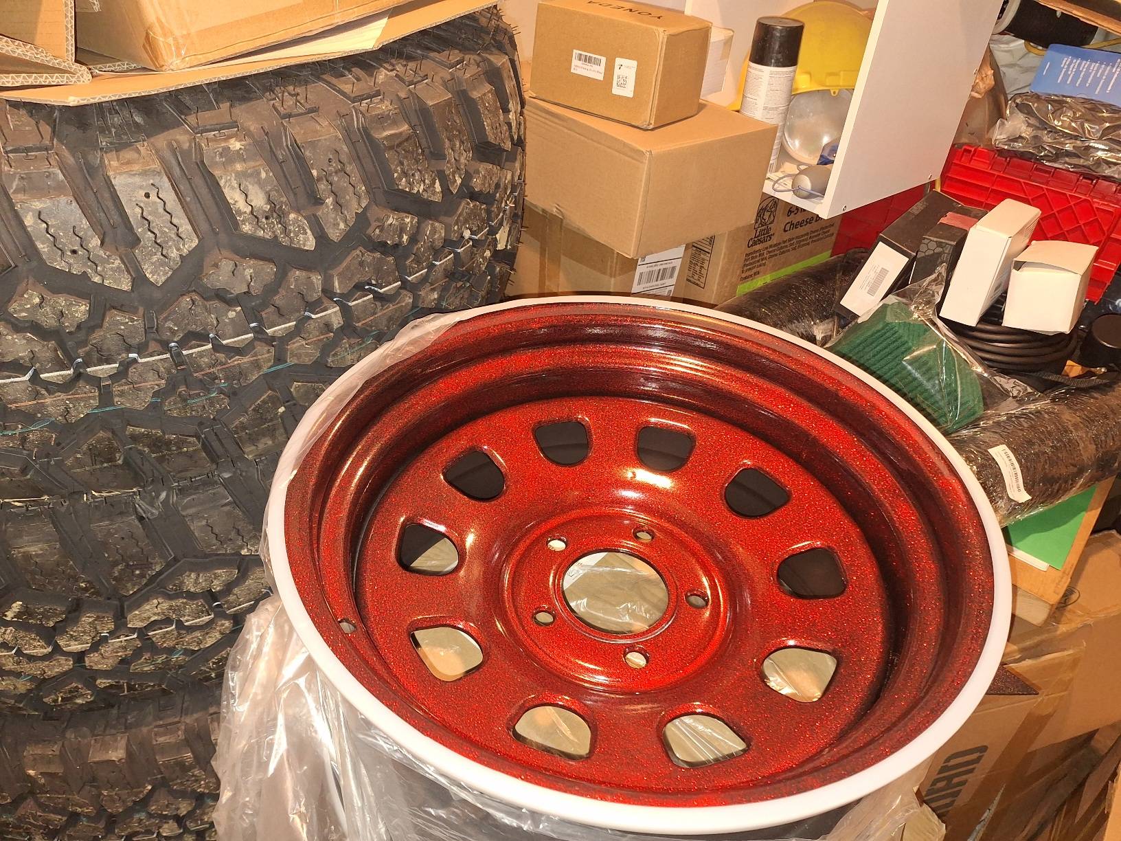

Oh, forgot to mention they are powder coated with Prizmatic "super red sparkle"
Jeep Wrangler JL Painting my wheels super-red-sparkle-ppb-4694-dt20200403153809189-thumbnail
And as with everything, more will be color matched ;)
I'm using an inexpensive dual voltage gun, and a couple compressors mounted together in an old goat shed...

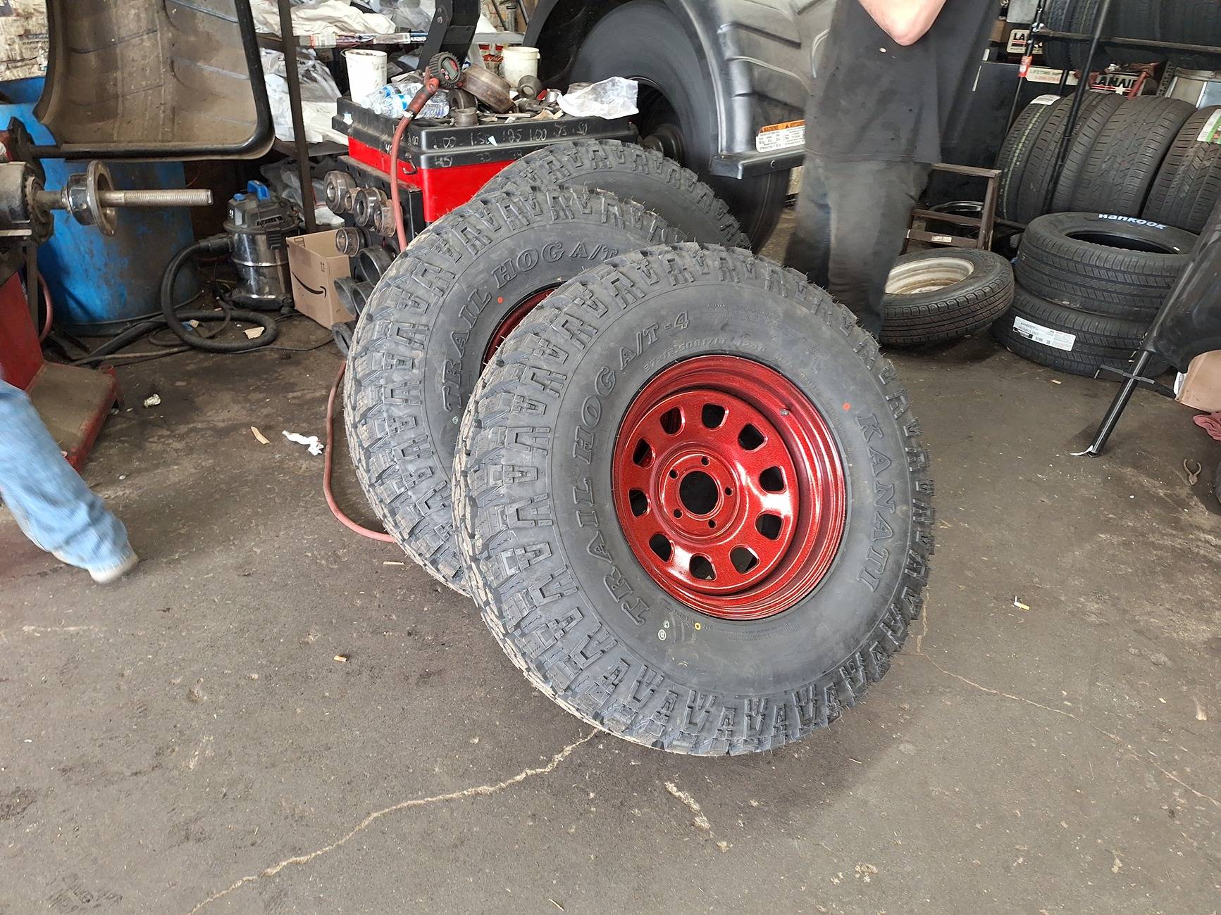

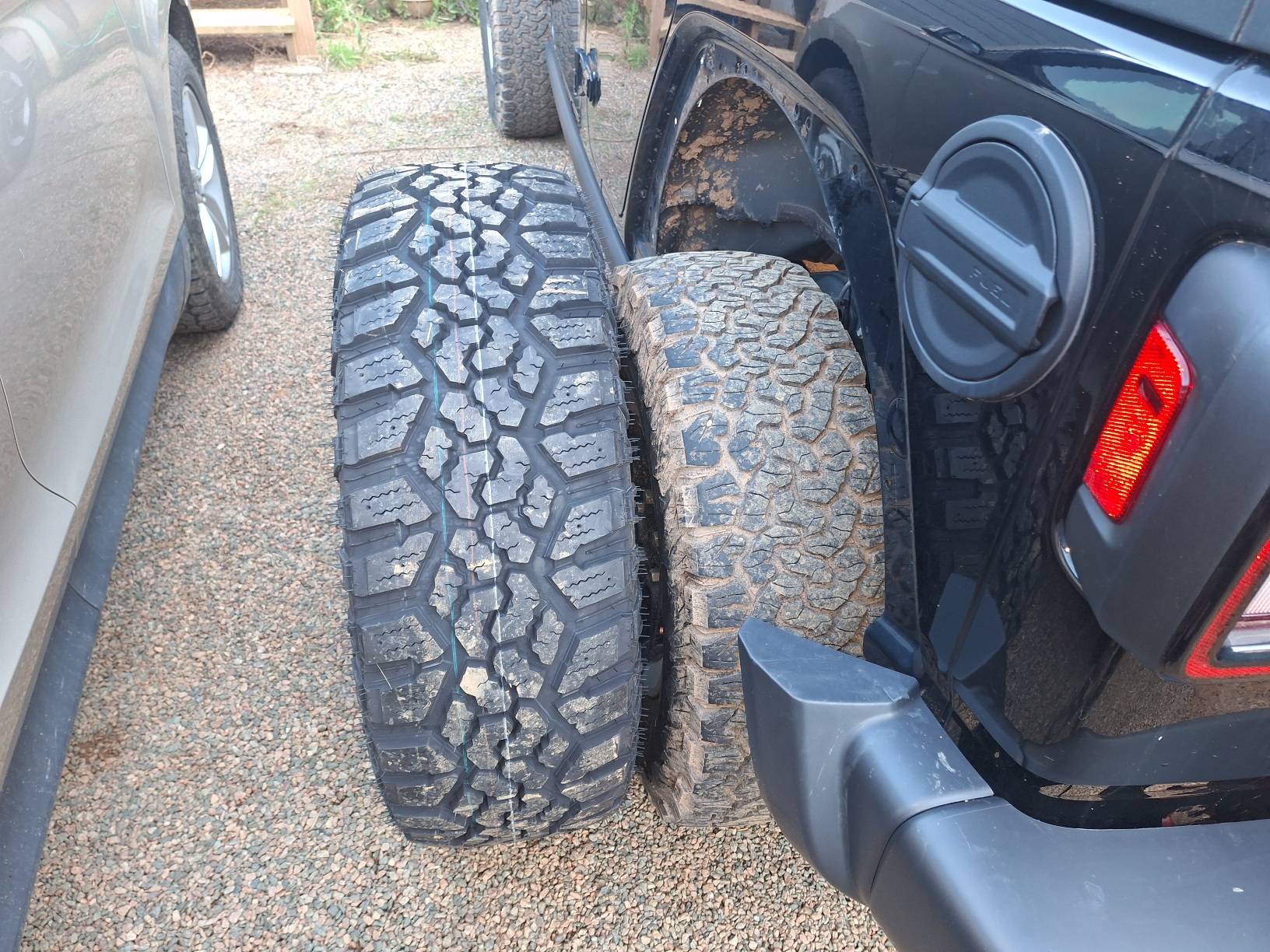

Got one in jeep with a tire, get mounted Friday when I run to town. Still have 4 to paint, lol, I'll have a cool picture 😂

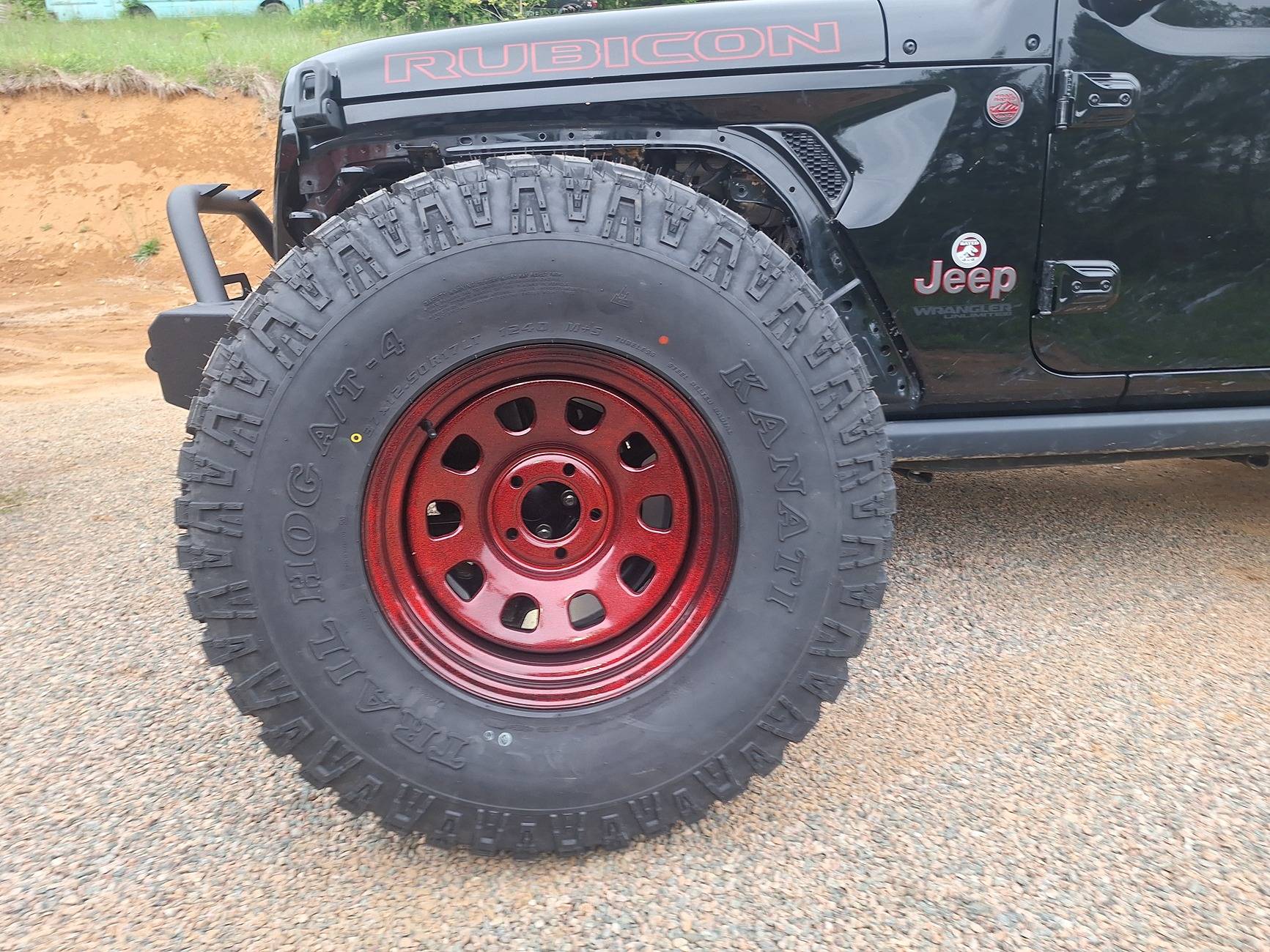

Well, I need to do 4 more, I just had to mount the spare.
Jeep Wrangler JL Painting my wheels 20250507_191150
It's overcast, and the sparkle moves, in full sun it pops, there is some flaws but it looks perfect at 3ft ;)

Looks better than I thought it would! Looking forward to seeing them all mounted. My wife would kill me if I used the oven to 'bake' Jeep wheels! Lol. What temperature was oven?
MntGoat
MntGoat
Doug
Apr 22, 2025
36
841
1,700
TN
2022 Rubicon
Machinist
400*
17 inch wheel is max, had to prop door closed.
Grab a brocken glasstop that has working oven, for free.
I have done mostly art and tractor parts art, I need to build a bigger over for the next few projects

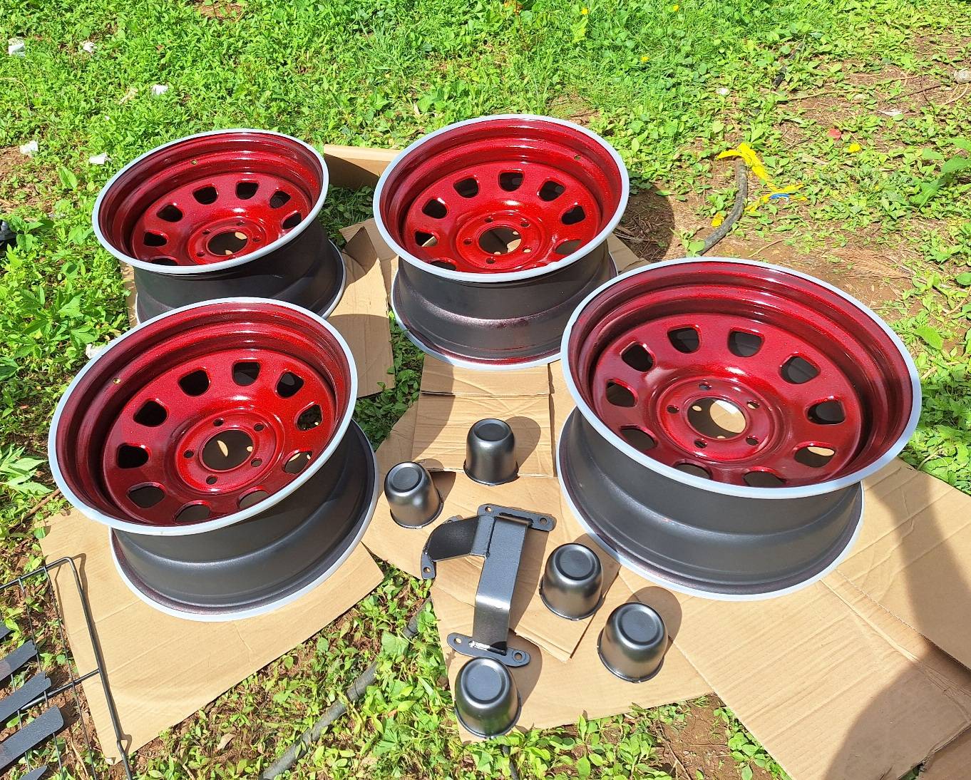

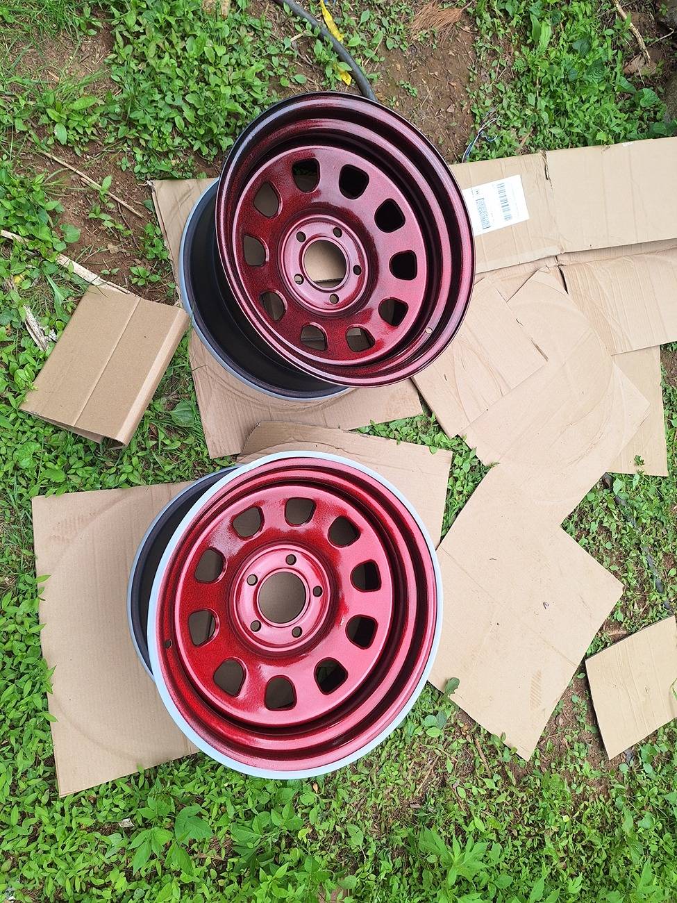

Finally got them done, Sunday night, took hours and hours to get them match colors it the storms.
Hope to get mounted on Friday
Jeep Wrangler JL Painting my wheels 20250511_131014
Notice color difference?
Jeep Wrangler JL Painting my wheels 20250511_162603
In storage room
Jeep Wrangler JL Painting my wheels 20250511_183008
MntGoat
MntGoat
Doug
Apr 22, 2025
36
841
1,700
TN
2022 Rubicon
Machinist
Okay, done. They look great from 5ft away, had a major storm come thru last weekend while I was powder coating these in the back yard.
Good enough for offroad pimpalogy 😁
