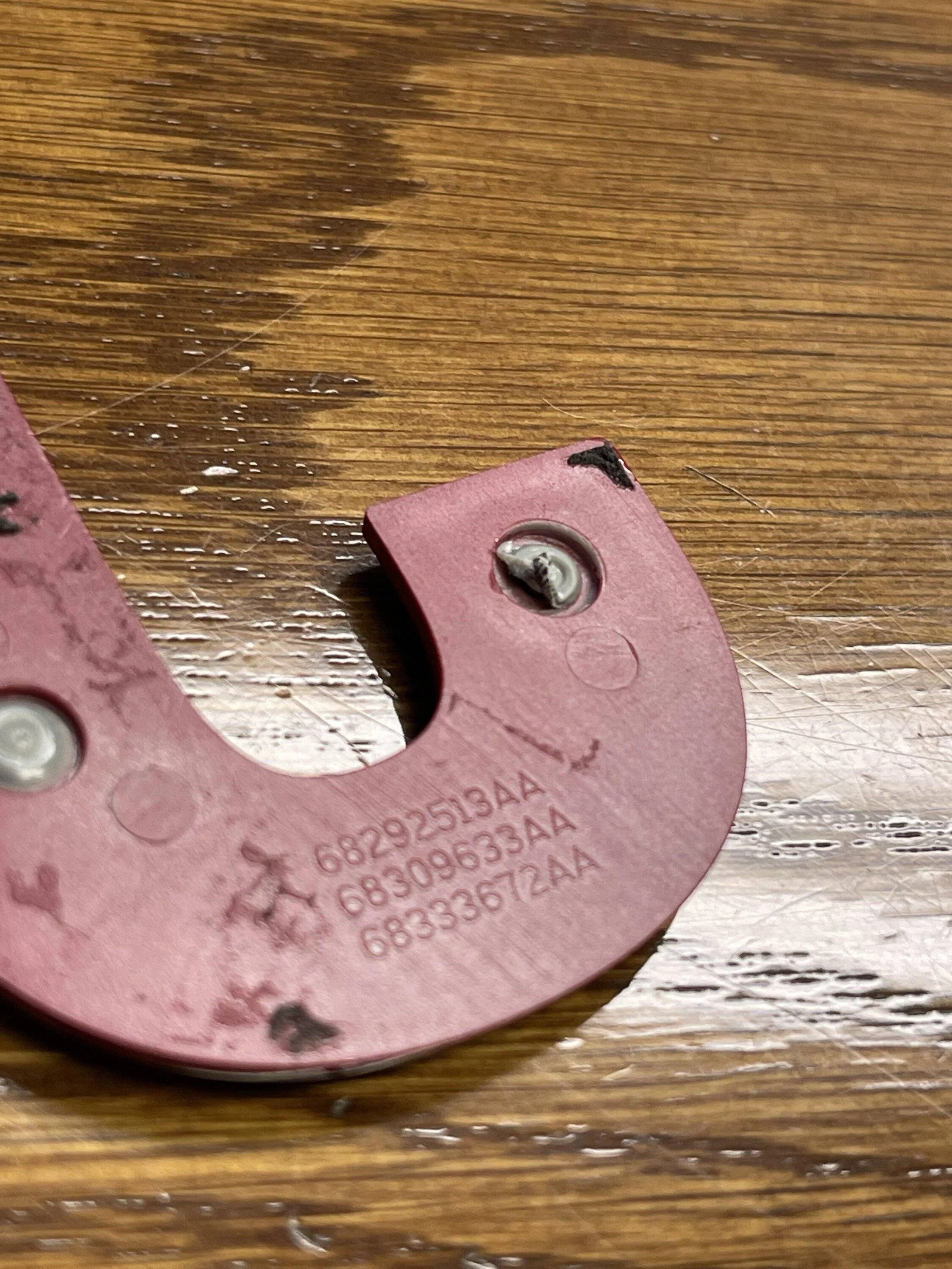

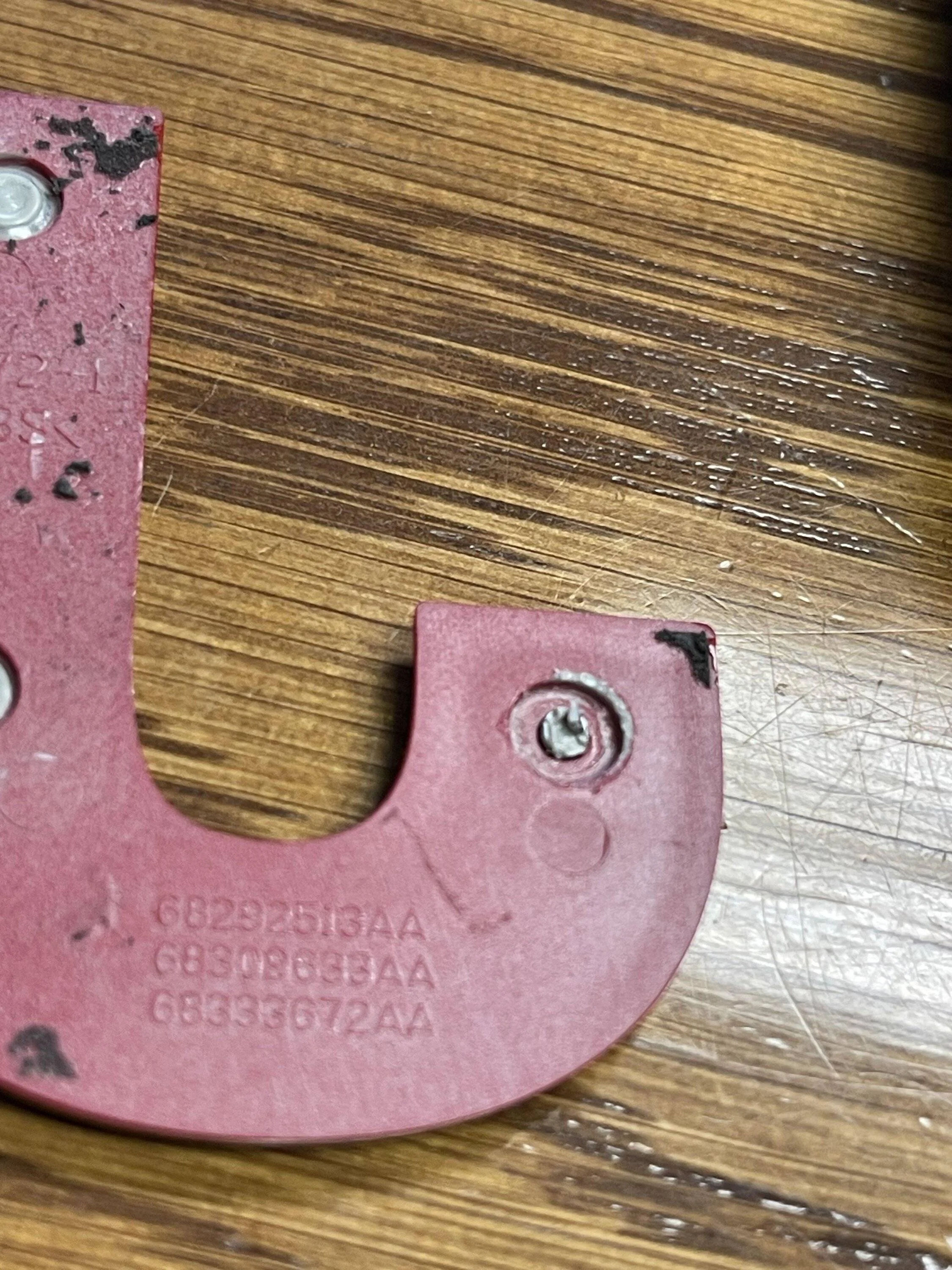

Once the letters were off it was simple to see how they are held together and get them apart. Each letter has 3 pins that are just melted to form a kind of rivet to keep the 2 halves together. A pocket screw driver and knife made short work of the plastic.
Jeep Wrangler JL Painted Jeep Emblems Letter Back
Jeep Wrangler JL Painted Jeep Emblems pin removal
Jeep Wrangler JL Painted Jeep Emblems pin removal 2
Jeep Wrangler JL Painted Jeep Emblems tools of the job
Jeep Wrangler JL Painted Jeep Emblems All separate

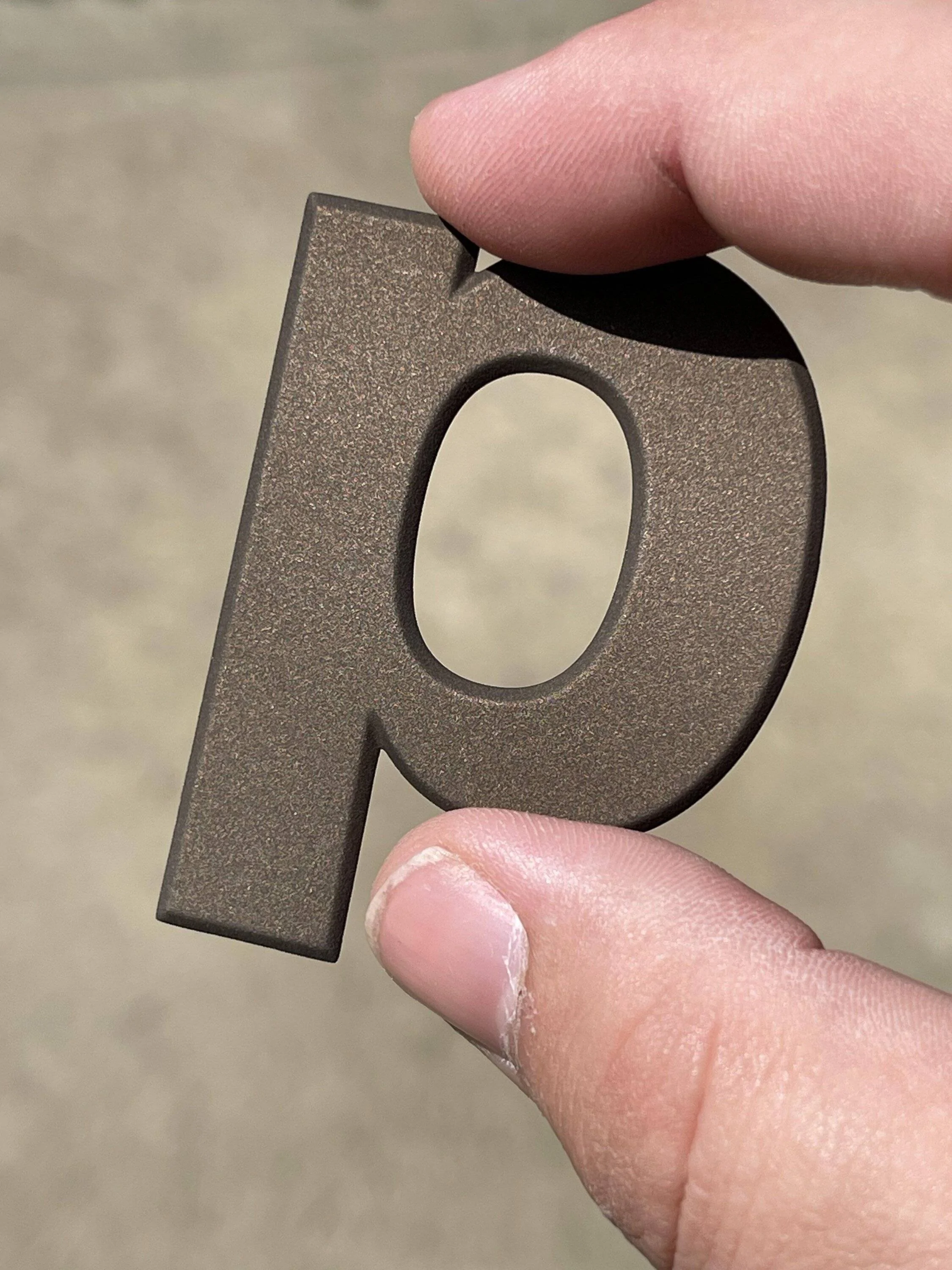

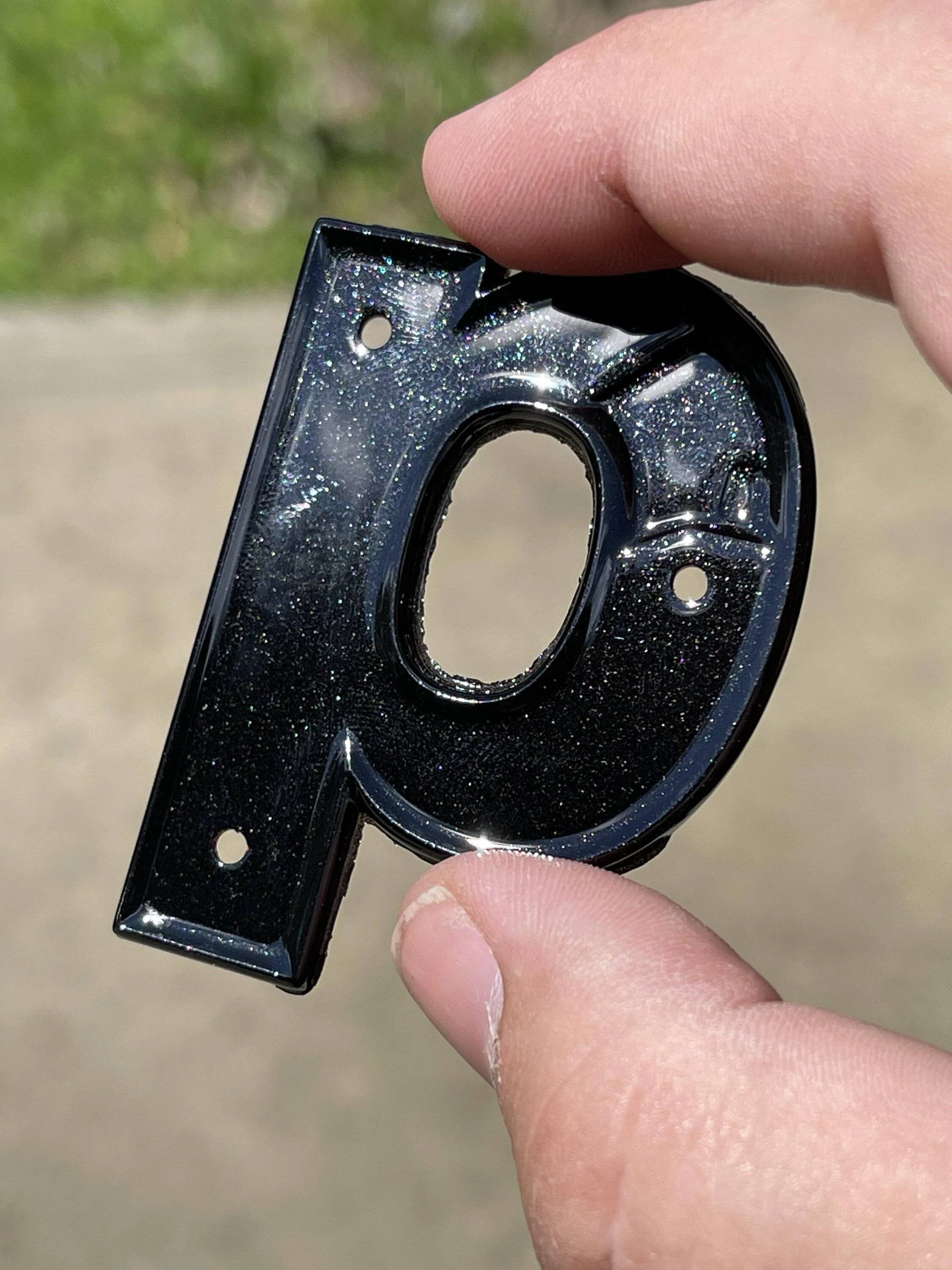

At this point I took some red scotch brite pads to the red part and grey to the silver to let the paint stick better and handed them off to the painter. He got them setup in the booth, and this is what I would change. The red we went with a custom gloss black with a ton of flake and pearl to give it a shine, and the same bronze as my sliders you can find here but with a matte clear over them. I would have set the red up on rivets or pins or something to keep the clear from pooling on the tape but it was easy enough to clean up later and hardly noticeable once on the Jeep.

You can really see how much flake is in the black here in the test fit.
Jeep Wrangler JL Painted Jeep Emblems Black
Jeep Wrangler JL Painted Jeep Emblems bronz
Jeep Wrangler JL Painted Jeep Emblems Test fit

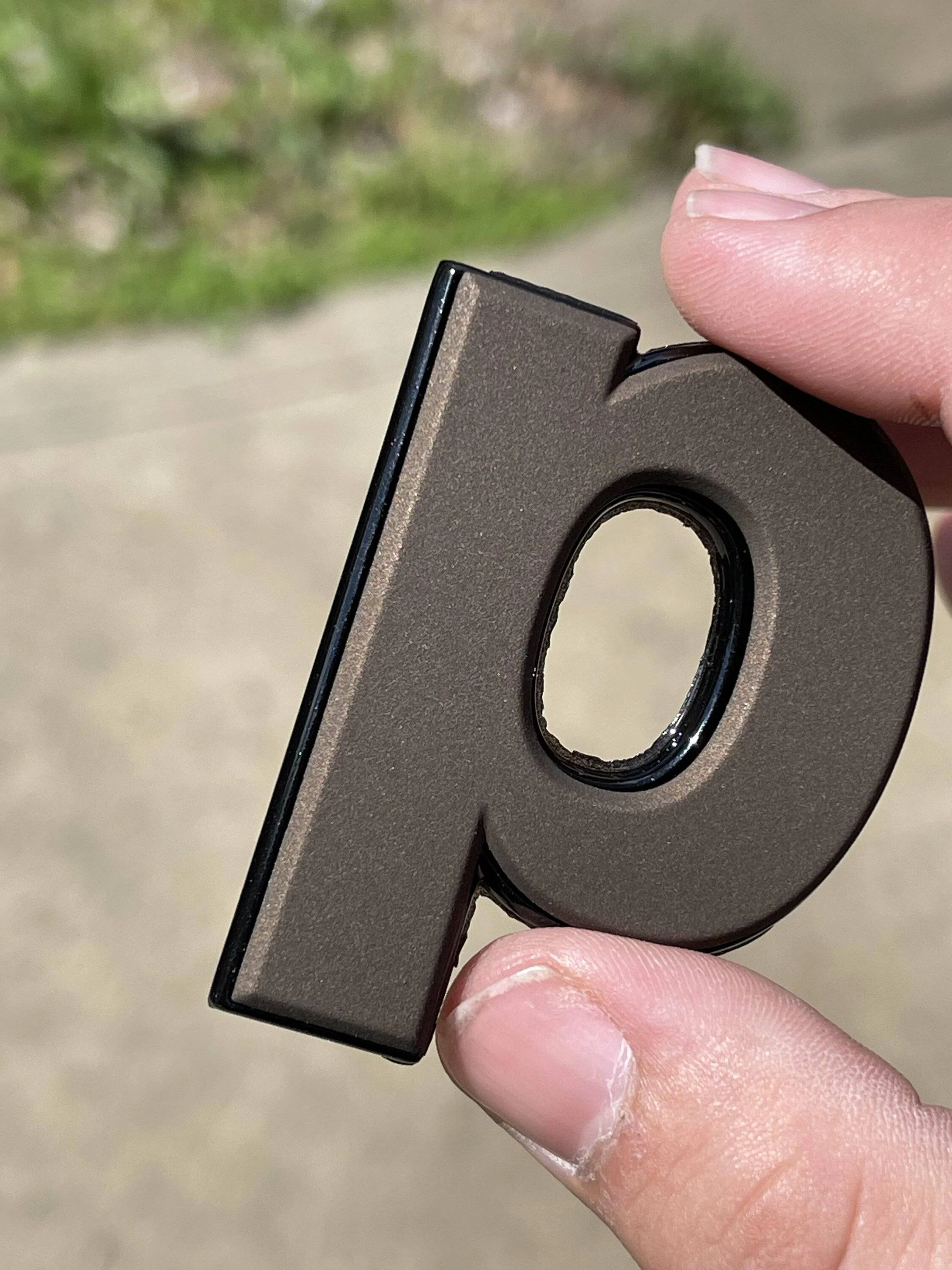

Once the paint had a day to set up I spend an hour or so gluing them back together. I got one that you can brush on and brushed the face of black and then put drops on the pins on the back once they were stuck back together. Overall not a bad process.
Jeep Wrangler JL Painted Jeep Emblems setu
Jeep Wrangler JL Painted Jeep Emblems Glued
Jeep Wrangler JL Painted Jeep Emblems back together

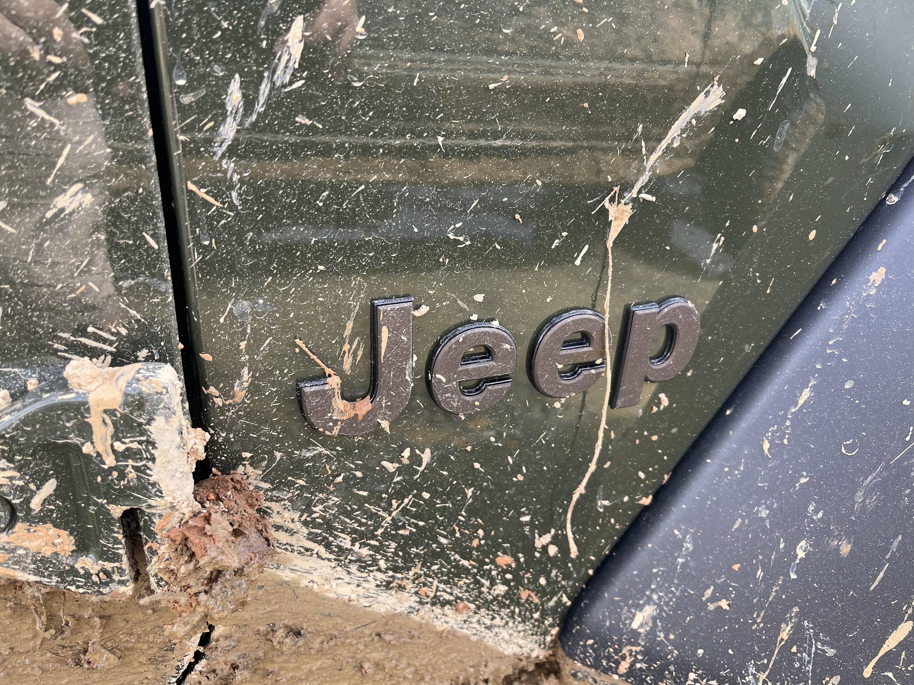

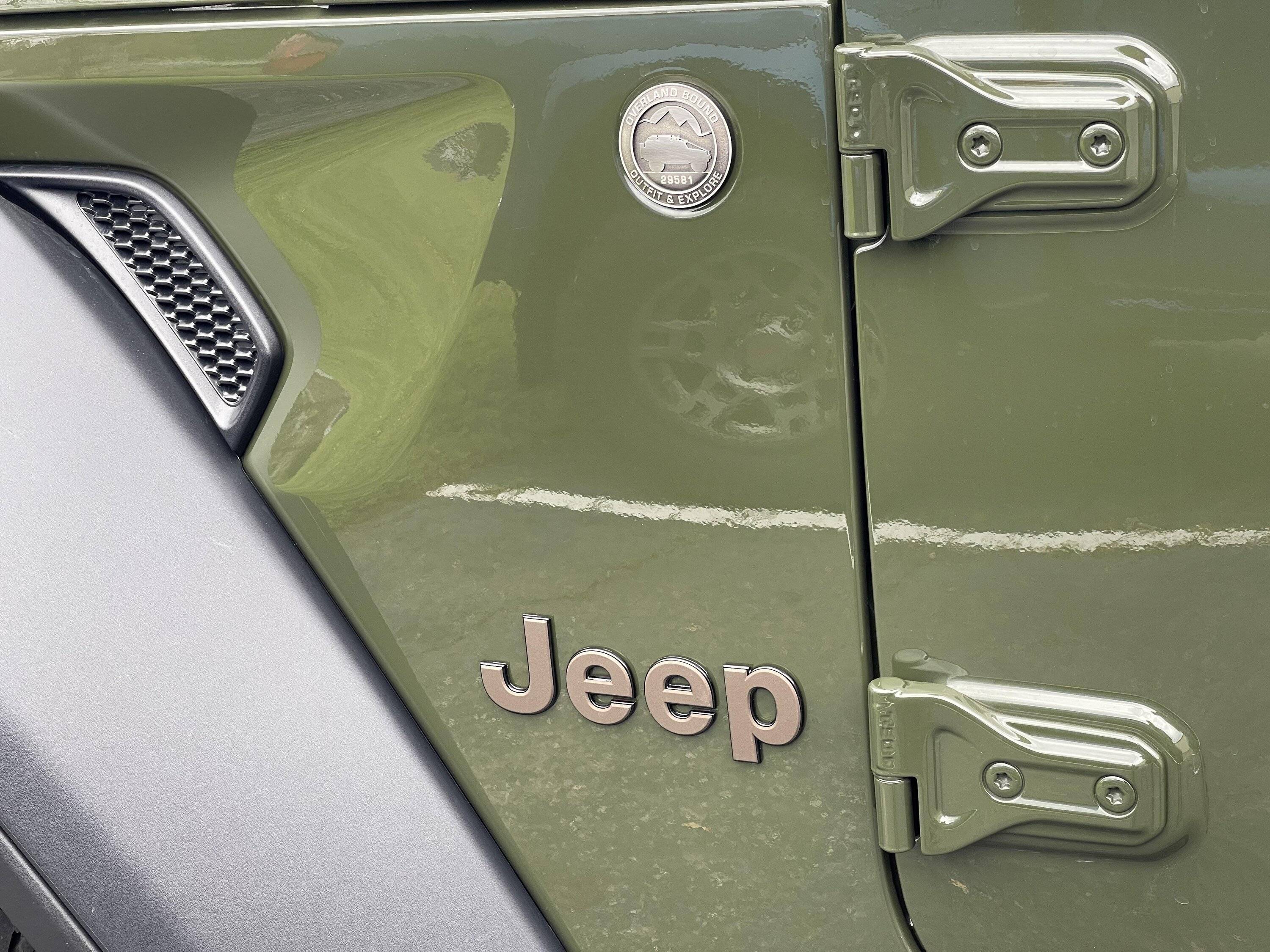

And all done, they also held up well out for a day of muddy wheeling this weekend. Super happy with how they came out and looking for other things to paint in the bronze now lol.
Jeep Wrangler JL Painted Jeep Emblems DONE
Jeep Wrangler JL Painted Jeep Emblems Survived

At first I was just going to order the factory 392 stuff since its all bronze. Then I spent some time in our paint chip cabinet and found that Volvo bronze color and it matched very well. And with that any time I need something I can have it mixed to the same colors, and hoping when I get wheels I can get a powdercoat to match as well. Right before I started this project I also found my old Overland Bound medallion and it fits perfect in the trail rated badge location so I didnt need to get the 392 version of that either. All worked out well.
