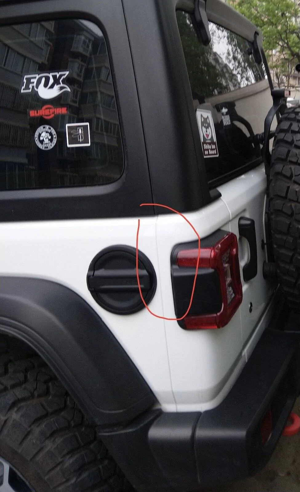

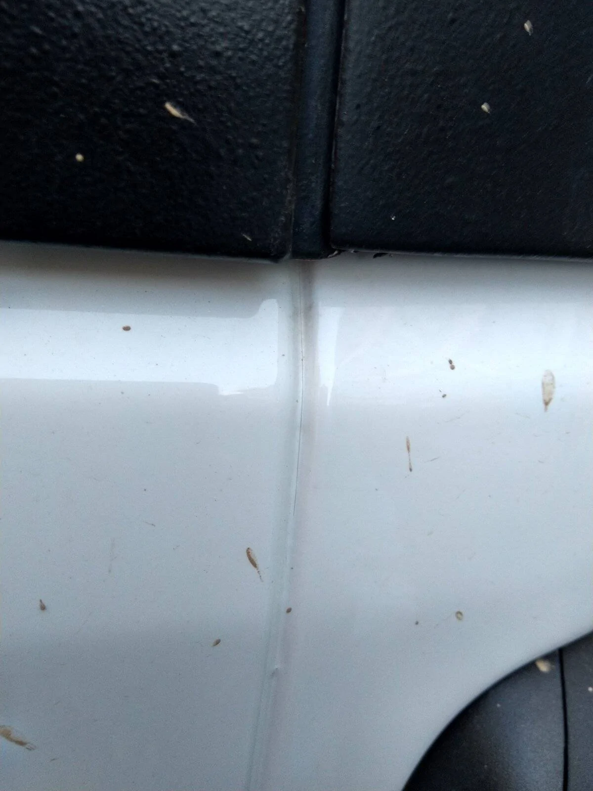

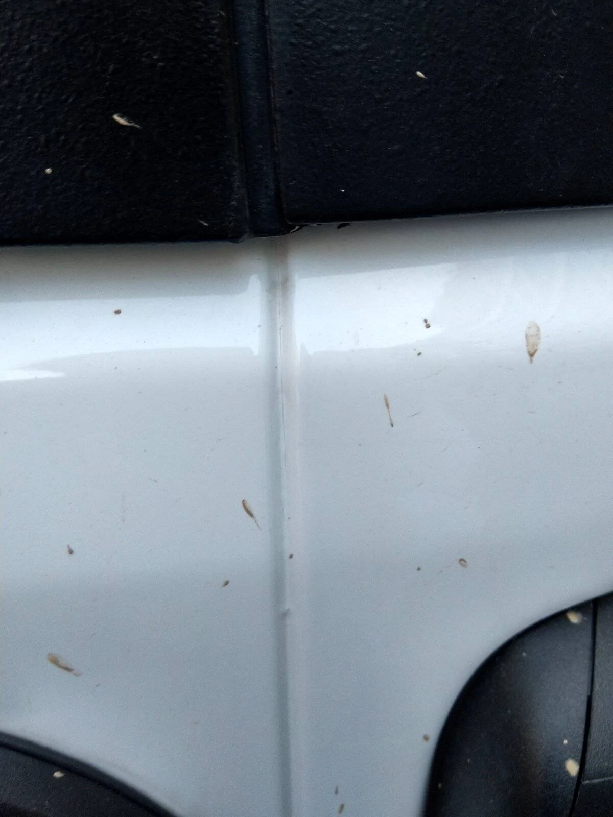

Hi group,
I noticed that my 2019 white JL rubicon paint crack between rear tail light and fuel door. Should I worry about it or it’s normal.
I have 2 friends with white paint JL wrangler (1 Sahara 1 Rubicon )with same issue right now.
Thank you.

Put some touch up paint on it if it makes you feel better. It's pretty much expected that the paint will crack at body seams. They painted the pieces together, which was dumb.

There's a flexible body sealant in that seam, hairline cracks can be remedied by using a clear flexible sealant such as Marine Grade Goop that is UV resistant

Thank you. Just bought the white 3M marine sealant, cover the cranks. not perfect but definitely feels better.
