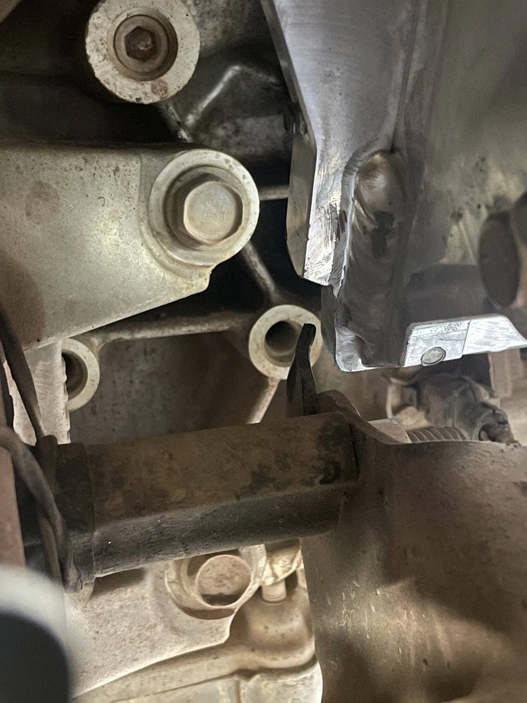

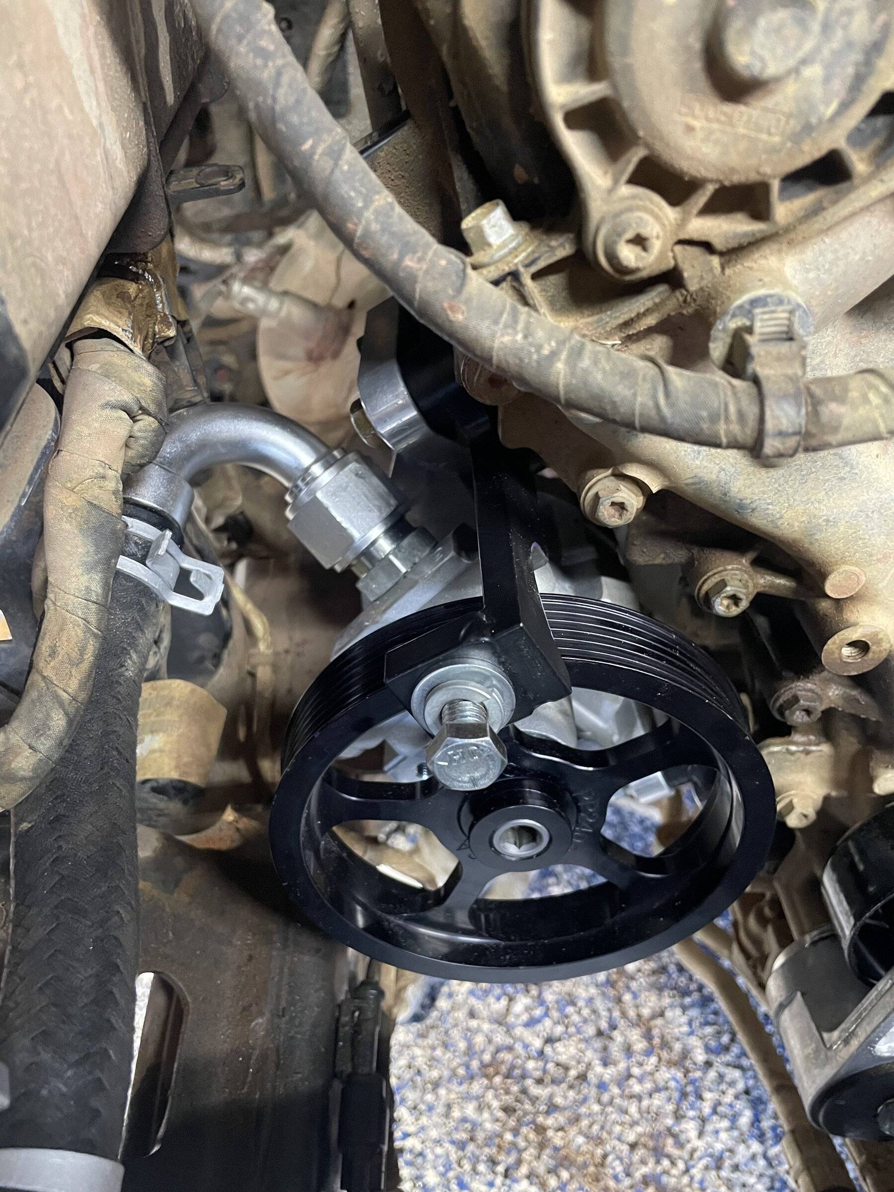

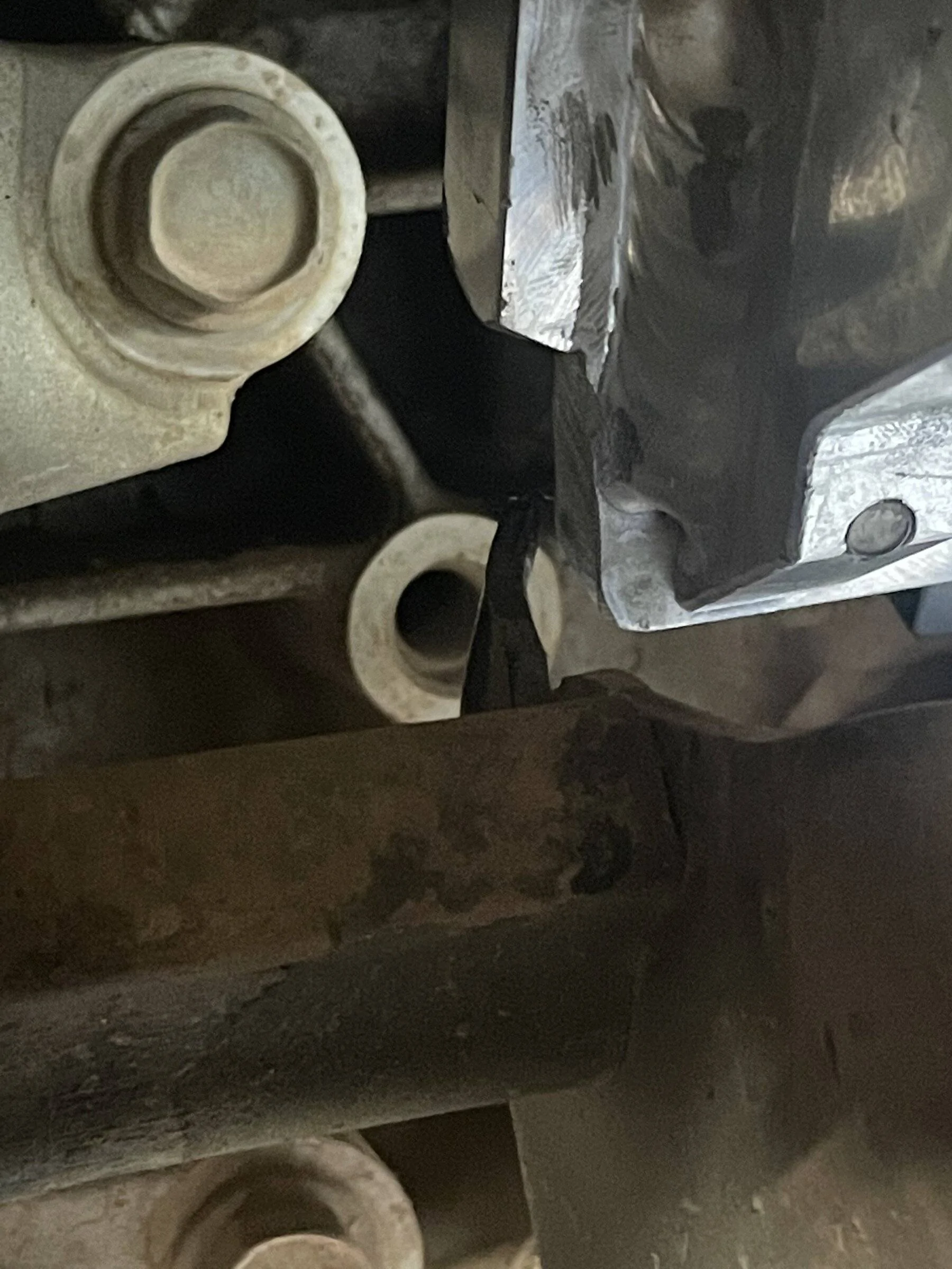

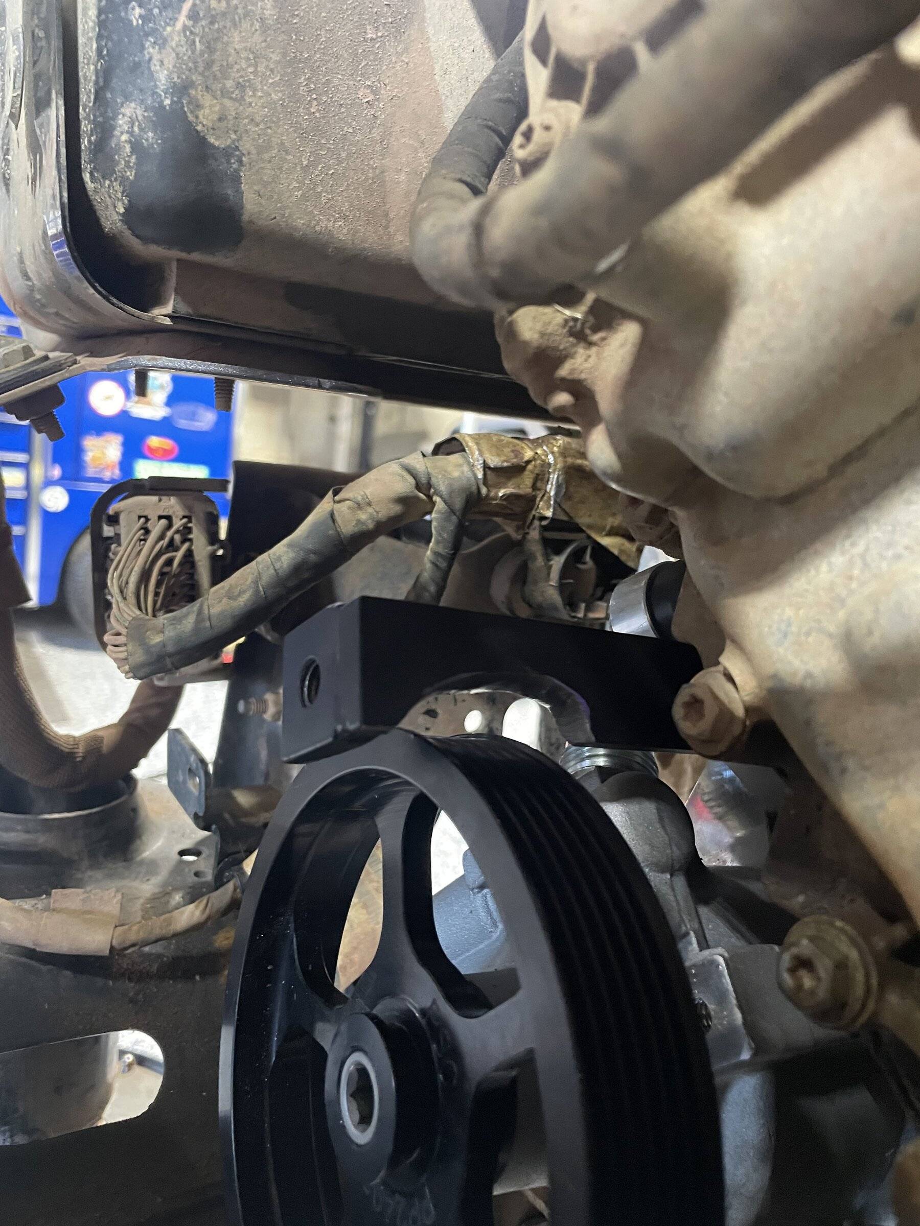

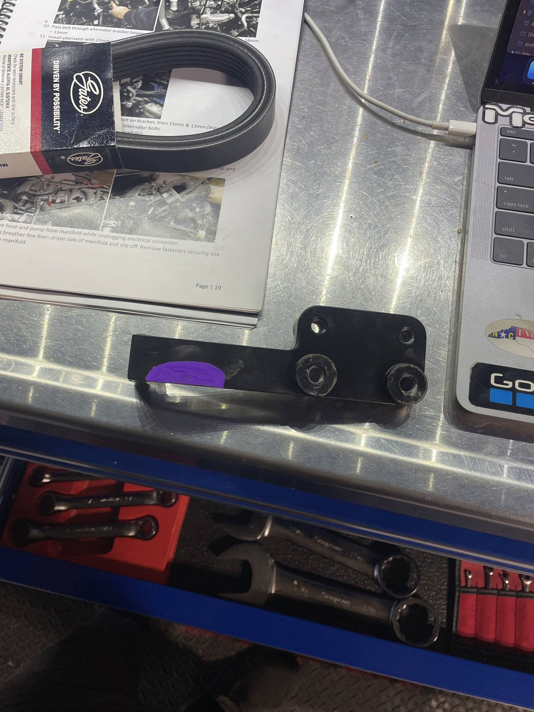

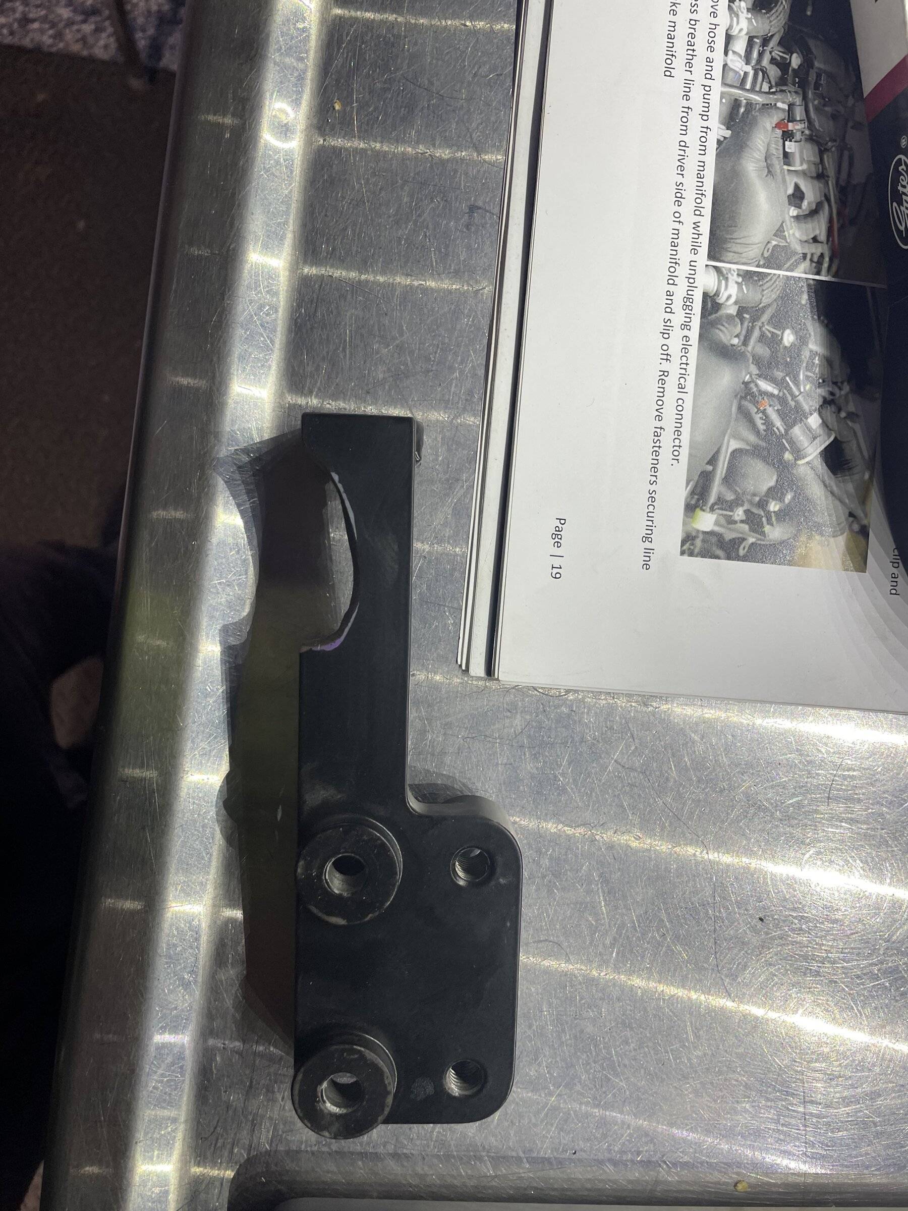

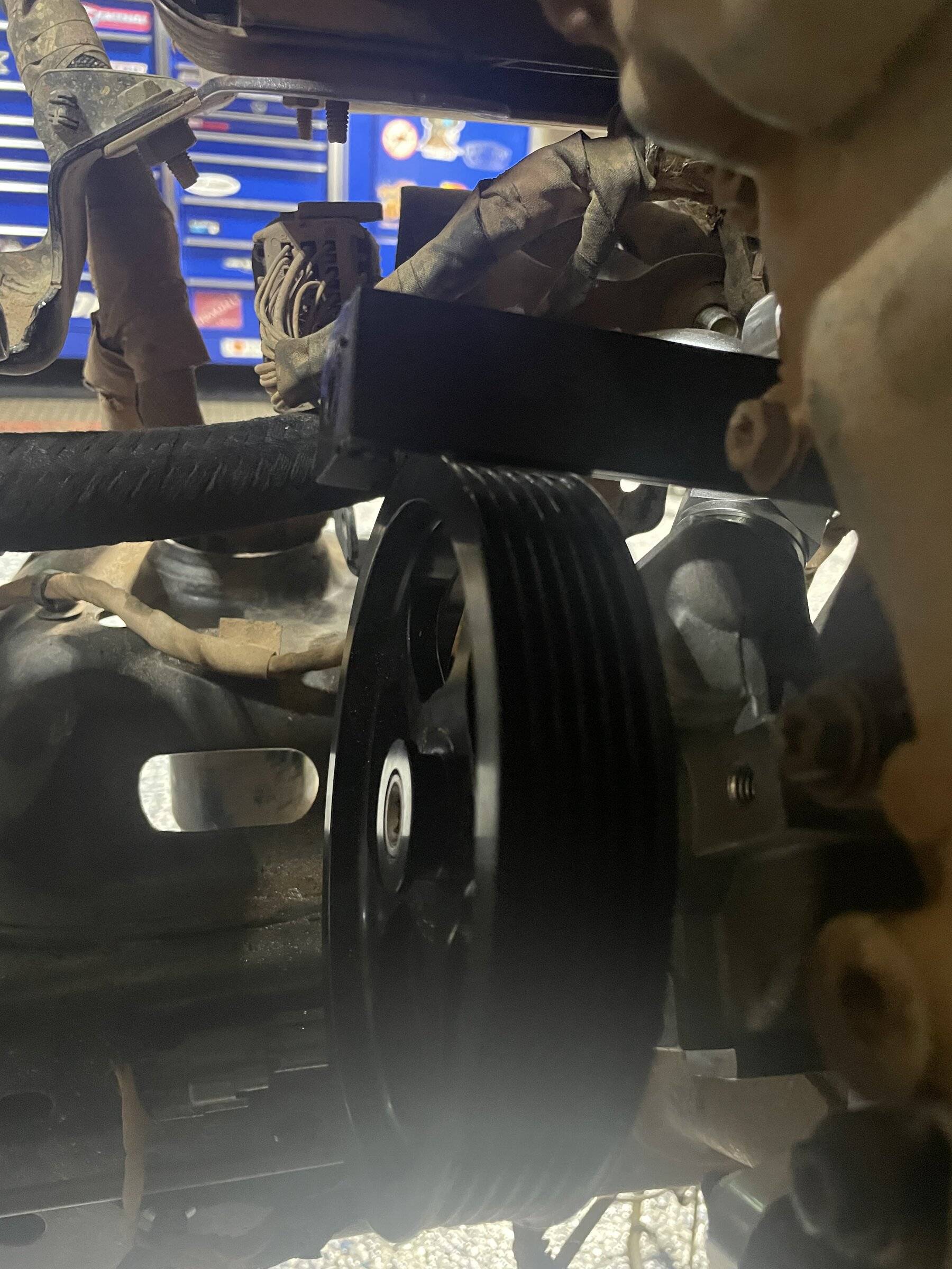

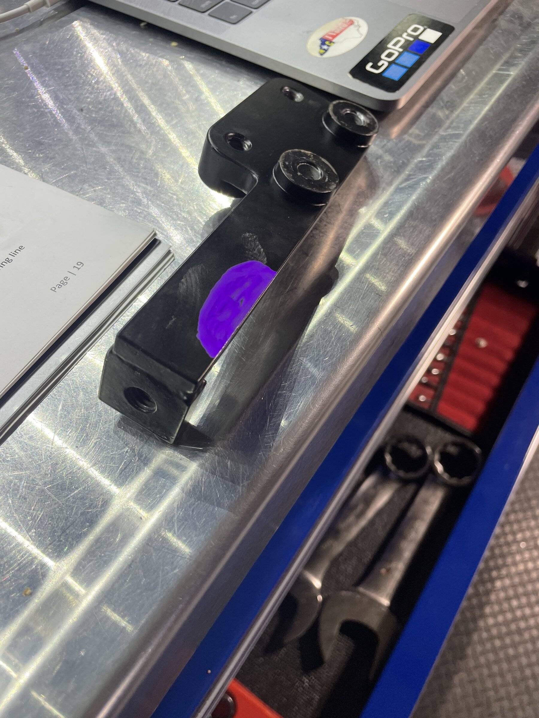

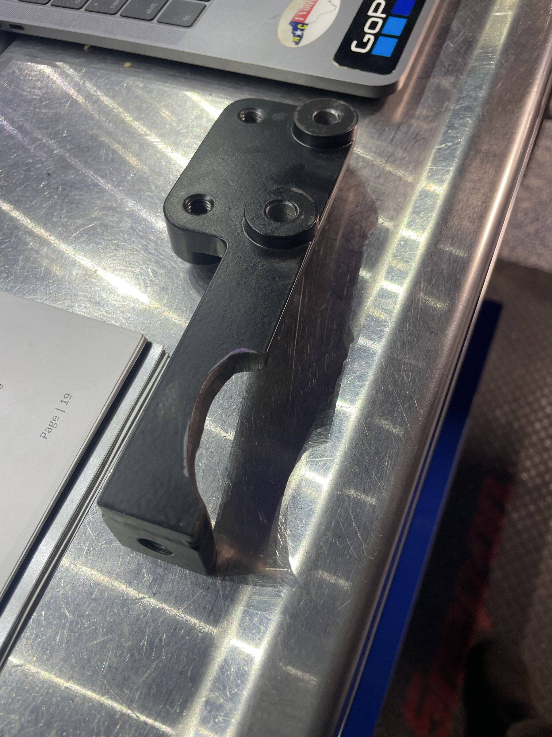

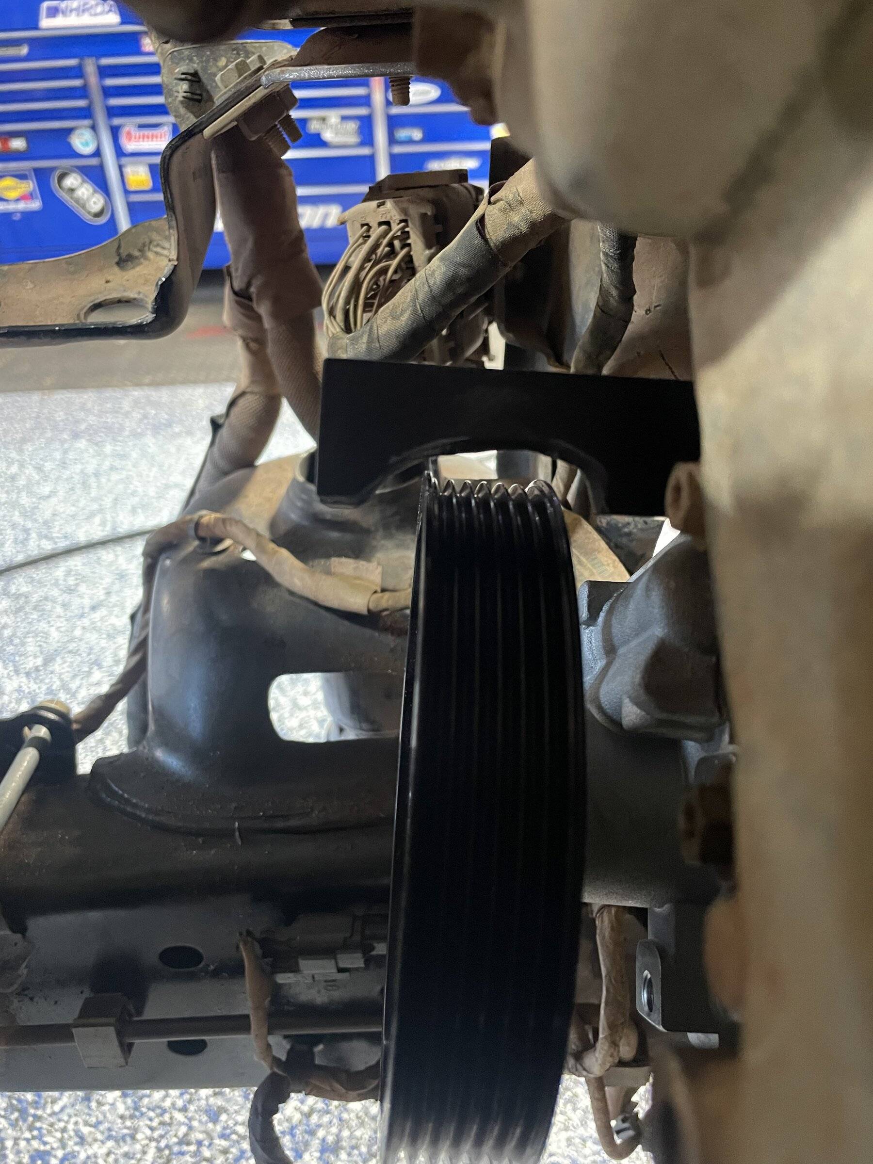

There were a couple issues but nothing that couldn’t be overcome.
I had to trim the PSC Pump bracket to clear the motor mount since the RIPP Blower mount bracket pushed it out a little bit.
Also, I needed to notch RIPP’s Blower bracket in order to fit the belt on the PSC Pump pulley. Outside of that, no issues.
