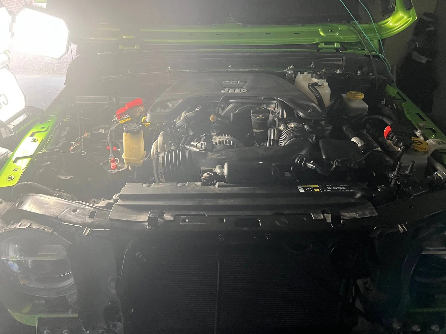

I had the same thing happen last year on my 2018 3.6 with 34,453 miles. Way out of warranty. I elected to find a new engine. I found a new engine from a 2024 JT with 160 miles. That got me a larger alternator and some spares like starter, ac compressor, hoses, and accessories. Now have a good parts collection for problems.
Currently helping to replace a member's engine that puked a cylinder and flattened a cam, at 110k. Since it had a lot of miles, we're going with a new engine as well. There's a lot of people that have had these issues.

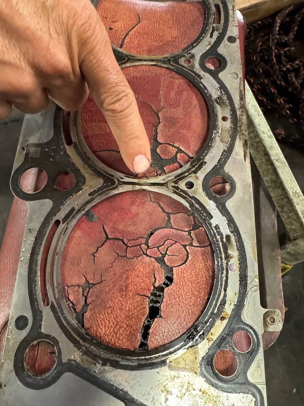

To me, the machined slot between the cylinders looks like it wasn't part of the original design, but rather a fix to an issue. Otherwise there would be more surface area there.
