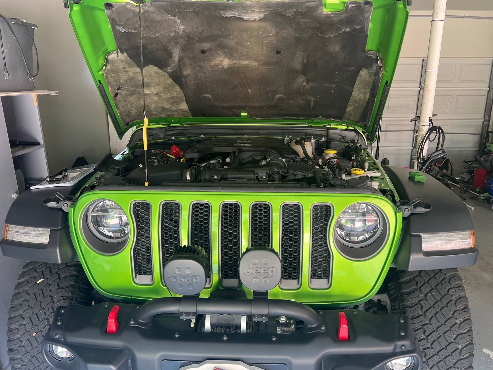

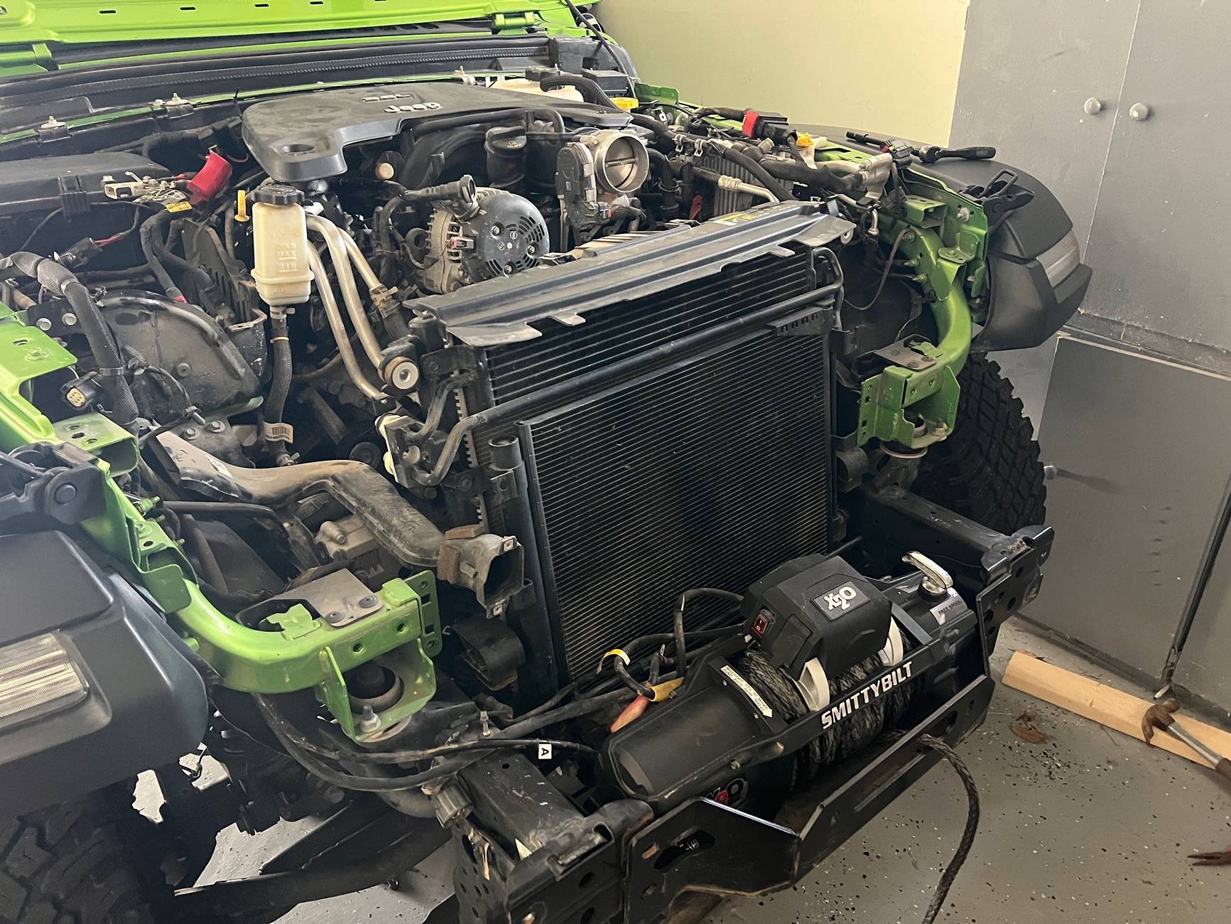

Put a couple of hours in today. Just undressed the clunker.
Removed bumper/skid plate/winch.
Removed grill. Headlights. Radiator support bracket deal.
I’ll list parts and tools I need as I go.
I would never attempted this without this gem of a vid
Still super annoyed an engine with only 28k on it popped but no biggie. I’ll get it done.

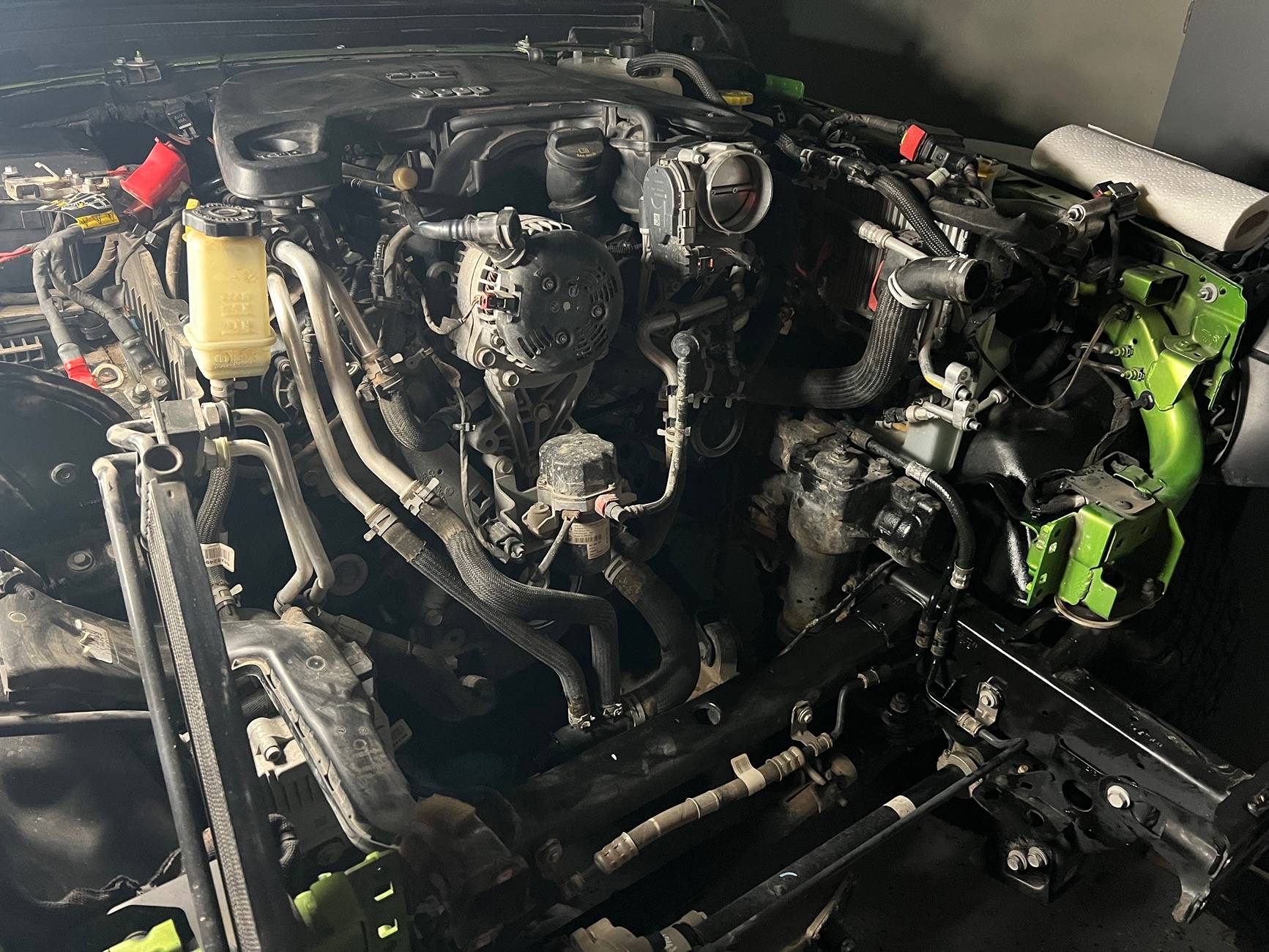

minimal progress over the long weekend.
plenum is off. pain in the butt
power steering leak found. i hate leaks
almost cleared enough crap to start opening up the engine.

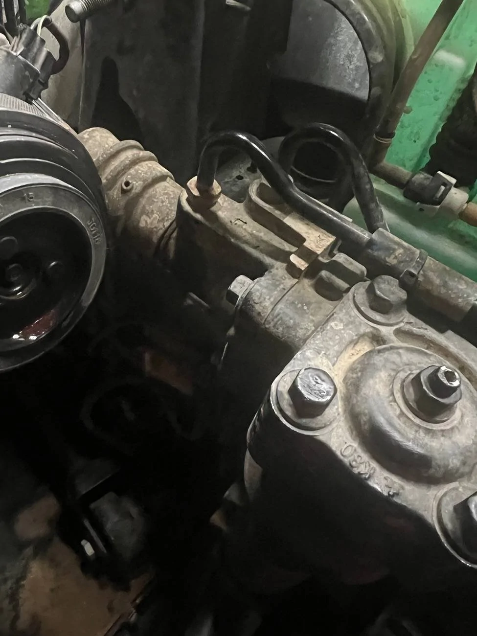

I need the parts guru on the board. Power steering is leaking from one of these lines. Just need to prob pop in a new o ring. I can’t find a parts diagram for it. Pic of the lines.
